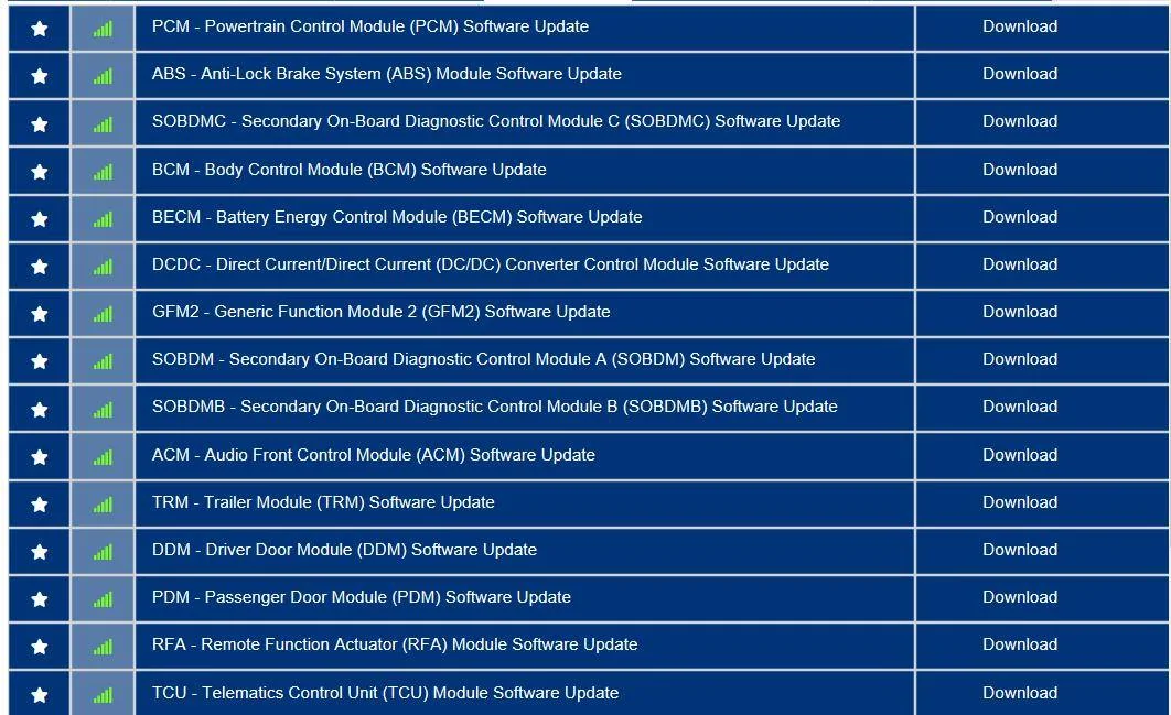

Finally got around to checking for updates with FDRS. It showed a boatload but I got the letter about the 24B56 CSP. The IPMA and PSCM updates were not showing. I did the GWM, APIM, TCU memory stick updates, then finished the list. BCM is still locked, PDM that has been stuck in display for months finally updated and cleared from the list. Have not checked today, temp in garage over 100 degrees. Seems our fall / winter / spring only lasted a week in PHX. ?

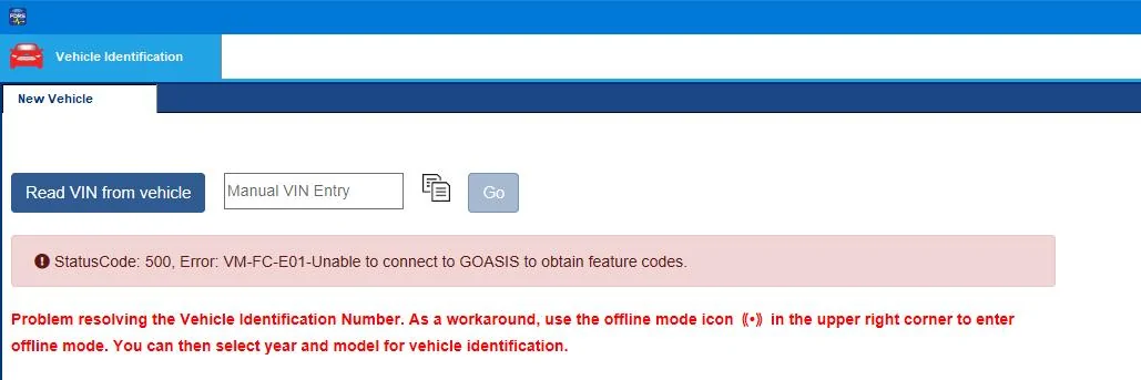

You may run into issues this morning if you plan on doing any updating.
Ford F-150 Lightning Lightning Software Updates using FDRS FDRS_28-Sep-24
This is also affecting some functionality on PTS.
I'll check it later and advise if I see it come back up.
Mike G
Mike G
Jan 6, 2022
1,922
2,846
N. AL, USA
It's back up.
sstevetx
Steve
Sep 3, 2023
283
493
I checked and I still only have the ACM and RFA even after several refreshes.
