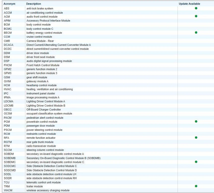

Could someone check to see if there are any updates available for my truck? I haven't gotten any OTA updates for many months and I'm considering getting a 2 day FDRS license to see what can be installed manually.

Gladly, but please remove your VIN from your post.
List of modules with pending updates:

VIN removed. Thanks. So several larger updates. I wish we had an easy way to clear any errors from our OTA queue and have it retry.
Thanks for checking!

Is that picture of the updates the new look of the FDRS software version?
No, that is with PTS, but the list with FDRS would be the same or close enough to use as a guide. I don't have access to FDRS while at work, so I use this instead. PTS is much easier and faster to pull this info from compared to FDRS.

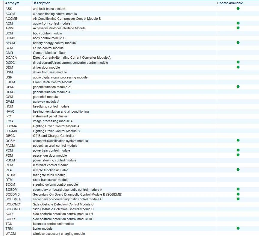

If possible, could someone check to see if there are any updates on my truck. Last update I got was on September 13, and that was the dealership doing a reversal. Much appreciated!

Sure, but please remove your VIN. Not much pending. The dealer seems to have done some updates on 9/27. Not sure what you mean by a reversal, but the OTA you got on 9/13 was 6.8.0 for the IPC and had nothing to do with anything the dealer did. You haven't gotten any updates because there is little to update on your truck. It is almost completely up to date.

Looking at what @rugedraw posted, I'll note that the ABS, BECM, PCM, and SOBxx will be updated if you have your dealer perform CSP 23B50 (Charge Cord Stuck).

I just called my local dealership, they said the only thing outstanding was the front hatch recall, they don’t see anything for CSP 23B50. Can you give me anything I can show them?
Your truck may not need it. Message me the VIN and I'll check. I didn't look for that when I checked it.

See this post and the attachments. Says it includes 2023 with build dates 1/10/22 - 2/1/23 (in reality that includes mostly 2022 like mine). Yours was probably built later I'm guessing. So good news!
