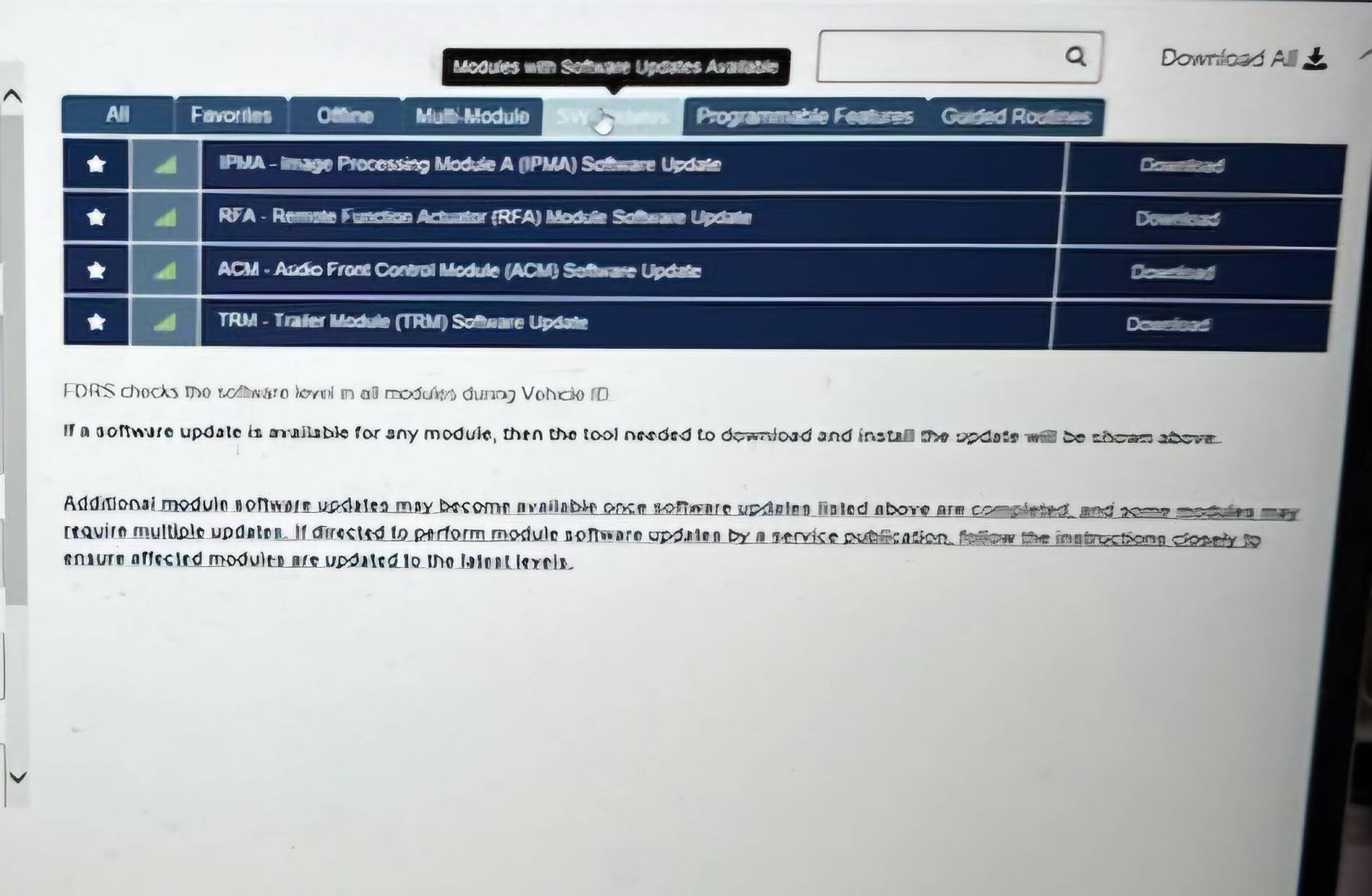

My Mongoose came in the mail today the Clore should be here Wednesday. Plan to get a 2 day FDRS license this weekend.
After a day at the dealership for a new 12V battery I am down to 4 modules with updates:
IPMA
RFA
ACM
TRM
Then I need to do the 360 camera fix the other dealership missed when they did 24B56, the Front sensor CSP.
Lastly a few things in FORScan.

Looks like you did pretty good. They updated everything major aside from the new IPMA update that came out yesterday. Note the RFA and ACM won't disappear after updating. This is an ongoing issue.

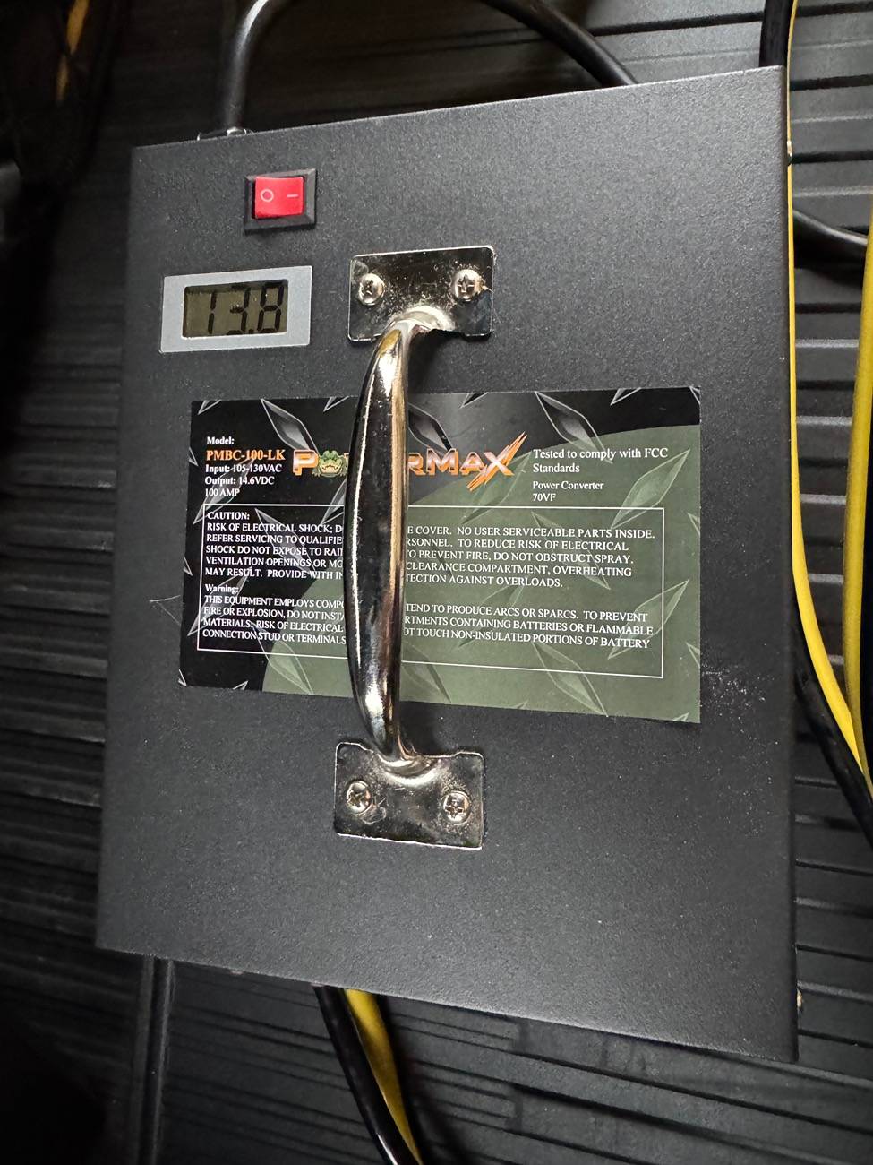

I use this:
Powermax 100AMP
I'm using the 75amp version. Looks like it went up about $20 since I bought one two months ago but still a good option for ~$300. Amazon.com: PowerMax PMBC-75 75 Amp 12V Battery Charger with Clamps : Electronics
The Clore PL6100 seems to be the standard but do note you'll need a 20 amp outlet or an adapter for a regular 15 amp house outlet. Some have used cheaper rv power supplies with no issues. No experience with those, but any that have a power supply mode capable of 75amps+ should work and not cause any puckering.

Other than the clips, is there a major difference between that one and this one?
Looks the same aside from not having the clips or an an lcd screen to display the voltage. Also the sticker on the top lists an output of 13.6V while the pmbc-75has 13.2,13.8 and 14.6 but not sure that matters since i keep mine at 13.8. Guess you could just use a multimeter to check voltage though.

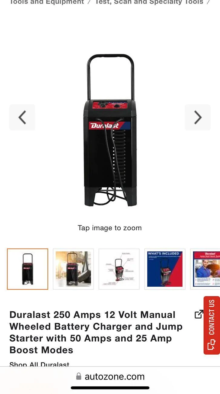

What is a good battery charger/maintainer recommended when using FDRS on a 23 Lariat ER?
I use this one. Sometimes low tech is better. This one just has 2 dials. One for amperage and one for time (duration of charge)

Be careful using a battery charger as a power Supply. The boost modes are not designed for hours of continuous output at the rated 50A. Most times it’s only 15-30 min and it’s not supplying a steady state of voltage or amperage.
IPMA updates can be 1.5-3.5 hours depending on your VCI speeds so I would not recommend any one use a charger in boost mode for flashing modules in FDRS
