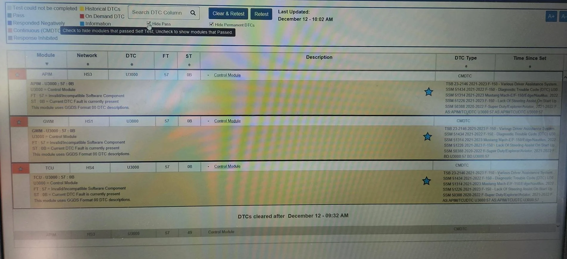

Just got hooked up and already need an assist. 3 modules orange. GWM, APIM, TCU. All say CMDTC present...hmmm i know i am not supposed to update anything unless all are green.
Go to the FDRS CLEAR & RETEST menu and select ALL DTCs and clear them all, then retest. You might have to do this twice.
You'll know that FDRS is clearing and re-testing because the screen will show three horizontal gray circles completing retesting, like clock face edges.

I have done a clear and reset a few times no change. I was told to disconnect the negative on the 12V for a bit then reconnect and try again...
Disconnecting the negative on the 12V can help, will not hurt... it resets "hung" modules. I've done it once in all my FDRS updates on several cars and trucks.

Well day one of attempting FDRS did not turn out with any updates being installed.
As I posted earlier when it ran it was found that there was 3 modules (APIM, GWM, TCU) with a DTC code of U3000 57 0B
Doing some research online I found the following text:
"The presence of this DTC means that an engineering analytic token is present on the vehicle. This analytical token does not affect module functionality or features used by the customer. No attempts should be made to repair this DTC."
When I read this it made me remember I did some testing with Ford and the Home Intergration Kit. They had me go into a diagnostic sync menu and enable an Advanced Analytics Token.
I wonder if I still have that setting on and if the presence of that token is the cause of this "issue"

I did shutdown multiple times, reset the test, and even unhooked the negative 12V terminal for a little while

Sounds like nothing to worry about
SSM 51314 - DTC U3000:57 in APIM, TCU, GWM - Unable To Clear | MachEforum - Ford Mustang Mach-E News, Owners, Discussions, Community
If you are participating in Ford's Advanced Analytics (Tokens) program, it is normal to see U3000 codes in your APIM, TCU, and GWM modules that refuse to clear. This is expected since you are running a slightly different software build that enables the analytics functionality. Modules should not be reprogrammed or replaced due to this code alone.
