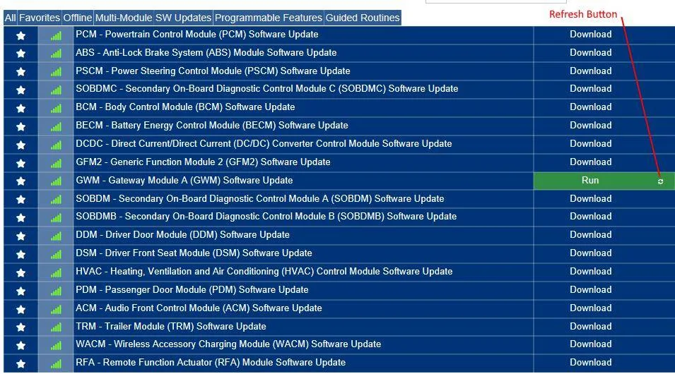

While we're on that topic, I just saw this show up:
Ford F-150 Lightning Lightning Software Updates using FDRS FDRS-alert_13-Mar-25
The refresh button they are talking about is the one that appears to the right of the "Run" button after you've downloaded the tool. So if you get the popup they're talking about, they say you just need to hit the refresh button to get the function to continue. I haven't had to do this yet so...

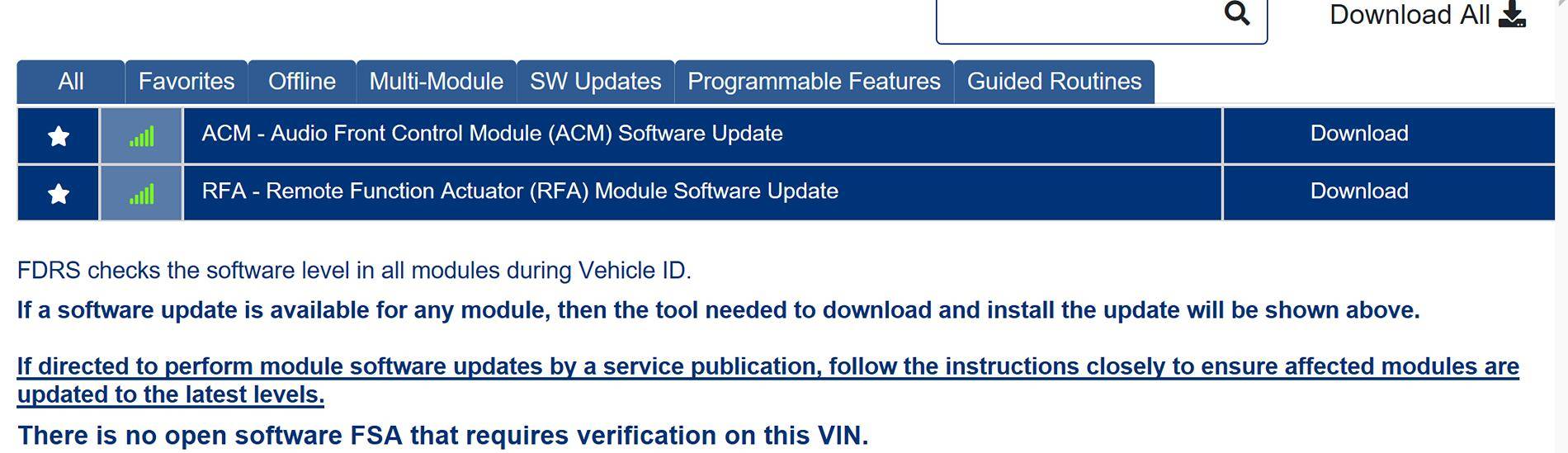

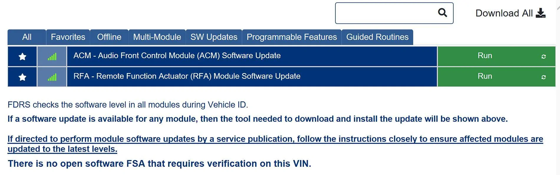

Guys, I could use a bit of guidance from the experts on the team here.
I finally bit the bullet and bought a subscription to FDRS. I went through the many software updates yesterday but I have 2 that seem to be hanging around. The ACM and RFA updates appear to complete successfully but do not drop off the list like the others. I've tried each of these several times and each time, it gives me the successfully completed message each time but still remain in the list.
Any thought on how to complete the task?
This is a known issue, I too had them a few weeks back when I did my first go-round.
It is stated a few times in this thread.
BTW, I'm using an updated TOPDON RLink J2534. It seems to work fine however if you try this dongle, make sure you update the firmware on it first. It bricked my truck on the first attempt - thank goodness it corrected the problem after the firmware update.
These two will indeed drop off, eventually. If You've installed them to completion, then they are already installed... the list is basically an artifact.
Thx, I'll keep an eye on it. It was odd that all other updates dropped when competed except these two.
