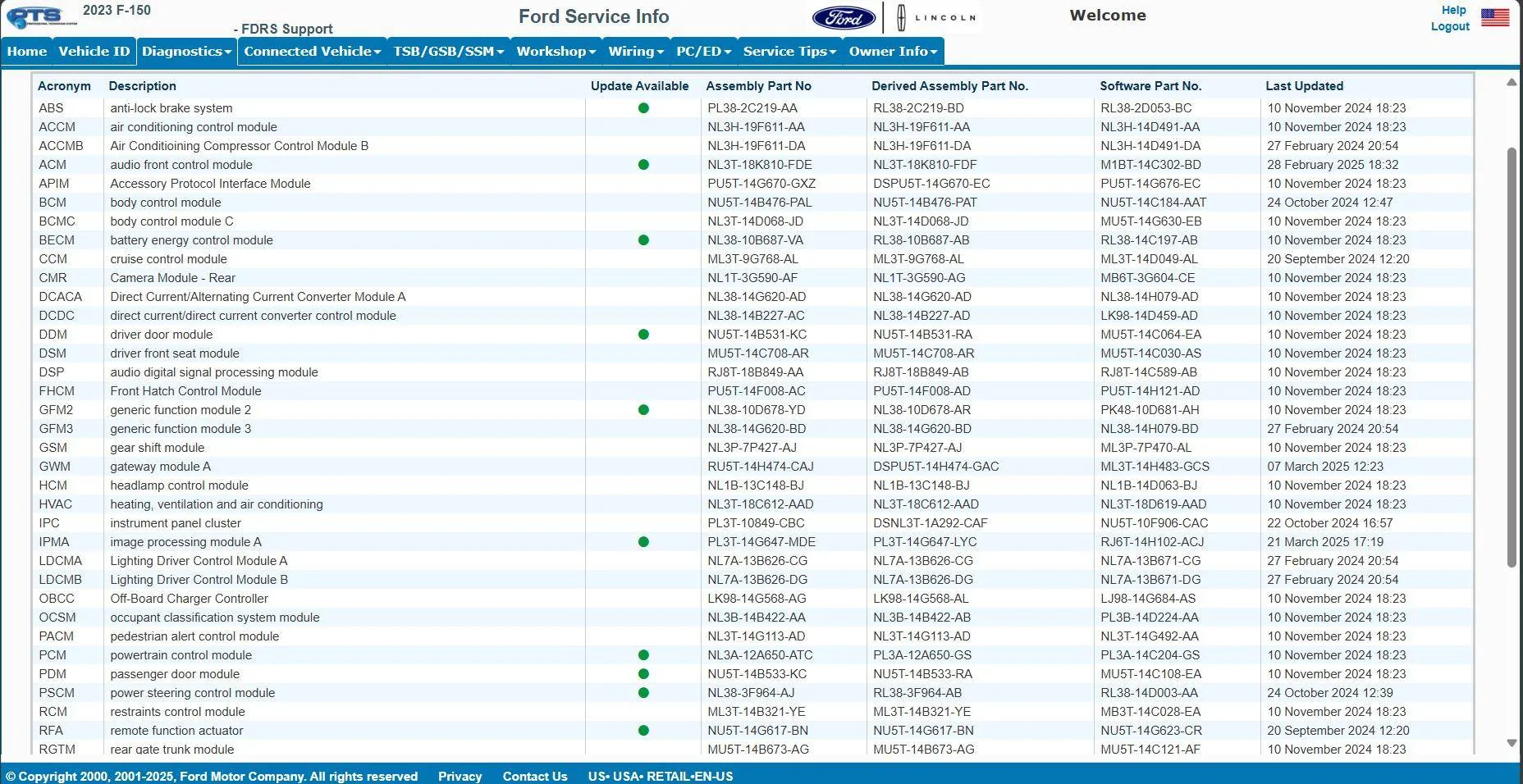

And out of boredom, I got a 72 hr PTS subscription if anyone needs anything checked. Looks like I have quite a few modules with updates available but no official BC 1.4 love yet.
Ford F-150 Lightning Lightning Software Updates using FDRS 1743176994901-i3

IPMA update for the official 1.4 is there in the list.
Wouldn't think it'd be more than a few minutes. Looks like it went pretty quick when the dealer did front sensor csp on mine and think it was like 5 min for the update when I did one month later.
The tool dealers use to do updates is faster than the Mongoose. IPMA/PSCM will take about 2.5 hours for us to do.
