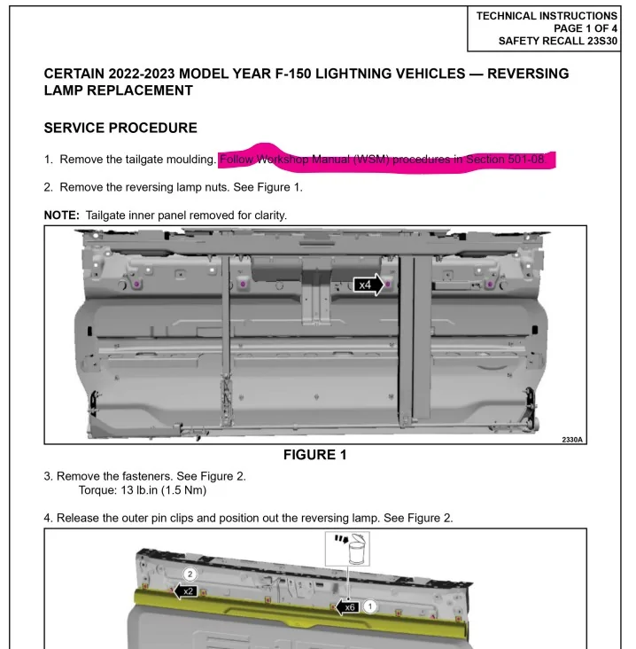

You might want to read the main thread if you haven't already.
Here are removal / re-install instructions:

I tried this afternoon and it was a total PITA. I couldn't figure out how to get everything unbuttoned. There are at least several grommets that would have to be broken off and are not reusable. Whenever I see that in the instructions I tend to think it's whatever but these really do seem to be one-time use only.
I think you have to remove the outside skin of the tailgate above the light bar but I can't figure out how it pops off. If you figure out how to do it LMK because I'm curious what I'm missing. The instructions didn't seem to match what I was looking at after I removed the inside plastic cover.
Hi All. New to the forum and posting in general. I need to replace my rear light bar (2024 model not covered under recall). I the lightbar instructions are easy to find. I can't though find a video or the instructions to remove the "tailgate molding" that covers the top part of the light bar. See attached. I'm looking for instructions from the Workshop Manual , a video, pictures etc. on how to remove the clips/piece. Don't want to create a bigger issue than I currently have.
Just got done looking at the wsm and it doesn't show anything really, it shows to remove that inner gate panel for access to the inside where I assume you will be able to see what holds it on, most likely a row of bolts. Could also be plastic clips, it doesn't say.
