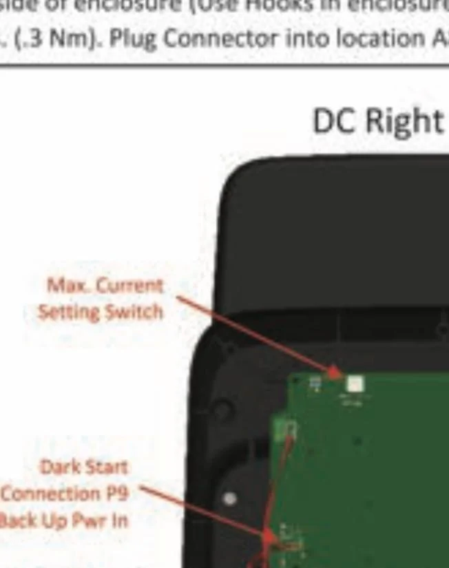

What is the optimal setting for this switch?

See picture for location inside Charge Station Pro Box

It’s set on 7 right now. Not sure if that is correct. Trying to figure out how to improve my charging speed. Just got my station talking to Ford pass but I can’t seem to figure out how to set a higher charge speed.

7 is the 80 amp setting which requires that you have it connected to a 100amp breaker with the appropriate sized wiring. It's all in the manual that came with the charger.

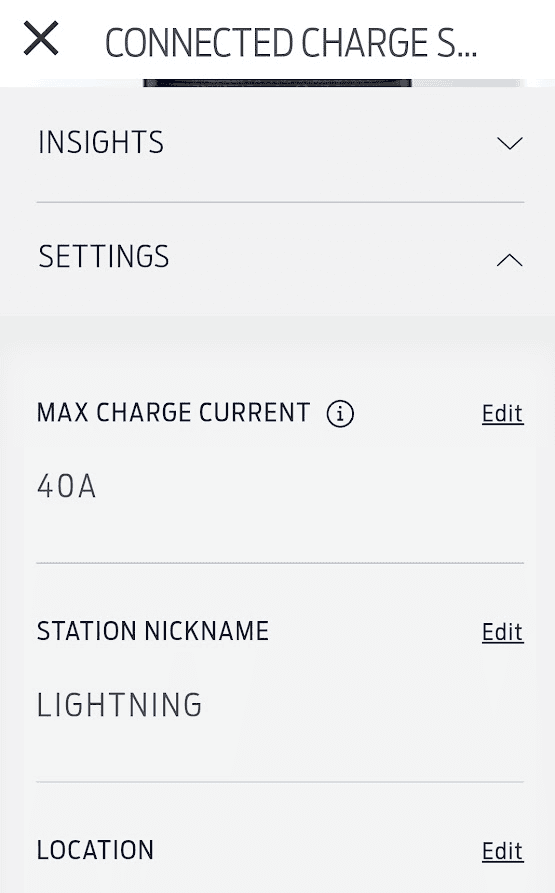

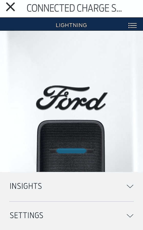

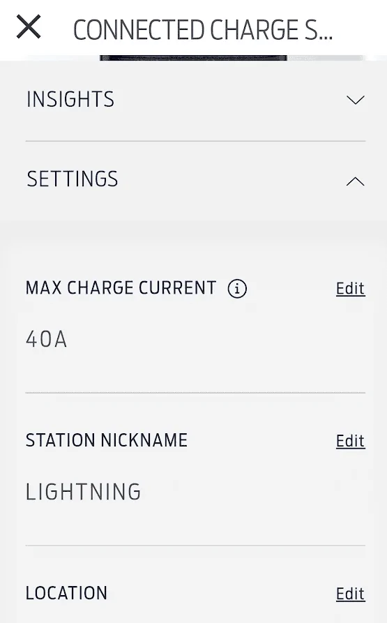

Also, in your Ford pass app, under the ACCOUNT icon find the connected charge station tile, lower right corner of the page, goto settings, adjusted the rate slider to 64 amps until you get a confirmation of the wiring supporting your installation
