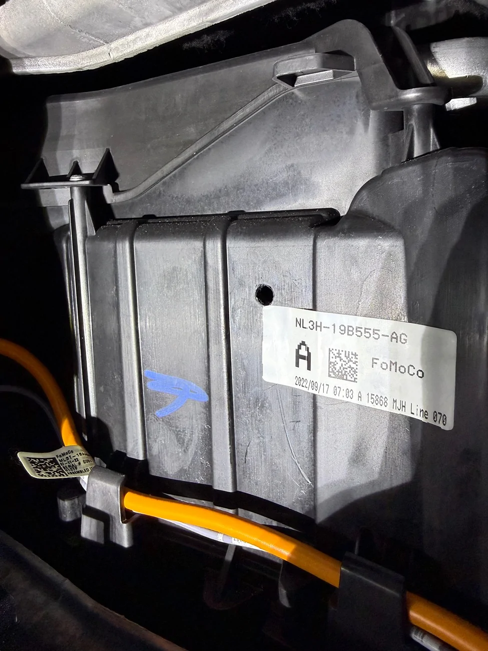

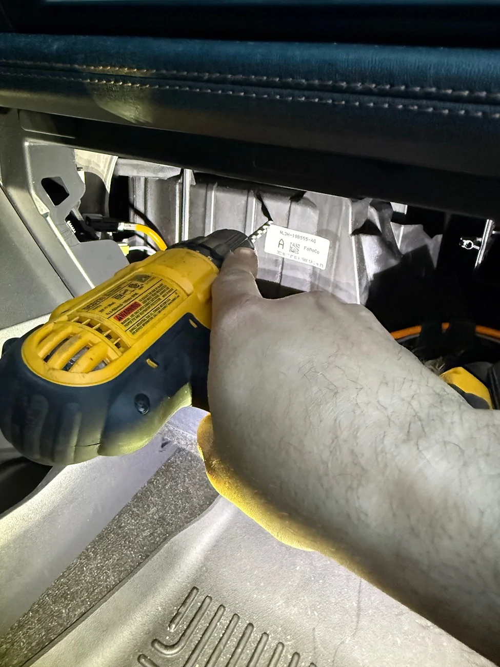

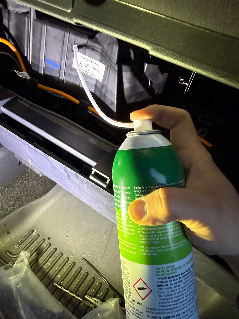

I see you’ve mentioned spraying Kool-It. Have you created a service port behind your glovebox? This helped me significantly with controlling the smell.
Steps I used
Spray cleaner
  • Spray short bursts.
  • Try a few angles to coat more of the coil.
  • Let it sit
  • Wait 10–15 minutes.
  • Cabin filter still out.
First dry/run cycle
  • Start truck.
  • AC ON
  • Fan HIGH
  • Fresh air / recirc OFF
  • Run 10–15 minutes.
Final dry cycle
  • AC OFF
  • Fan HIGH
  • Fresh air still preferred.
  • Run 5–10 minutes.

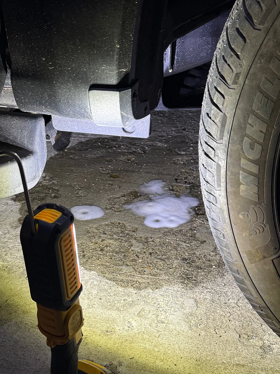

Check drainage
  • Look under passenger/front area for water dripping.
  • Dripping is good; it means the drain is working.
Reinstall cabin filter
SERVICE PORT:

As a side note: Simple Green AC coil cleaner is a much better product in my opinion, but the can needs an adapter. I finagled an aftermarket cap and drilled the end so it could use the wide spray nozzle from the Kool-It can. This only worked one time then it broke. The Lubergard Kool It can has a larger stem than the Simple Green coil cleaner can. If anyone can find a solution to this it would be great, as smaller nozzles do not work since the foaming action is required.
