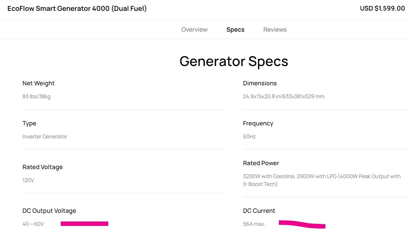

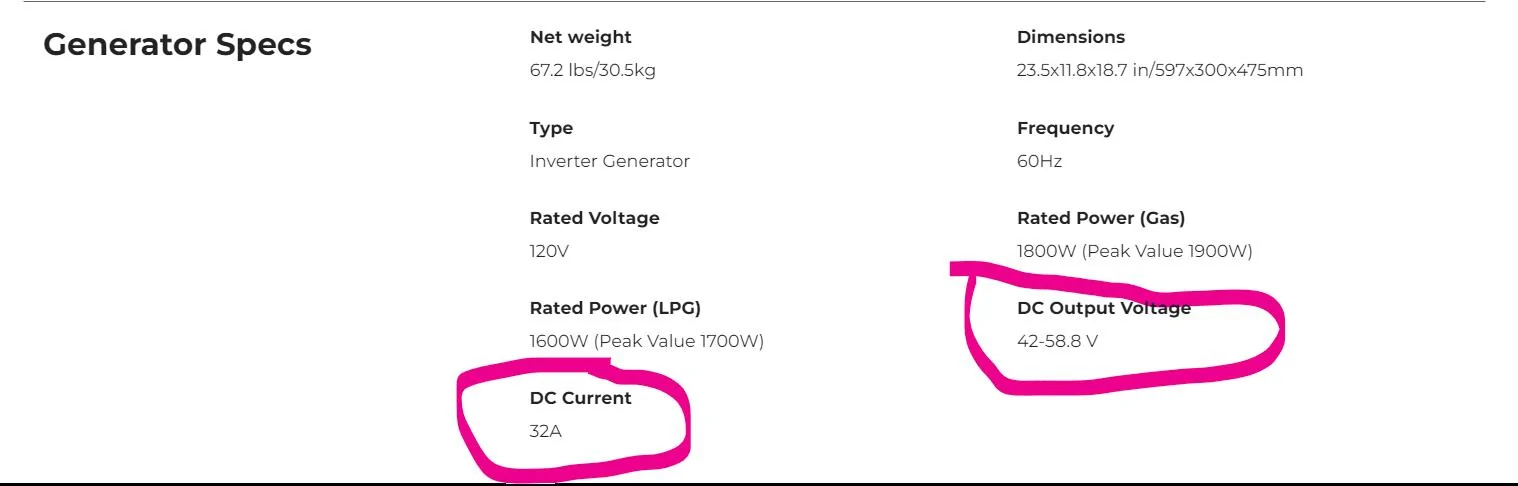

If your goal is to replenish the charge in any of the Ecoflow systems, you could take the AC 240vx30a PPOB output to AC charge the EF systems.
Then allow the EF systems to continue powering your critical circuits when the Lightning needs to be driven away for work or to visit a DCFC for replenishing the traction battery.

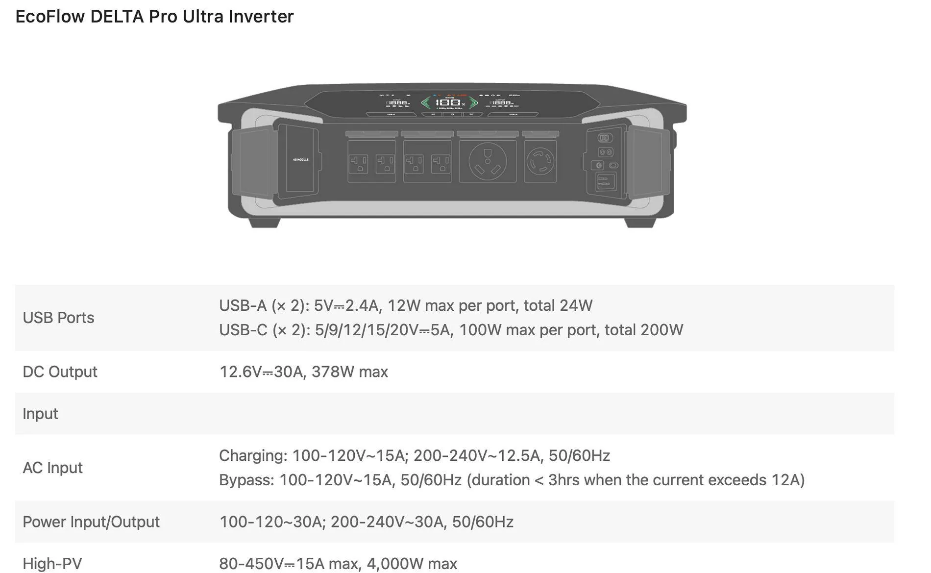

I may be confused here, but I wasn't thinking about using their EcoFlow generator. I was thinking there could be two potential paths to get power from the Lightning to the EcoFlow system:
1. Plug the 240v PPOB output into the EcoFlow DPU. The manual states AC input as follows (https://manuals.ecoflow.com/us/product/delta-pro-ultra?lang=en_US):

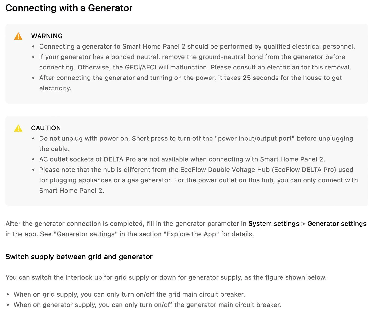

2. Plug the 240v PPOB output into the EcoFlow SHP2. The manual states a compatible generator as "120V single phase / 240V split phase (3-12kW)." Not sure if the Lightning's PPOB output could be this "compatible generator"? Here are some additional details from the SHP2 manual (https://manuals.ecoflow.com/us/product/smart-home-panel-2?lang=en_US):
Ford F-150 Lightning Can you plug the Lightning into an EcoFlow home backup system’s generator input? 1727881246242-7k

You'll have the GFCI trip in the Lightning because it is a bonded source (the neutral is grounded at the truck) and you cannot unbond it.
So you'd need a transfer switch that will switch the neutrals and hots like the GENERAC 6853 for example.

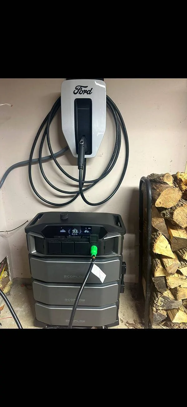

I have the Delta pro ultra up and running on my house for about two weeks now. Waiting for the weather to improve before I install my solar. Per the instructions the a/c output must be turned off to charge the unit at 240 volt. The Lightning charges the unit fine via the 4 prong 30 amp generator cable though the in/out port adapter with zero problems. I have charged as high as 6,000 watts and as low as 1000. You can charge the unit though the 120v charge port on high at 1800 watts with it powering the house at 240v. However that is where I experience the ground fault on the Lightning. I did try removing the ground and the fault went away. Also I am using the Generac transfer switch panel with the floating neutral successfully with the Lightning plugged straight into it with no problems. With the ground intact.
so yes it works. Just not while the unit is outputting power. Unless you play the no ground game. And you are not able to charge with 240 while it is in operation unless you have the smart panel. I do not have the smart panel, but my guess is it would fault out while in operation.

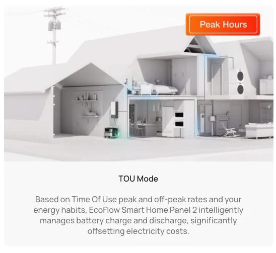

Thanks for all the information. In my opinion, This is the most compelling of the potential Household battery solutions in the market to work with the House & the Lightning via replenishment.
Furthermore the scheduling ability of the Smart Home Panel 2 intrigues me. If I had to do it over again knowing what I know now, I would strongly have considered investing in a battery solution with TOU scheduling peak-shaving capabilities in lieu of the solar that I did install. The overall investment would have been dramatically less, with a similar ROI timeframe and more functionality having the Emergency backup function. Also to me Personally the solar panels are also a bit of an eyesore.

Just to make sure I'm following... Are you going from the DPU into Generac transfer switch in this photo?
I ask because I have the Generac Homelink 6852 Transfer Switch installed already. However, I like the idea of being able to have some batteries to backup if the truck isn't there. If I go this route, I think I'll probably end up going with two DPUs so that I can have one powering the house while one is 240V charging from the Lightning. Just want to make sure I wouldn't run into any issues using the DPU with the Generac transfer switch.

Working 100%. Just no 240v charging of the dpu while in operation. 120V charging while in operation works with the ground removed from the truck to the dpu Mine has been running non stop and charging 120v from the truck overnight for the past week.
