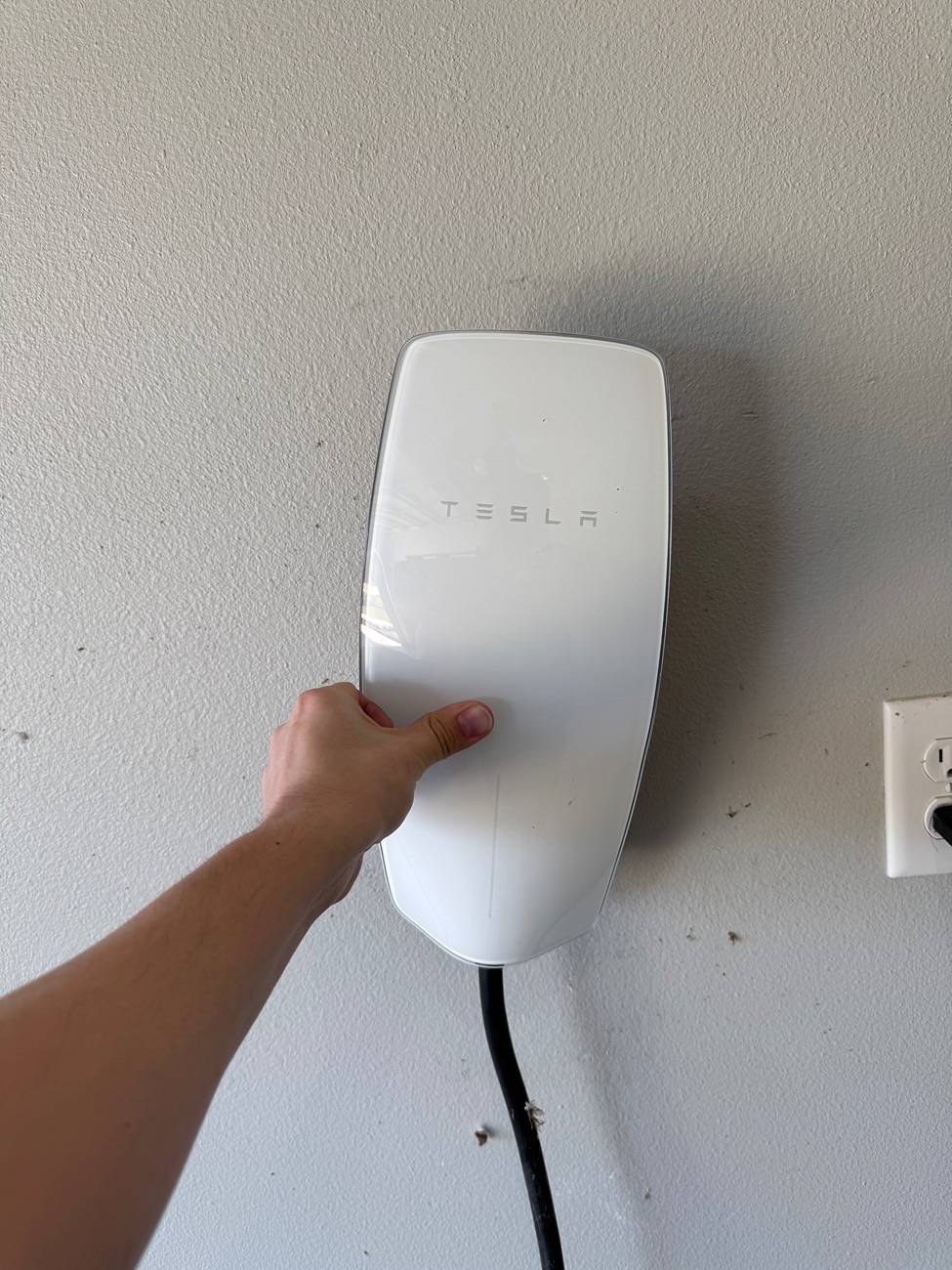

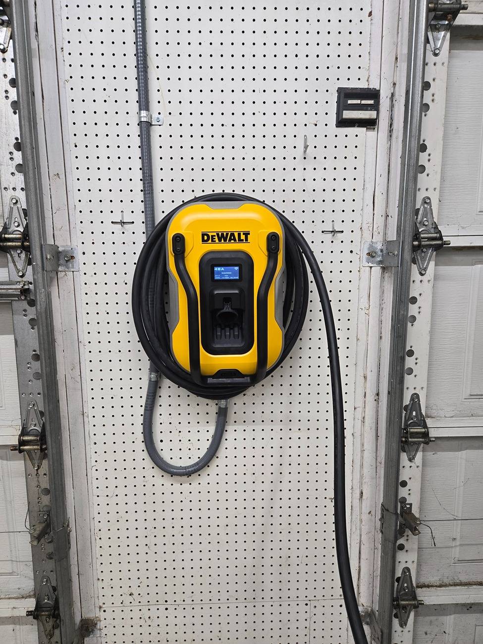

Swapped Tesla for DeWALT. Swap was very easy. Wiring was the same. Mounting was a little difficult with the dry wall anchors. Luckily I had some around the house.
Main reason behind the swap was overheating. Tesla handle and the Lectron adapter were getting extremely warm about 15-30 minuets into the charging session. Causing a temperature throttle from 11kw to 3.5-5.6. Depending on the temperature of the garage. Which most days slow charging was fine but some days I needed some extra juice.
Amazon actually recommended this to me. I took the bait.

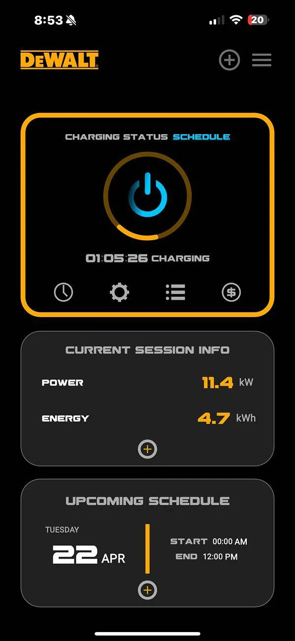

Can’t speak about longevity(obviously) but out of the box. I would recommend. Well built(what I expect from DeWALT) Nice cable. Pretty easy install. App is super easy. 48 amp. WiFi. Surge protection. Screen with data. App has a lot of data too.
felt I needed to share just incase someone was looking to switch.

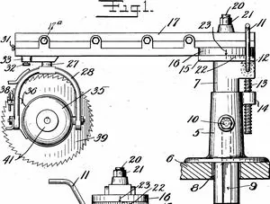

My DeWalt miter saw is very well made. Raymond DeWalt invented the radial arm saw back in the 1920's which he called the ""wonder Worker!" LOL
This is one of his patents on the Wonder Worker technology: https://www.datamp.org/patents/displayPatent.php?pn=1528536&id=5059
