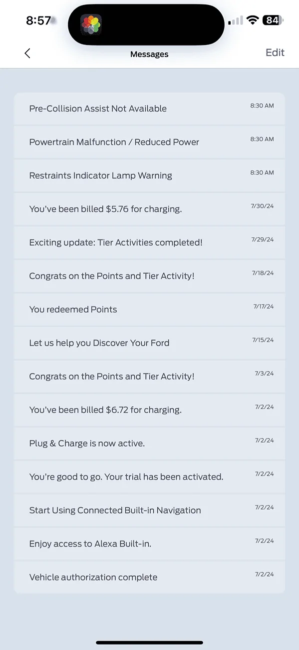

I have been getting these warning messages, and then followed by these others. Truck drives fine, other than I lose cruise control. Turn it off and back and and sometimes they go away. Here recently its happened 4 times in a day. I’m at 56k miles and it’s been a little buggy at times, but overall it’s been great! I cleaned the truck, Should check something else?

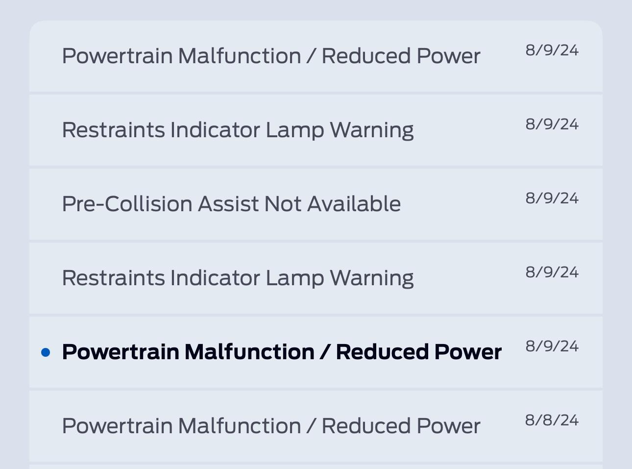

Any updates on this we’re in the same boat
Been to the dealer twice since new
Brake booster replaced last time and 30 days later here we are again.

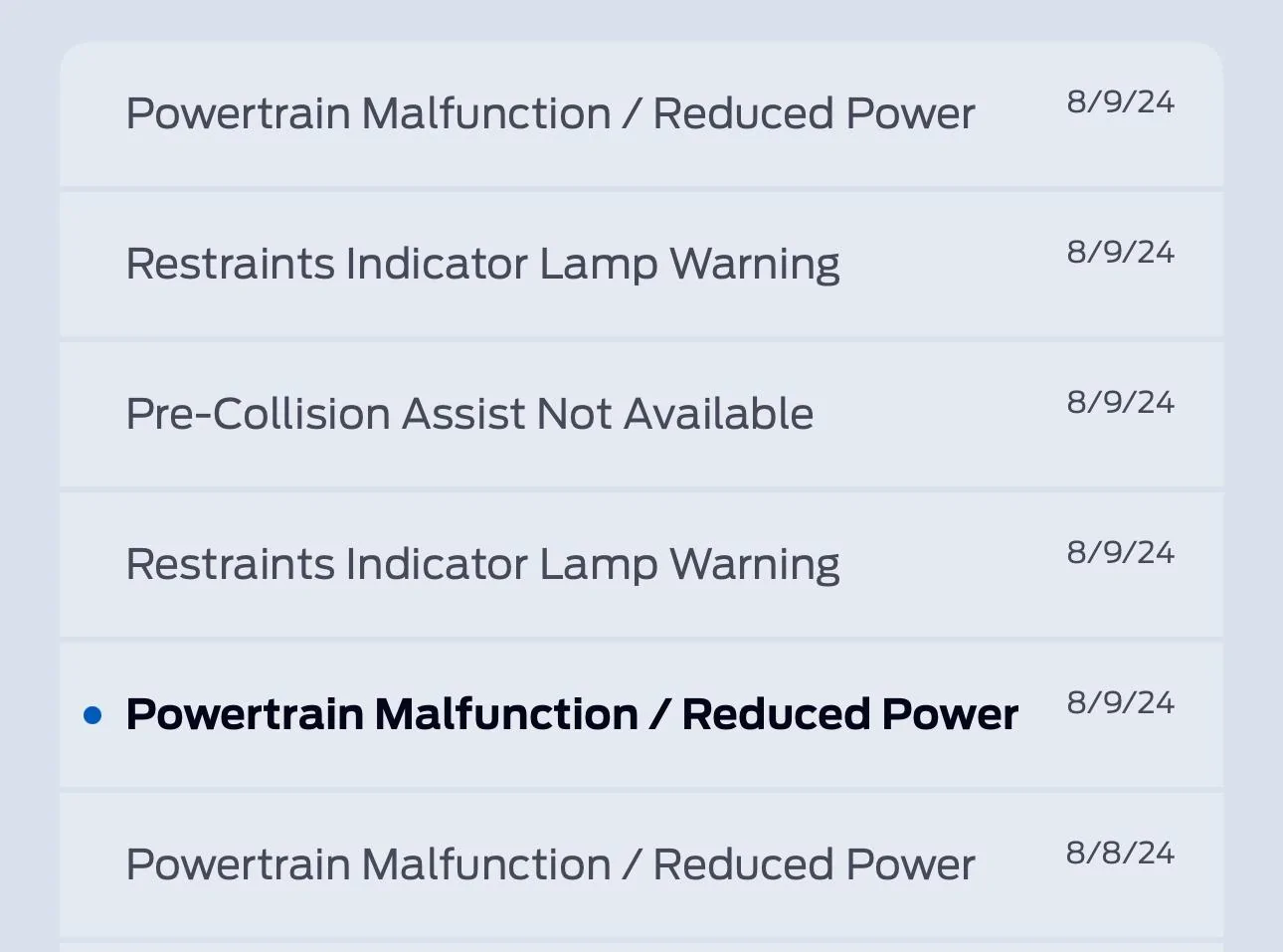

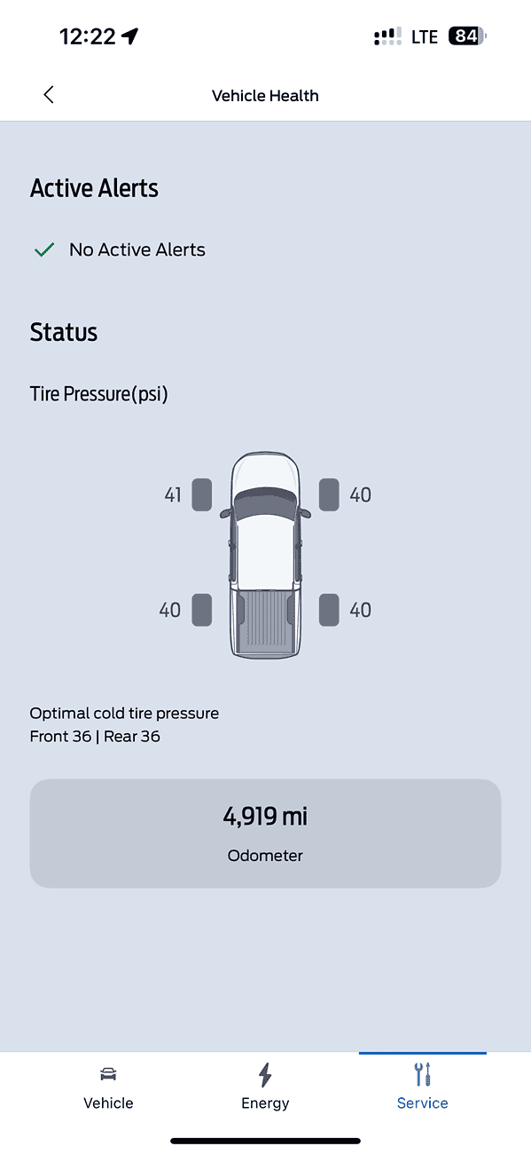

All ready did yesterday. Here’s the strange thing. It’s gone today and wife drove it 80 miles.

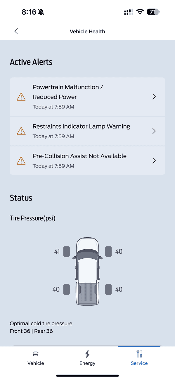

Same thing popped up this morning, 23 XLT SR with 2.5k miles.
Same errors. I just parked the car, will check back later if they’re gone or not.
Already sent you a message @Ford Motor Company with my VIN.

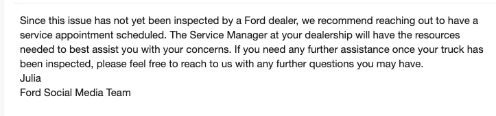

I did the same thing, and here is the answer I got from you. If I may ask, what is the reason for you to ask if you are going to tell me to go to a dealer?

I didn't have a power loss when I got them. I was able to drive, so I was able to get back home. I didn't have them when I started the truck an hour later (thank God).
I hate the feeling of "What if I have it again, right now, in the middle of a trip with a 2-year-old?" but I guess that's something I have to live with.
