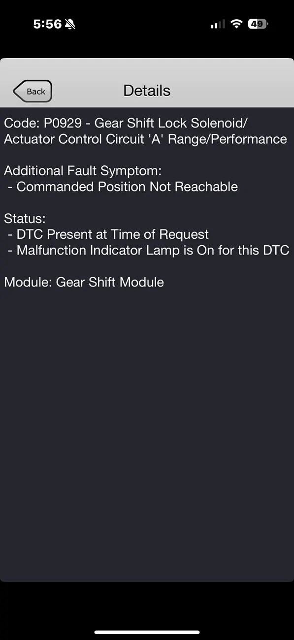

I have noticed the hotter it is outside +95F the more likely I will get the Gear Shift Mechanism (GSM) error as read on the scanner and the service engine soon orange wrench on the instrument screen. I attached a video of the fold shifter button failing to fold making a nice clunking sound as it pushes up against the stuck lockout solenoid. Appointment Friday August 15th with the Dealership to get their opinion.

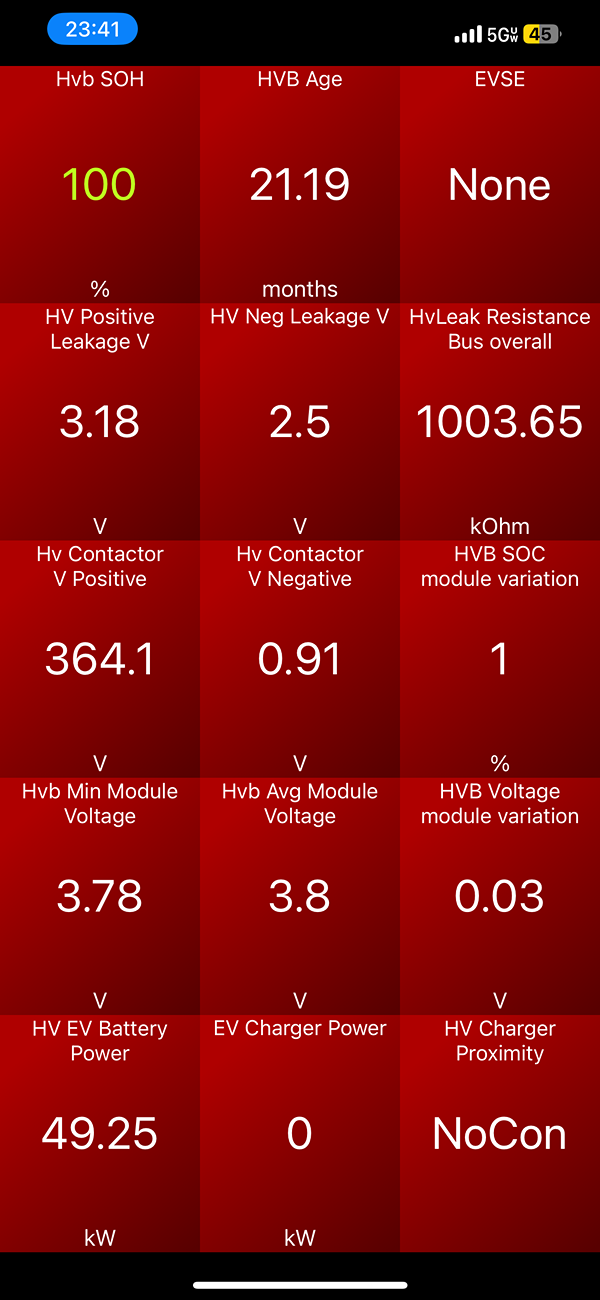

Bad module incoming? This assumes Lee’s insight applies to the Lightning. Never seen my variation so high.

Hard to believe a 1% variation would be a bad sign. And with 100% SOH State of Health! Wish @Ford Motor Company would give us more insights on batteries and their calculations.
Following up with this, the HVB module variation creeped up to 1.16% yesterday and 1.34% this morning. SOH still at 100%. Im wondering if this will lead to anything or the BMS will automatically balance past a certain percentage of variation.

FWIW, it seems like the BMS is doing its thing. My variation today started creeping back down: 1.1%, 1.09%, 0.93% and last I checked it was a 0.77%. This is all within a couple of hours with no charging and short drives inbetween. For dorks like me, I really wish I could sit down with an engineer and pick their brain on the trucks logic.

Edit - F/U. Got about a mile out from dealership and DTC popped again. This time just a wrench and "Service Vehicle Soon." Drove back to dealership and this time said....."Shifter." Part is back ordered (of course). "We'll call you when it's in." I almost bought a rotary shifter just in case! I'll put it on Forscan and see what the actual code is.

Dealer accepted my Gear Shifter "GSM" Forscan error as fact and ordered me the back ordered part. I had them confirm the part number for the reworked replacement Shifter on the 2024 Lariat as NL3Z-7210-AL for the other trucks it ends in AK. Both the ICE trucks and the EV trucks us the same part and it appears the failure rate is high. I researched the rotary dial solution and find that if it is the unmotorized version and you can have a tray printed in resin it would be fool proof and about $600. That $45 tray as seen on ebay is at home 3D printed an looks like it is 3D printed. If Ford would just sell me an OEM version and eliminate all this electro mechanical failures that would be perfect. I don't need a self folding magic move shifter, but a 580 HP truck that burns no gas, is very cool. I drive a 1000 miles a month and my electric bill is maybe $50 more then it was last year. Slap some new solar panels on my porch this fall and that $50 turns into $0. Try making your own gasoline at home.

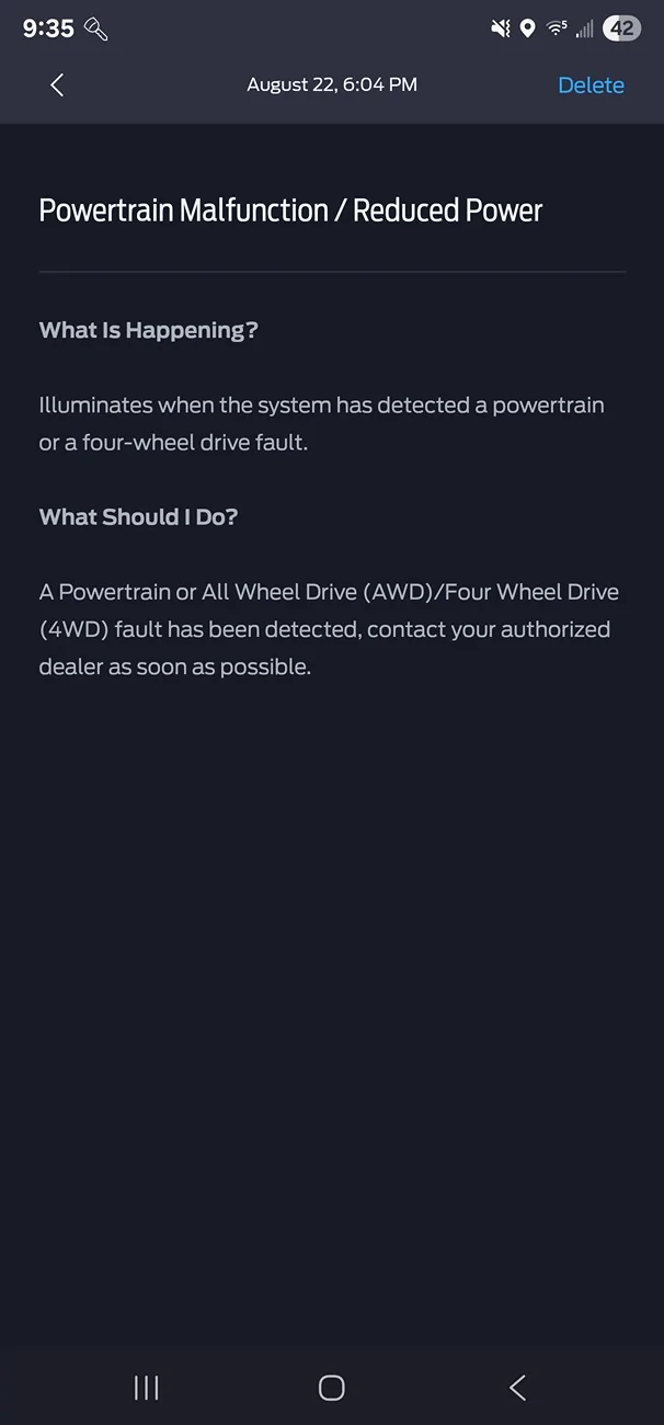

I got the orange wrench of doom yesterday. Was gone today after I started it but seeing it once and reading about it makes me think I might be seeing it again.
Any charging problems or power limitations? If not, see about replacing gear shift module?
