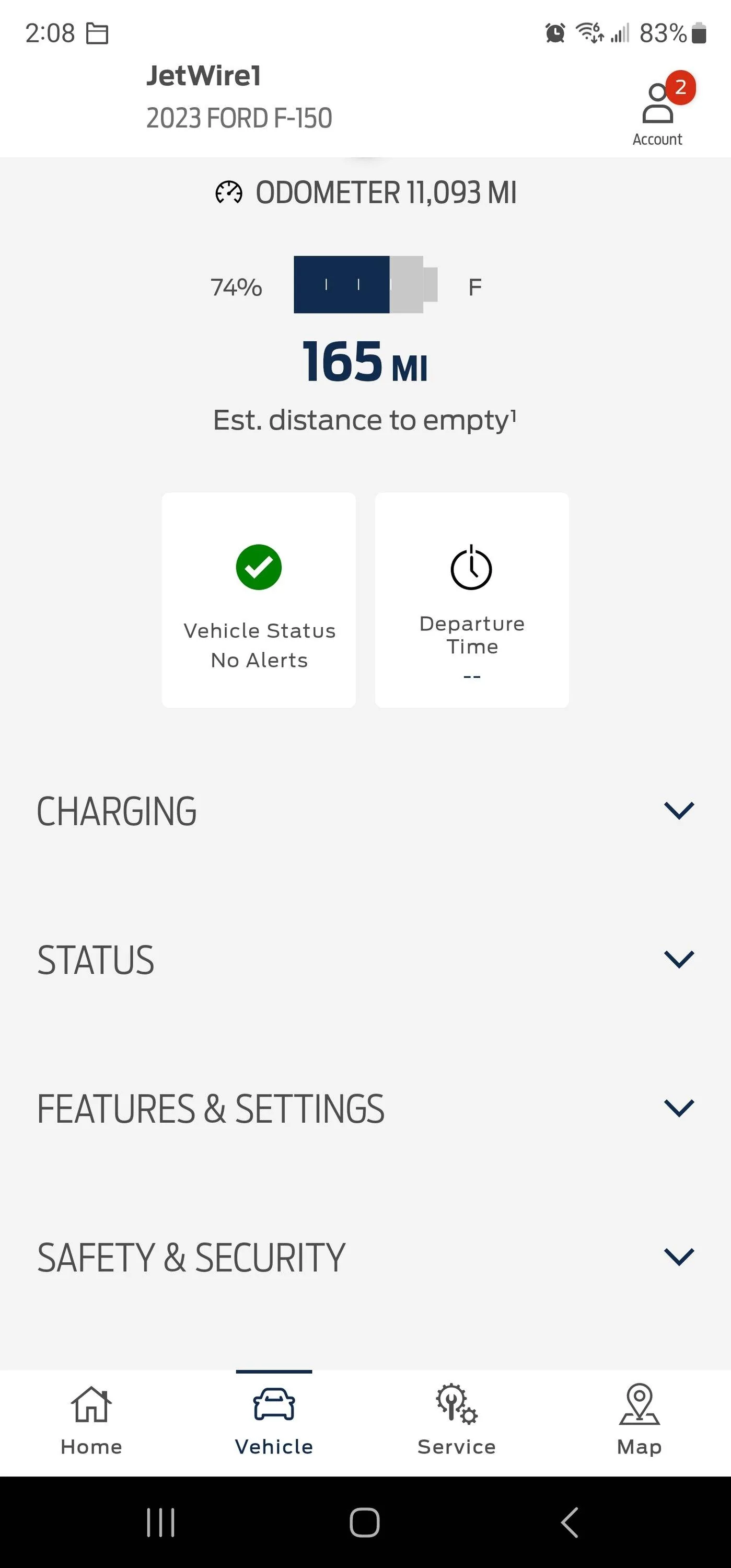

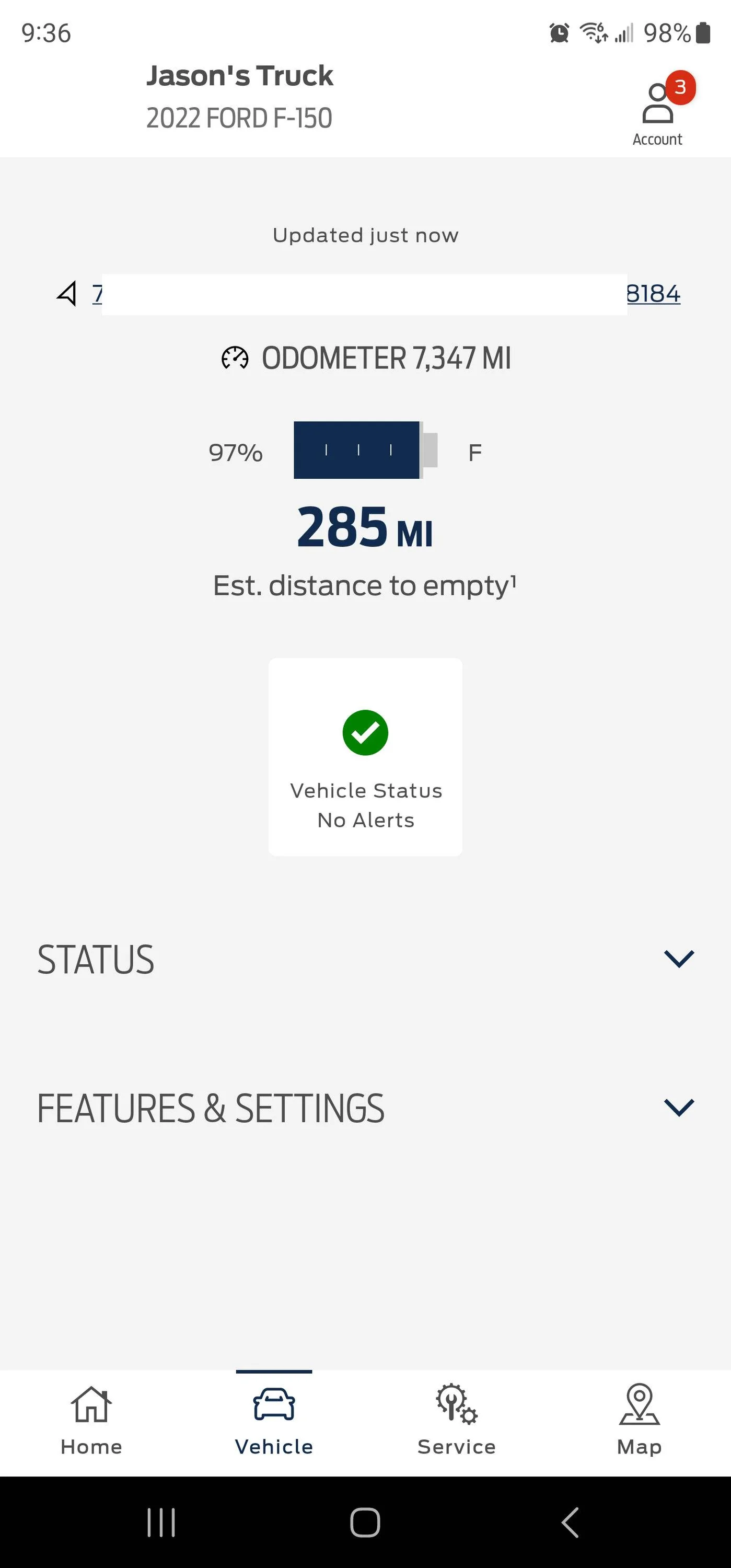

New to me '22 Platinum. Super old software? Beta pre release? Missing lots of app features

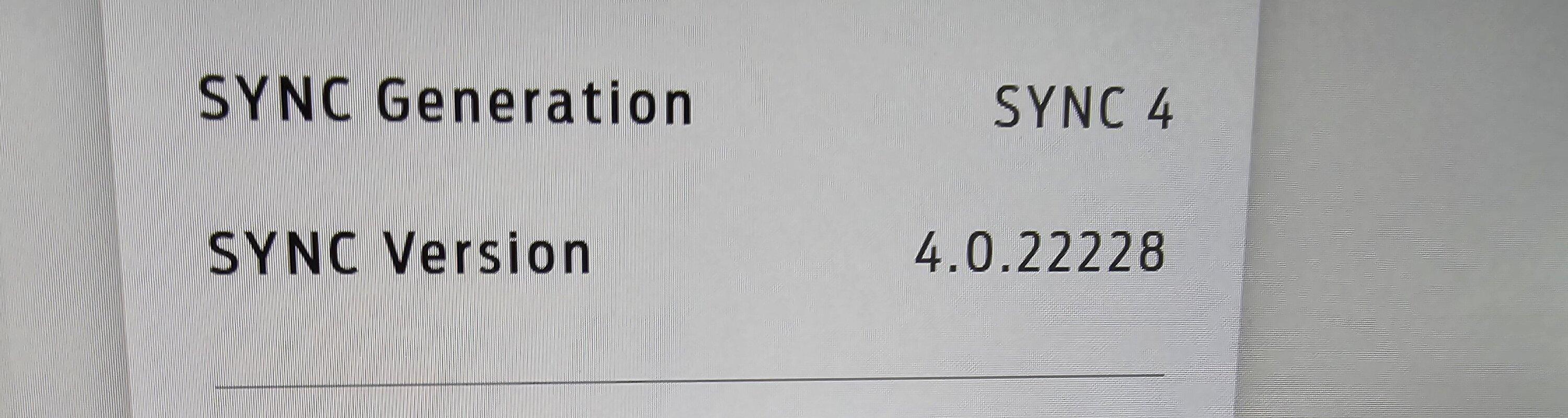

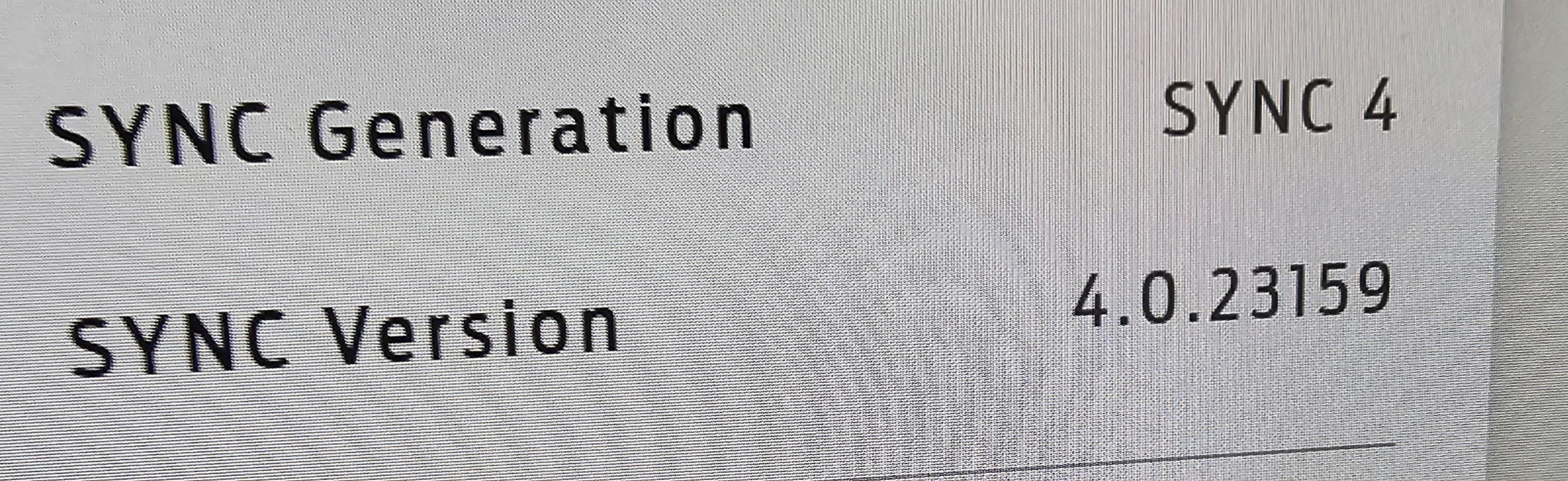

I thought I would keep this thread alive. I bought the Mongoose cable and spent most of the day yesterday installing updates myself using FDRS. I am happy to say the truck is now fully current and all missing features on the truck and in the app have appeared. It wasn't cheap and it was a long process but it was worth it for piece of mind. Also worth it to not have to leave it at a dealer for who knows how long. If anyone does this just make sure you have a 20amp minimum 12v charger hooked to the jump posts. Some of the updates dragged the battery down to 11.9v even with the charger connected. Other than that it's pretty hard to mess anything up. Cheers!
