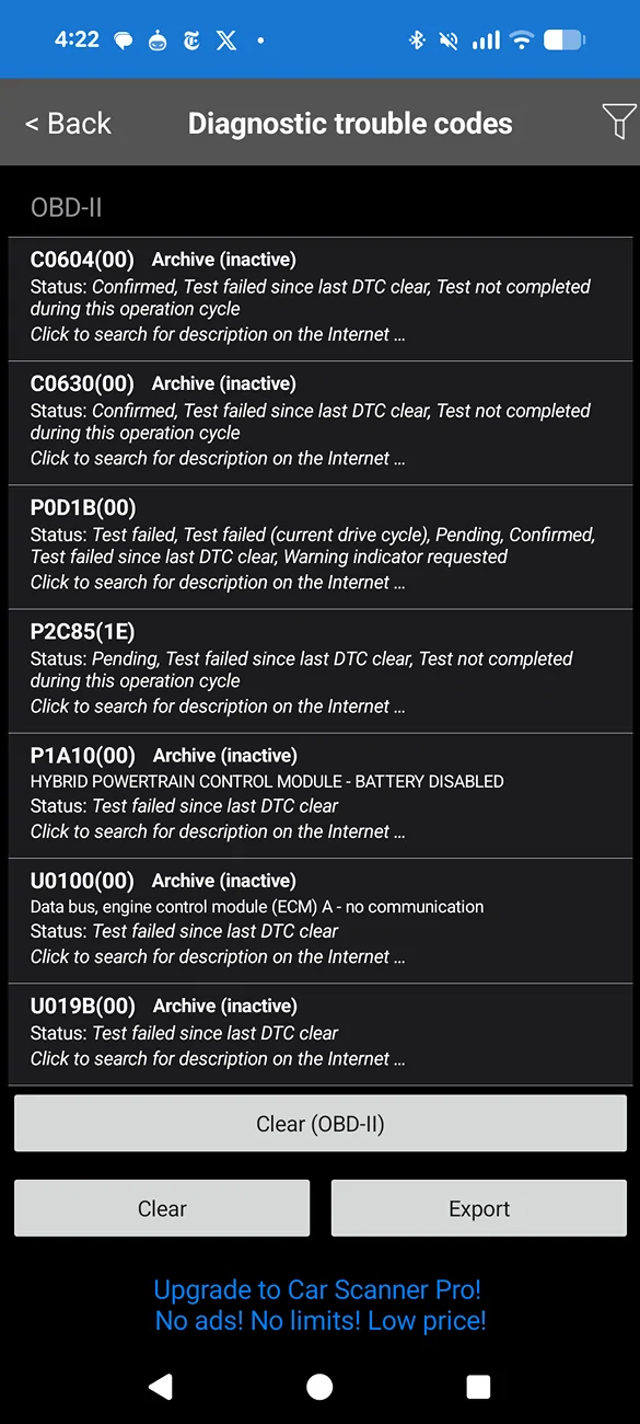

I ran an OBD scanner but don't fully understand what to look for in the codes (attached).
Working on finding a time to get it in for service. Anyone had this? Is this a shifter thing?

Your PTC heater or your diverter valve is probably malfunctioning, with the onset of cold weather your truck is warning you in not so subtle ways that charging may become an issue in colder conditions (Sub Freezing)
Thanks for the advice. That does make sense. I'm in Minnesota and we have had a few nights where temps are near freezing in the past week or so. I usually park it in an insulated garage but I've got some stuff stored in there at the moment so it's been outside (usually plugged in) overnight. Maybe that has been enough to kick off the fault codes?
I'm bringing it in on Monday. Hopefully it's not as bad as it sounds!

Ditto the above about the valve.
But I'm also wondering if there is a bad wire/connection somewhere related to the control circuit which is also one of the possibilities for the code P0D1B that can cause a bad/stuck valve.
There is the question of a weak 12V battery - since you had a U0100(00) archived code which could indicate a weak 12V battery. But that could be faulty wiring as well.
An obvious question: I assume you have adequate coolant in the reservoir? No coolant, no heat, and possibly causing those other codes.
If you have coolant, and there is no obvious sign of wiring issues (like evidence a rodent has been chewing on things as some have seen inside the battery compartment and elsewhere) then I'd bet on the stuck valve.
But I think you need Ford service to check things out if there is nothing obvious.

The 2 DTC Codes listed that are not archived codes both go back to HV Battery issue
Being that heater isn't working right perhaps the Coolant Valve is suspect.
P0D1B Hybrid/EV Battery Pack Coolant Control Valve V Performance/Stuck OFF
