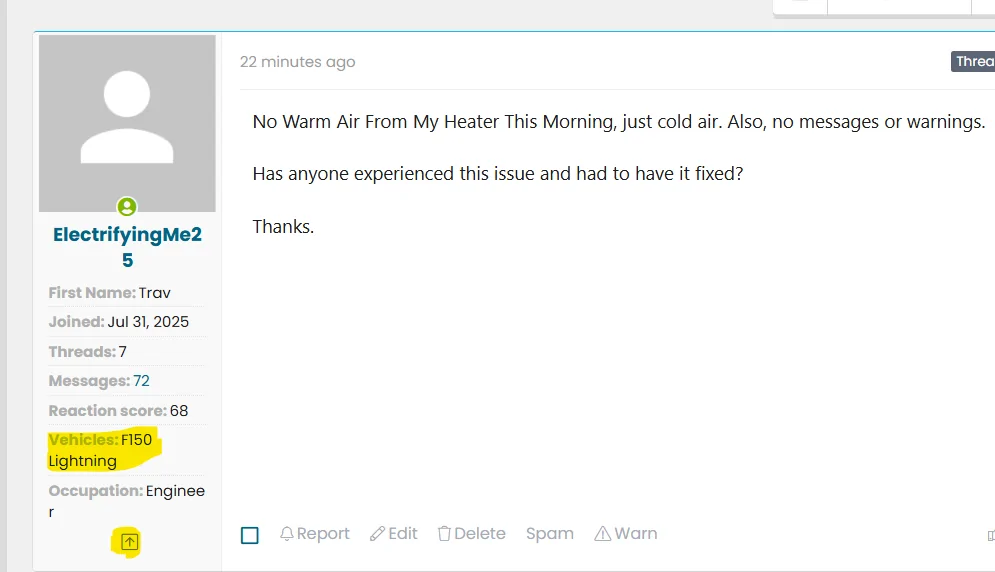

No Warm Air From My Heater This Morning, just cold air. Also, no messages or warnings.
Has anyone experienced this issue and had to have it fixed?
Thanks.
