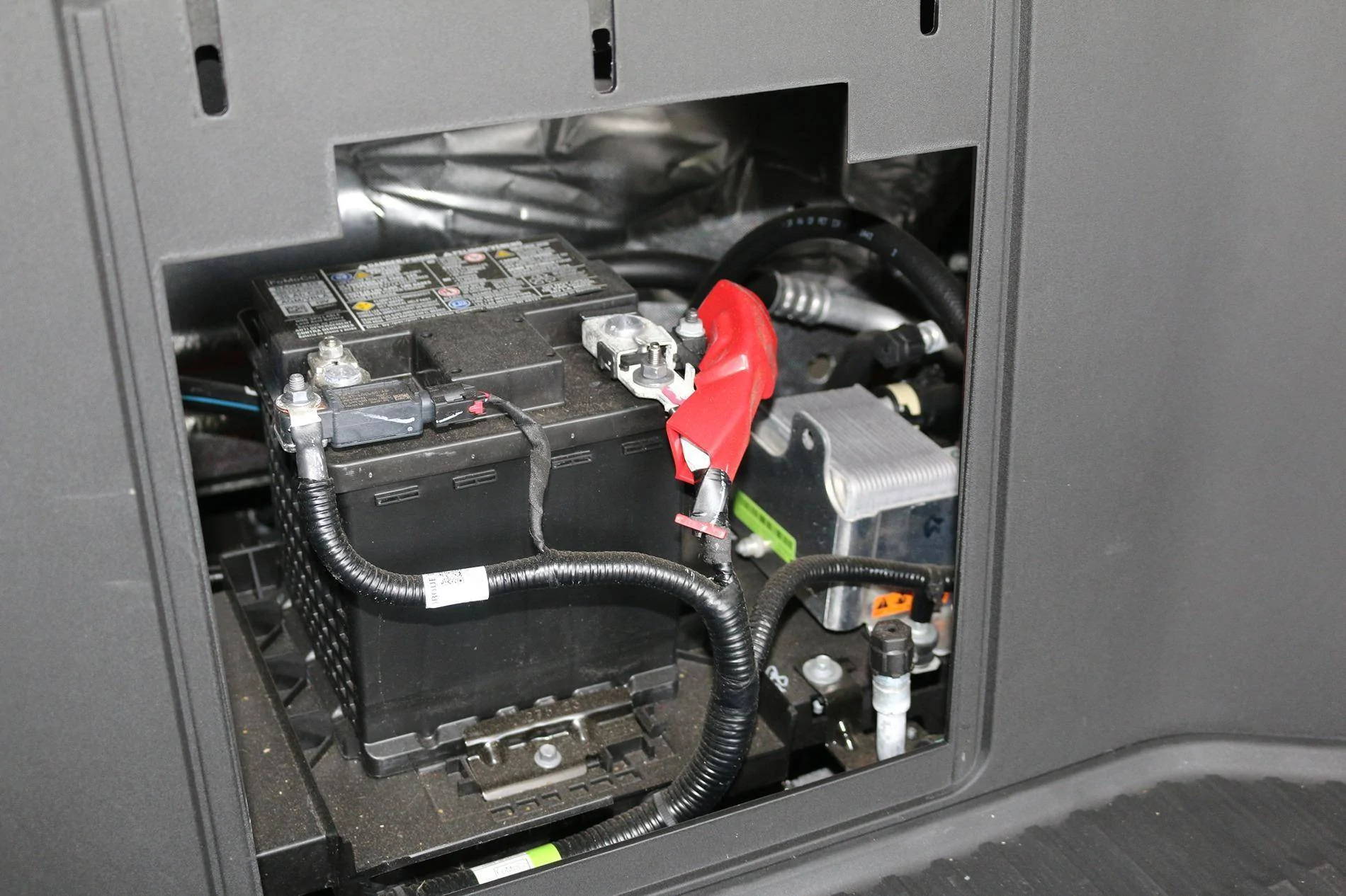

Max Tow is a paid for item for trims below Platinum, I don't see it listed on your sticker, so you don't have it.
FYI to all interested, the Max Tow Lightnings will have the chiller/exchanger unit located to the right side of the 12v battery (looking into the frunk)

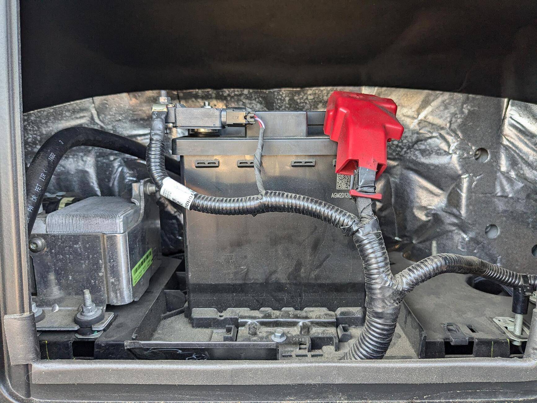

Those without will have the chiller/exchanger to the left side, as seen here:
Thank u.
