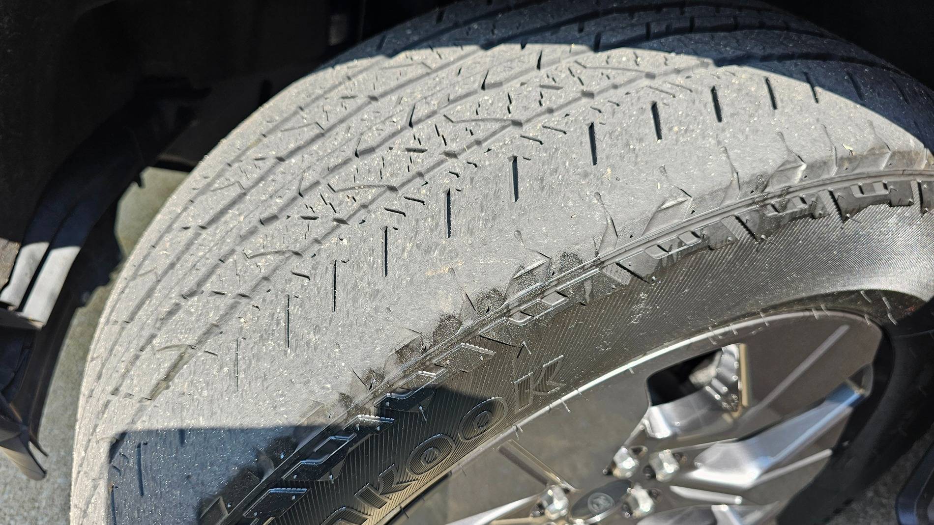

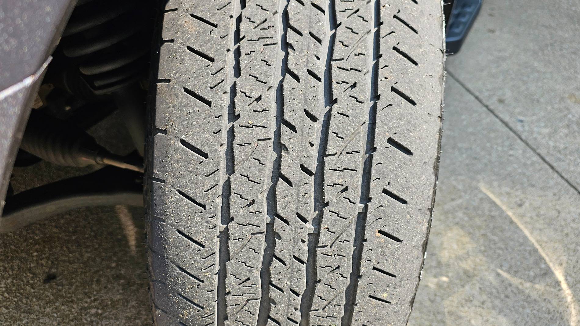

For the members that switched to the Defenders, does it seem that they wear better than the Hankooks?
I have about 28k miles on the Hankooks and they are worn on the edges just like everyone is saying. I think that I'm going to score a set of the Defenders this fall, right before snow season. I hate having garbage tires on my vehicles. My Hankooks will have plenty of tread life left in the middle of the tires when I switch them out but I can't chance it.
I've also hydroplaned a couple times with these crappy tires over the last 2 years, that scared the crap out of me!! I just want to make sure people are satisfied with their choice to switch to the Defenders.

The trucks with the 116 rated all season tires show 42 psi on the door sticker. During daily driving the all season and all terrain tire trucks weigh the same rolling down the road, so a 6 psi discrepancy is odd to me. Looking at your wear pattern the shoulder are worn out while the centers have good tread, suggesting underinflation.
Mine at 42 psi seems fine. I do notice it’s a little easier to break traction at full throttle, but it is predictable so not a problem. I’d love to get through my 36K mile lease without having to buy tires before turn in. If I will have to buy a set of tires to turn in my lease I might as well buy a better set now and get the benefit of using them and turn it in with the factory tires.

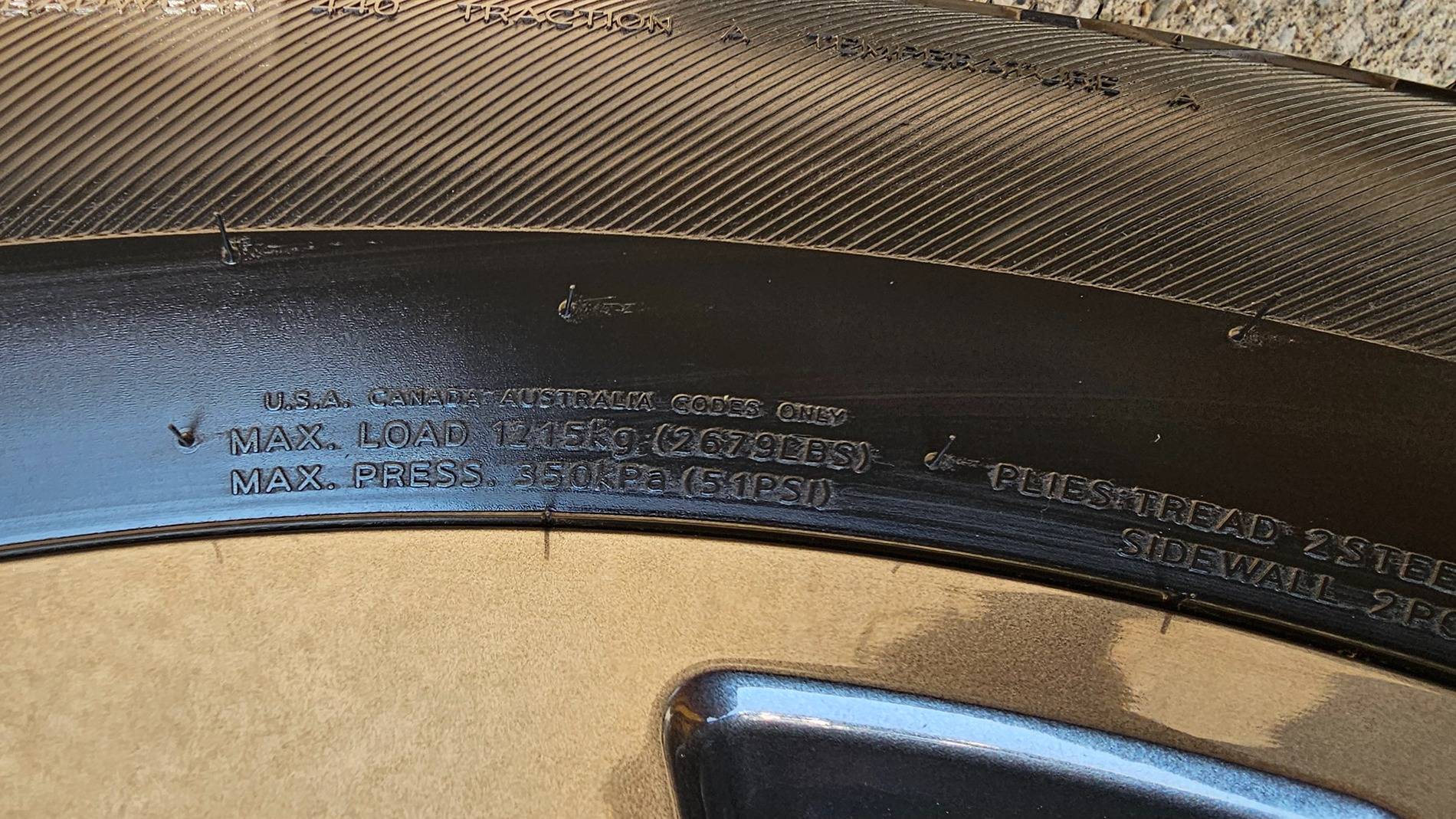

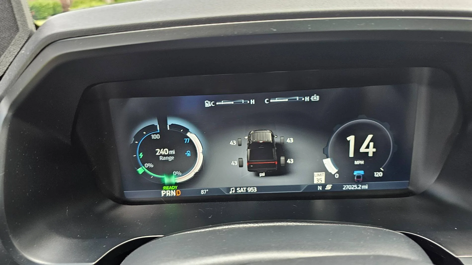

The info on the sidewall says, do not exceed 51 psi. I bumped the pressure up from 36 to 43 psi. I'm going to roll at this pressure for a while and see what happens.

Completely agree. I increased the tire pressure on my OE Hankook tires to 44 psi as soon as I got my truck. They wore evenly and I got about 72,000 km on them before replacing. I switched to Michelin Defender LTX M/S2 tires since I've used these on other trucks I had and they performed very well.

One thing is for sure... feeling bumps in the road is much more prevalent going from 36 to 44 psi. At 36, the truck felt like new springs and shocks. It still handles the bumps well... I can just feel them more now. :unsure:

Hmmm, I didn't notice a difference going to 42 psi Either there is little.differance and/or I'm oblivious to the change in ride. Result.for my satisfaction is the same.
