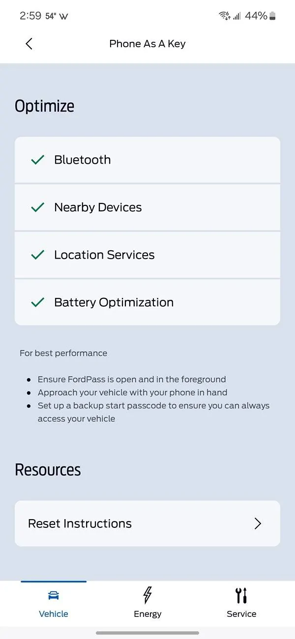

My PaaK works so well I'm surprised when it doesn't. Samsung S24, Android 14. The S21 I recently replaced worked just as well. On my wife's Navigator I'm surprised when it actually works.
Have you optimized for PaaK? Also, a phone reboot generally clears any issues I have.

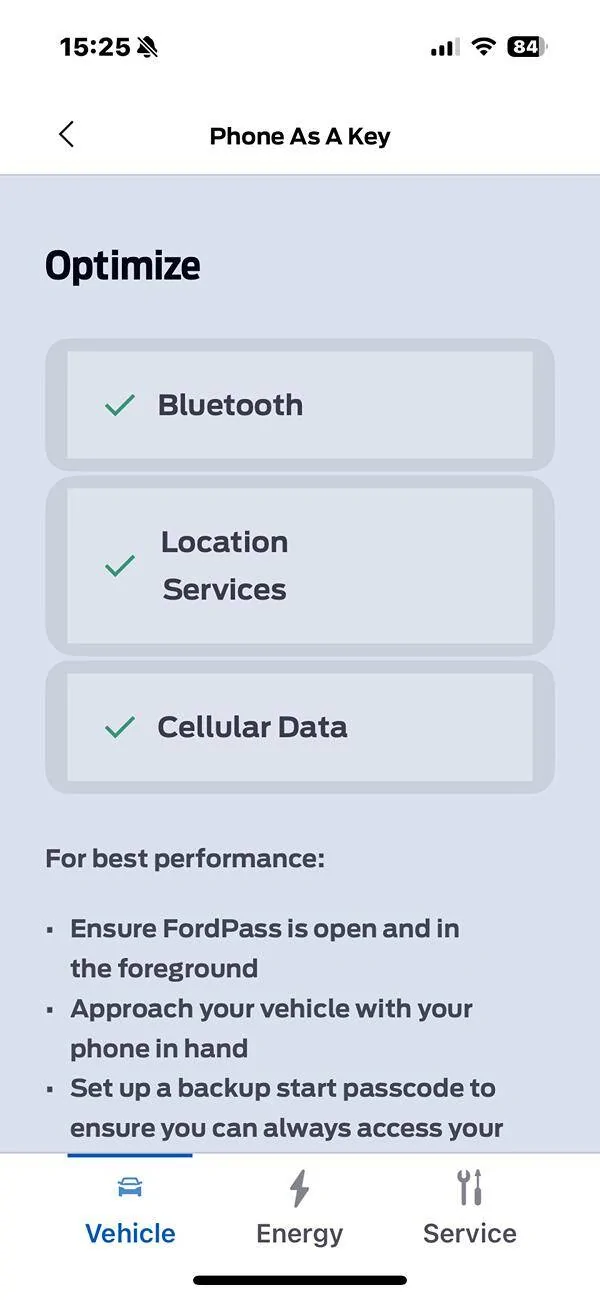

hmmm. Yours looks different. I’m on iPhone 16. What version of Ford Pass are you running.
I don’t have the battery optimization

hmmm. Yours looks different. I’m on iPhone 16. What version of Ford Pass are you running. I don’t have the battery optimization
5.10.0. Probably the difference between Apple and Android. That looks right to me.
