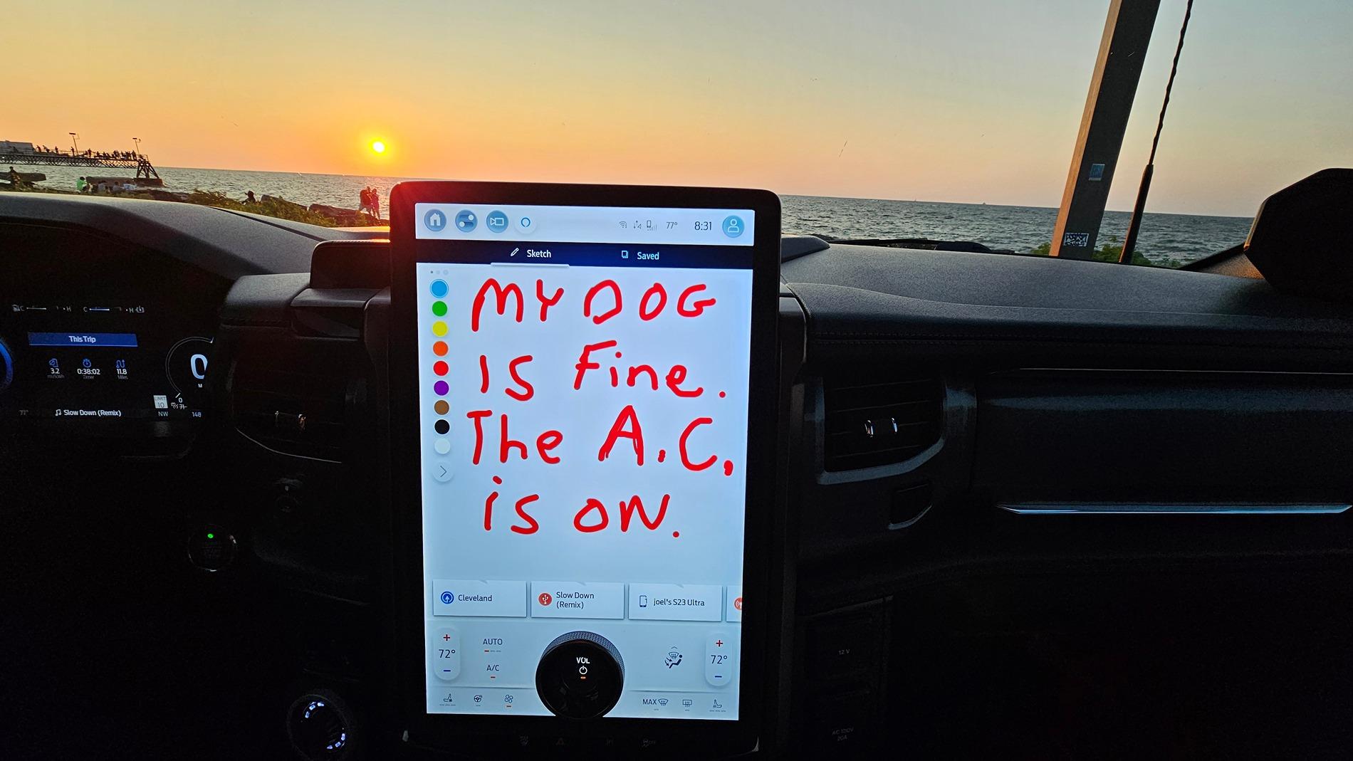

Leave the truck running, set the parking brake, turn off the exterior lights
Switch off the 30 minute automatic shutdown timer, which kicks in if the key-fob or PAAK devices are not present.
Use the paint app to write custom message on the center display regarding the healthy cabin condition.
That's how I've been doing it.
