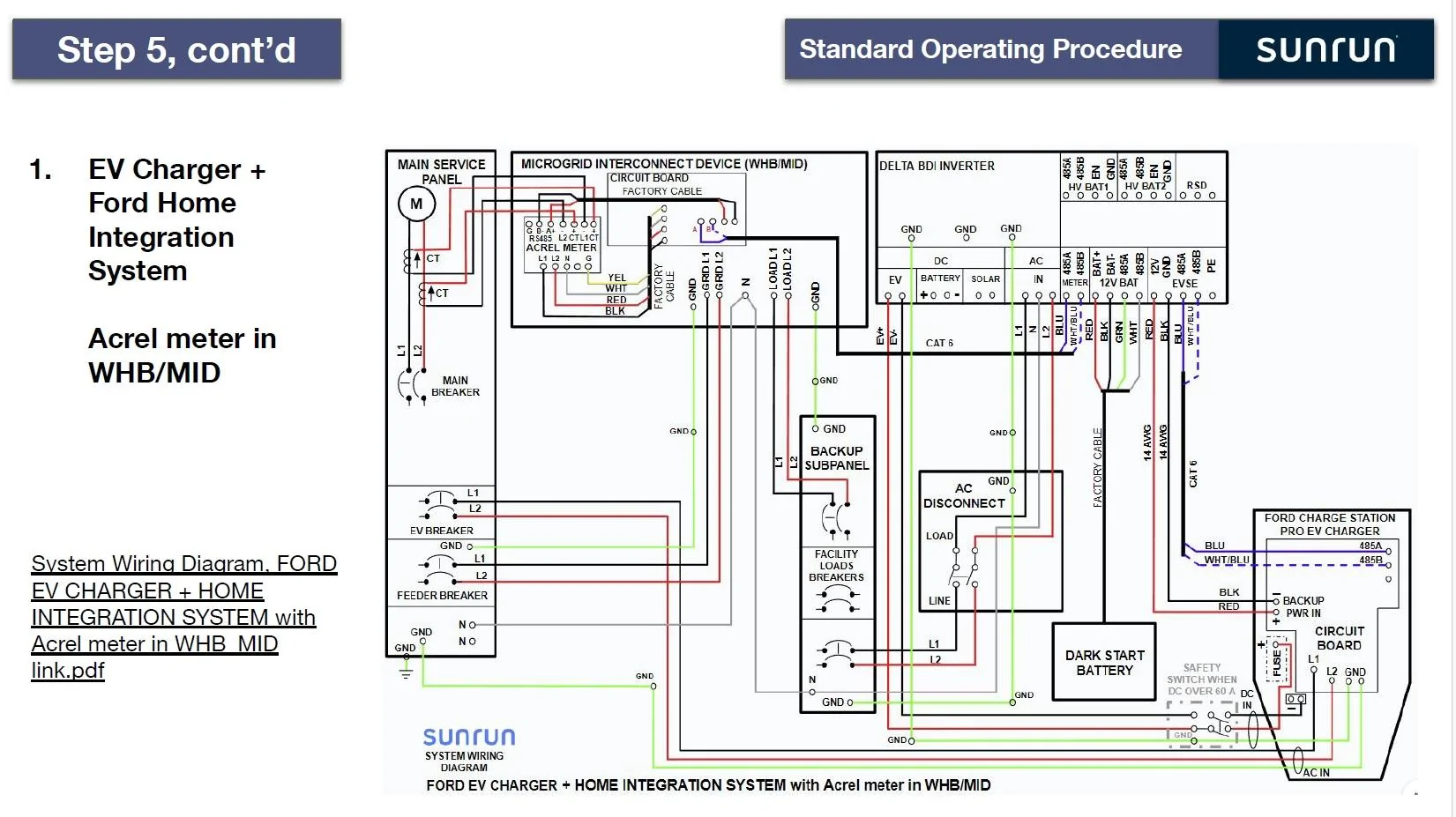

My long range plan is home integration with solar (PV).
Functionally, the circuitry is basically a control module, an inverter and a transfer switch.
This is a diagram of the SunRun version without the photovoltaic circuits (solar) (or other battery storage - except a dark start 12v battery) connected.
Ford F-150 Lightning Plug Will NOT Disengage From FCSP FIXED POST 87 Integration System CSP-SunRun wiring
So far I haven't seen any other EVSE's that doubles as a home integration battery backup interface.
In the mean time (before I jump on a home integration system) I will use the 240V 30A out from the Lightning bed via a Generac neutral switching transfer switch in case of an outage with just the basic house circuits connected (as I did with my gasoline generator and my old transfer switch).
