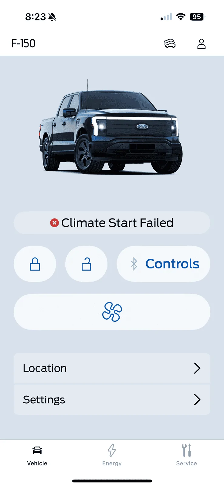

As others have noted, I’m seeing some erratic behavior since the update. Some or all may be related. I’m not sure.
1. I have no climate controls. When I press the climate button the app spins then the truck beeps three times, several seconds apart, but climate does not activate and I get an error:
Ford F-150 Lightning Post Fordpass Update Issues 1716812649013-si
2. there are no climate controls beyond the “fan” button on the front screen. Could be a product of #1. I’m on IOS.

I got the climate working, it seems like the setting in the truck somehow got reverted to not allow remote climate start. Once the climate control works then you access to the options.
The charge slider is still useless and every time I back up the sensors light up like it's Armageddon.
Love this truck but damn @Ford Motor Company the software is FUNKY.
@peloazul I have no idea what modules may be dependent if any at all. Who knows with the scattershot distribution of updates?
I did also delete and reinstall, this also may have resolved the climate issue.
