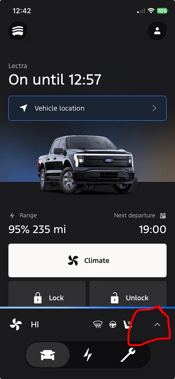

I was wondering if anyone would actually use it lol. So push the Start Truck shortcut, wait a few seconds, open the app, at the bottom expand the climate settings, change the climate settings to what you want. Annoyingly it won't use 'last settings' AFAIK.
I've done every iteration of use of the Ford App controls, Sync settings, departure timer and remote climate start, never operates consistently with regard to customizing the heat level or steering wheel controls, when I get out to the truck and press the start button, the Sync screen will show the steering wheel warmer off, but to the touch it was on and had up to that pointed warmed the wheel, what I'd like is for it to STAY ON!!! come on @Ford Motor Company get this right after 3 years!
I obviously don't know the logic behind what they're doing (intent) or why (technicalities) but the way it works on my truck is that on remote start, it uses whatever settings are set in the app. On powering the truck, it resumes whatever was set at power off.
Example: At power off the settings are 72F, Heated steering wheel off, and Heated seats on auto
In the app currently with the weather, I have temp set to max, heated steering wheel on and heated seats to max
When the weather is cold, this is actually a perfect scenario because it can deice the windshield before I enter and set a comfortable temp on drive.
I suspect the reason for this is technical, since the Sync system isn't booted until you start the truck, another module must be in control of those systems. Once Sync boots, it changes those module settings to the settings that were in play at power down. Is it similar on yours or what? It may be a difference between the 12" vs 15"
