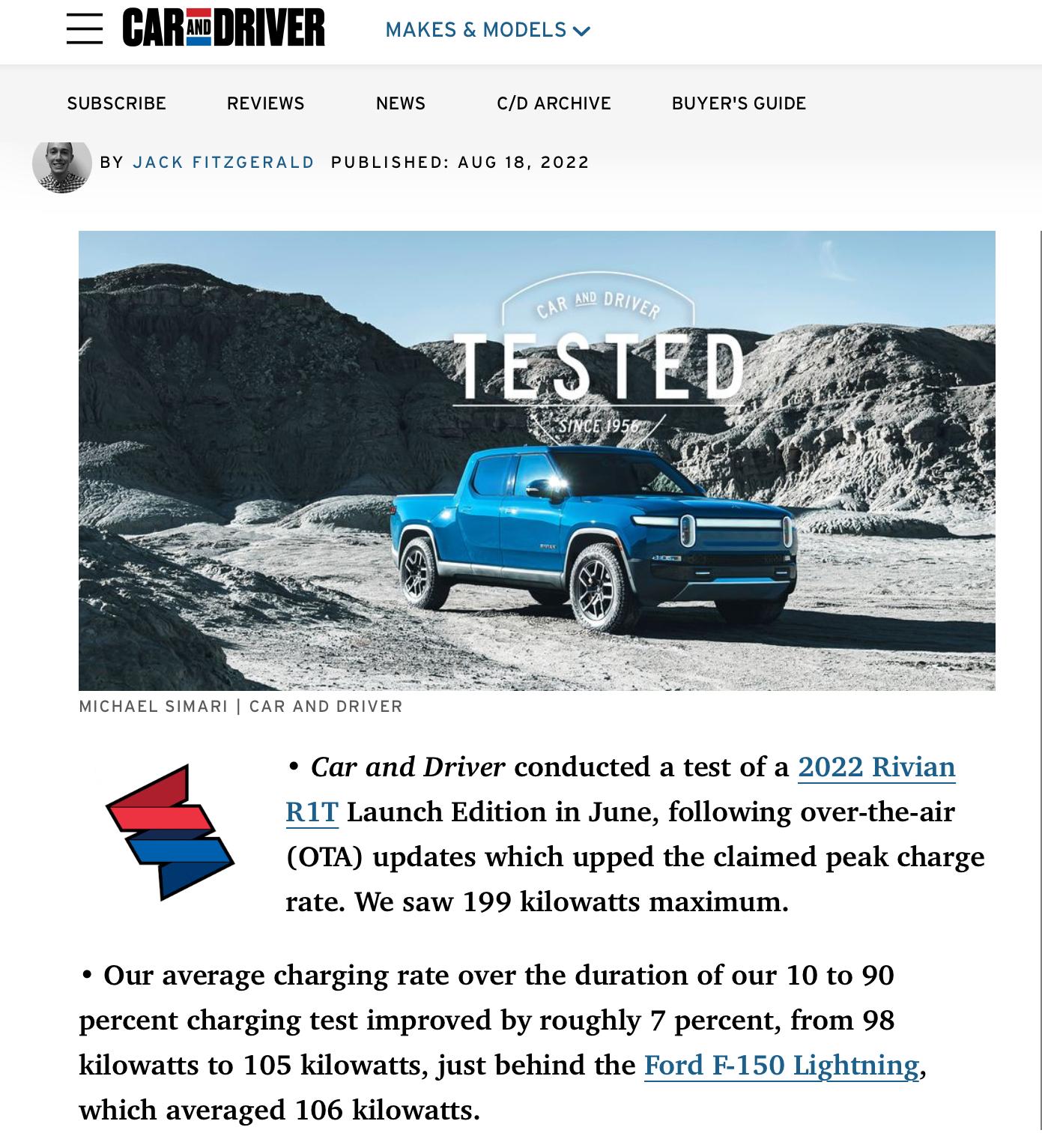

I just took the Engineering specs and did the math. Can manufacturers cheat the specs? Sure. Let’s see how that plays out.
Here is recent Rivian test. Average charge rate is the same as the Lightning.
You're moving the goalposts to "average charge rate" because you're wrong about your max claims.
160 kW isn't the "absolute max" for the Lightning. It isn't the "absolute max" for 400V. And 400A isn't the limit for CCS.
Lightning ER has a pretty flat charging curve. That's great, and it means it overcomes its unexceptional max rate when charging to 80%. But OP has an SR, not an ER, he was asking about max rate, not average rate, and your claims about max rate aren't accurate.

I guess I should have said “useful“ or ”practical” rate instead of max, since that’s the only thing that matters.
Have fun with the big numbers….the bottom line is that the current generation Lightning will never charge at 350KW, which was the original question.
