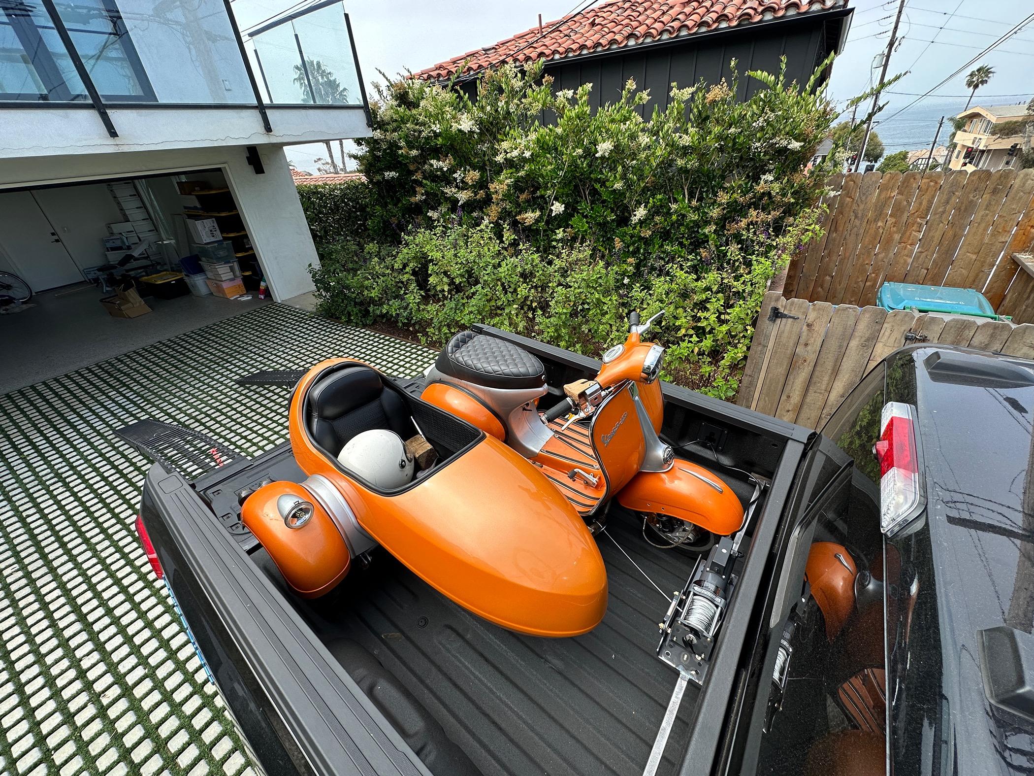

Moment of frustration - perhaps of my own making?

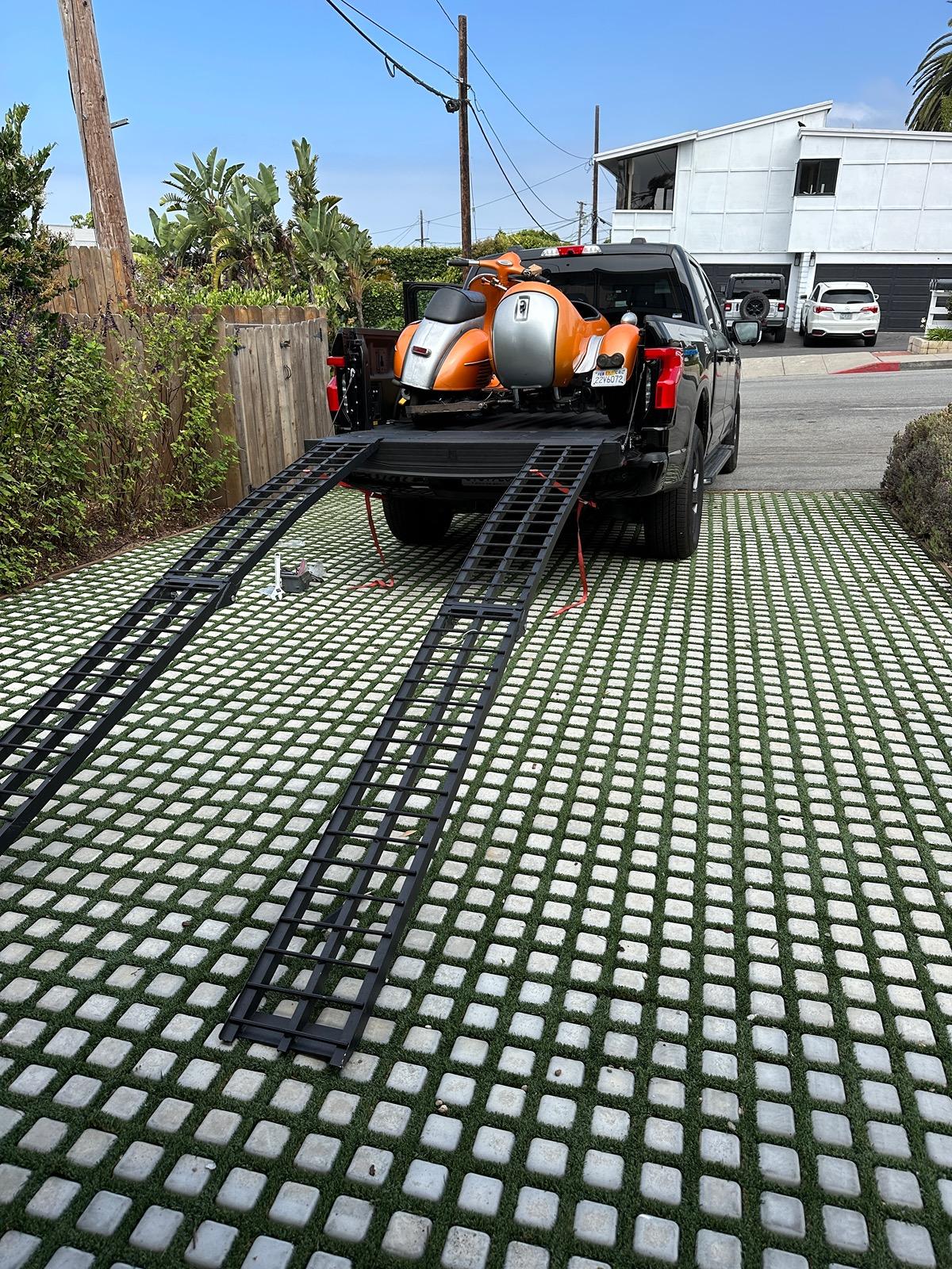

About to haul my scooter.
Have a set of ramps and winch (120v) to load one man: avoid Darwin Award/YouTube video clip.
Short bed Requires hauling with tailgate down.
Power tailgate.
Easy enough to disable in vehicle settings.
However: every time I shut off power, it reactivates itself?!
If I wanted it active, I’d… well… activate it.
An activation when going down the road could cause serious damage.
An activation when loading could hurt someone (me!)
I’m miffed.
Is this a glitch with my truck, am I not saving the setting somehow, or is some Ford product manager just that much more knowledgeable about what I want my truck settings to be?
thanks!

If you turn your front wheel to the side and then pull scooter closer to front, will the scooter fit?
I wish that was the case.
Pics give better impression on space than reality - but perhaps some form of ramp or lift, + turn of forks, might get me home.
Worth a second look anyhow.
Tks.

A seven foot long 2x4 under the scooter wheels will put enough downward force on the tailgate to keep it from bouncing and trying to close. A sheet of plywood under the scooter would do the same. It's a hacky solution, but it'll mean not having to worry about remembering to turn it off all the time.

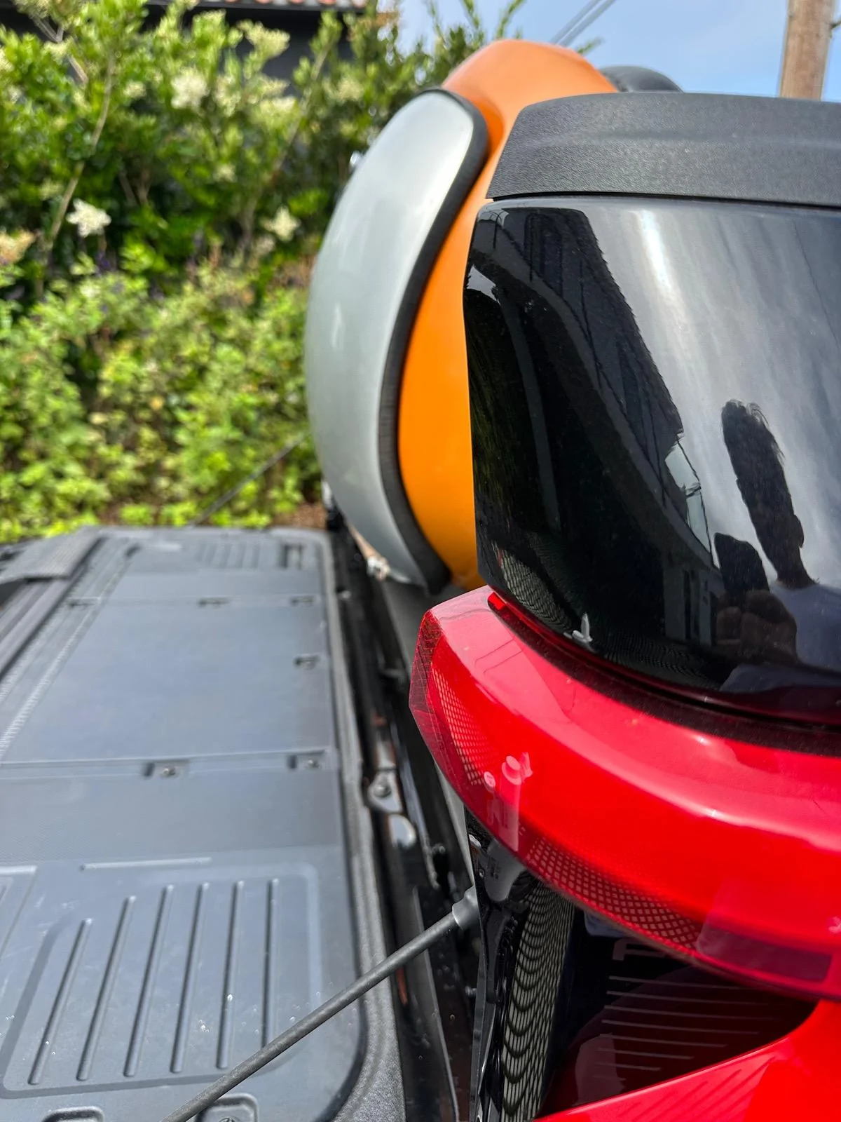

Just before leaving - having pulled away from the garage, the car wash, the store - all without remembering to turn off the power gate - so I doubled down.
Turned out BWTex called it - I just had to get extra aggressive with an angle.
Turning the fork didn’t quite do the job - but it was a step in right direction.
lifting up the tail and dragging the scoot to an angle with the front tire in the corner, and the sidecar tire slightly up on the wheel well- allowing it to clear the tailgate by 1/4ā€ when closed.
to avoid damage when driving, I put a block of wood between tail gate and scooter sub frame - pinching it as the tail closed.
shoulda shot a picture of the scooters rear fender spaced off the tailgate .25ā€.
did a bit of testing. Decided it was secure and unable to impact the tail of justled- and off I drove.
