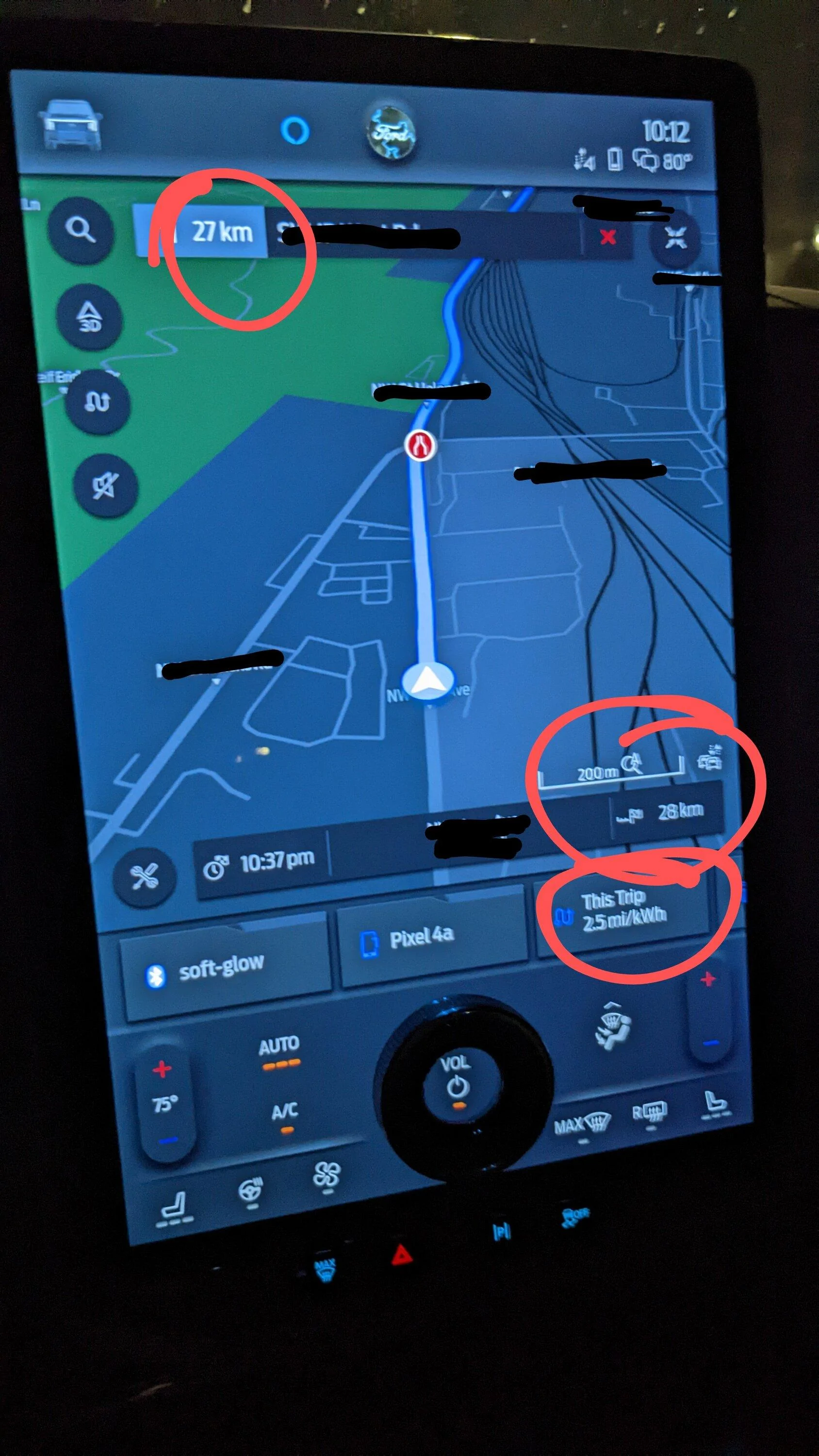

Here's a new one- after 3.4 my Nav measurements are in metric, and yet my efficiency is still in imperial... I can't figure out (yet) how to fix it. When I go into Settings, it shows that I do still have miles selected as the measurement ?
Same issue!

Same issue!
It's so odd to me that seemingly unrelated Powerups are making changes like this. At least @Ford Motor Company confirmed the reset of 1PD mode with this update, but given this update changed the 1PD settings/calibration, that makes a little more sense to me.
FWIW the suggestion of toggling the settings from mi/kwh to km/kwh and back again fixed this for me.
