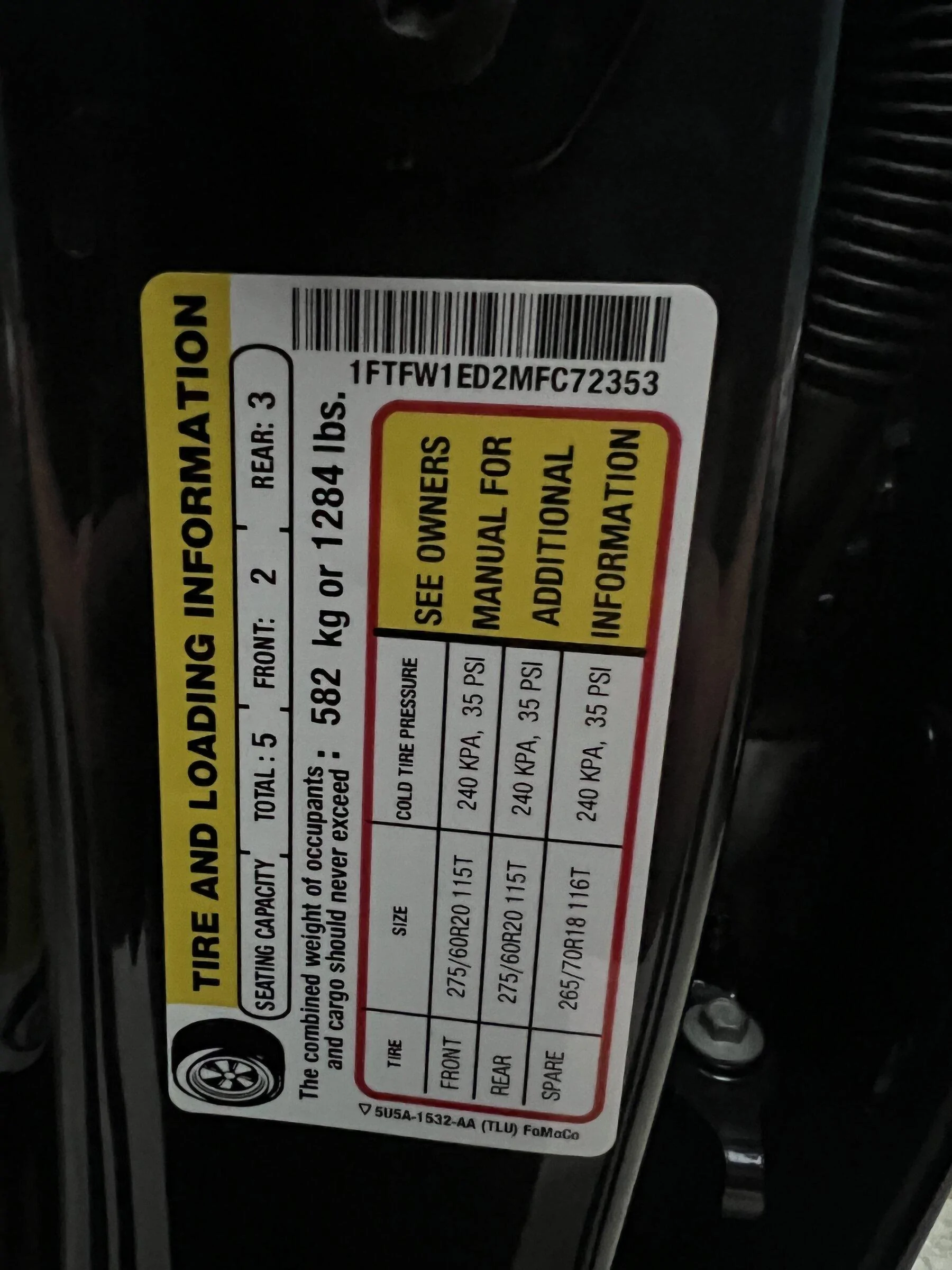

Every option except the factory tonneau and I’m sitting 1284
Looks like it! That must be some truck!
You have 6.5' bed?
By the way, according to Ford that extra foot only adds 21 lbs to curb weight.
They claim 25 lbs for the tonneau cover, so there's 5 lbs missing somewhere. ??

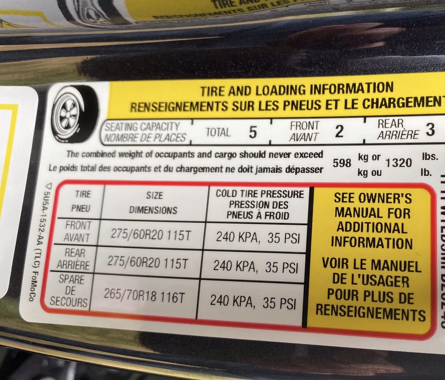

Truck came in at 1320 without the tonneau cover and only the 2.4 system with tow mirrors and no bed liner, pretty much everything else though. 6.5 foot box

The 25lb tonneau cover is described as "Soft". The list doesn't include them all and I suspect the official software program that determines the yellow sticker print job is more granular than the document we consumers have.
