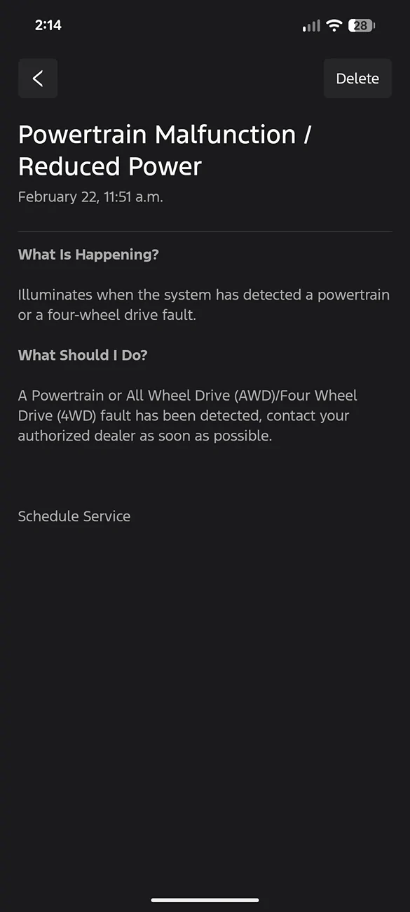

Ford F-150 Lightning Powertrain Malfunction / Reduced Power caused by air dams Screenshot_20260222-141424

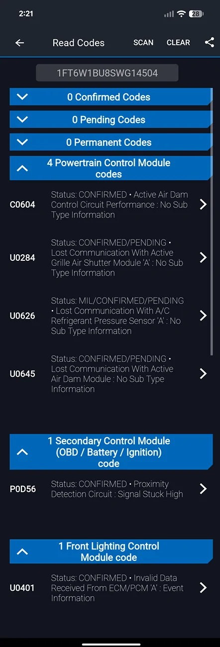

Each time that I got this error, I plugged in my ODB2 reader and saw that there were error codes related to the active air dams, A/C sensors, etc...
Ford F-150 Lightning Powertrain Malfunction / Reduced Power caused by air dams BlueDriverScreenshot
Back in early January I brought my truck into the dealership and they said that the issue was that the air dams were frozen.
According to them, this then caused the other error codes; they said there was nothing wrong.
Is this normal or are they trying to brush off an actual issue?
So far I haven't had any issues with performance or charging, but I just want to be sure I didn't get a lemon.
I feel like a truck should be able to handle cold weather better than I've experienced so far.
Don't get me wrong, it handles really well in the snow and ice, but if the air dams which are at the front of the vehicle can't handle cold temperatures, that's kind of crazy.
