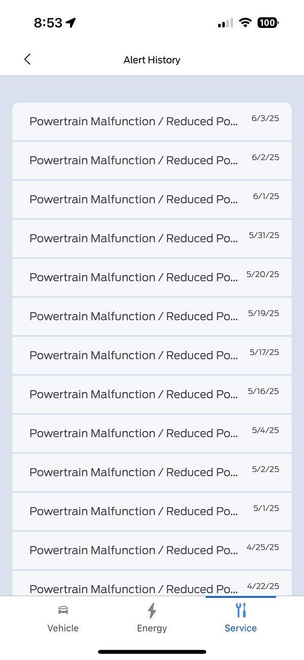

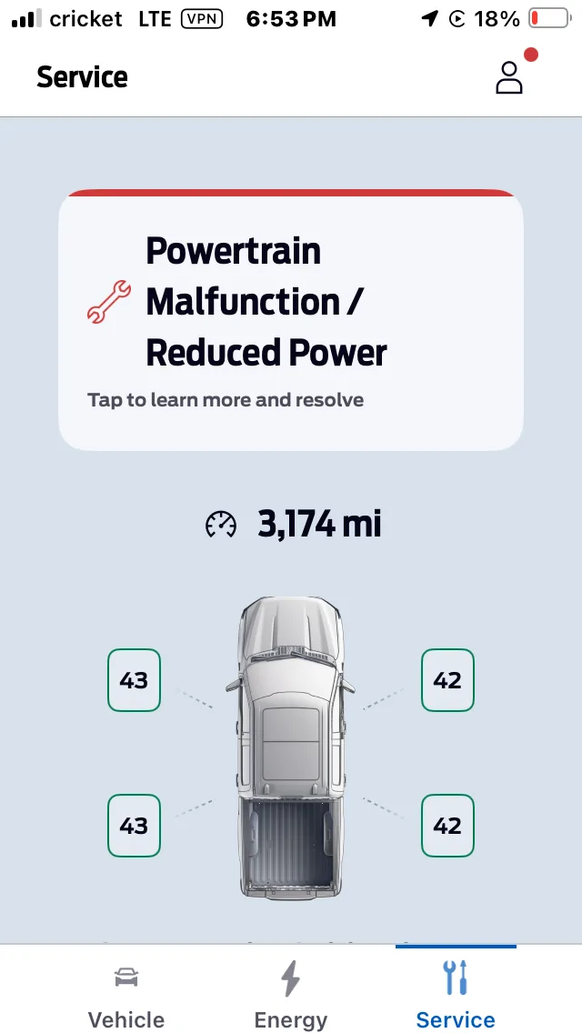

Ford F-150 Lightning Powertrain Malfunction/ Reduced Power IMG_0179
Ford F-150 Lightning Powertrain Malfunction/ Reduced Power IMG_0153
Very likely yours is also the shifter - I swapped mine out for a rotary dial 3 weeks and 3k miles ago and bada-bing no more errors!

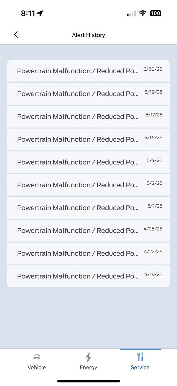

There is a "pseudo" recall on the shifters (CSP? Customer Service Program or something like that). After a bit of negotiation I got my local dealer to swap it. Of course the parts are on back order! The "magic date" (I think) is a build date of 10/18/24. My truck's birthday is 10/10/24! After that they reportedly fixed the shifter issue.
Anyone understand why a shifter issue would cause the dreaded Powertrain Malfunction?
Ford F-150 Lightning Powertrain Malfunction/ Reduced Power IMG_1556
