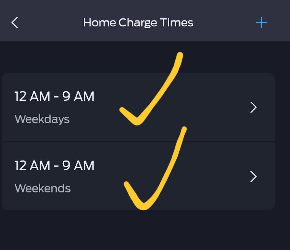

Originally I had Anytime as my time frame to charge, so I edited them to midnight to 9am.

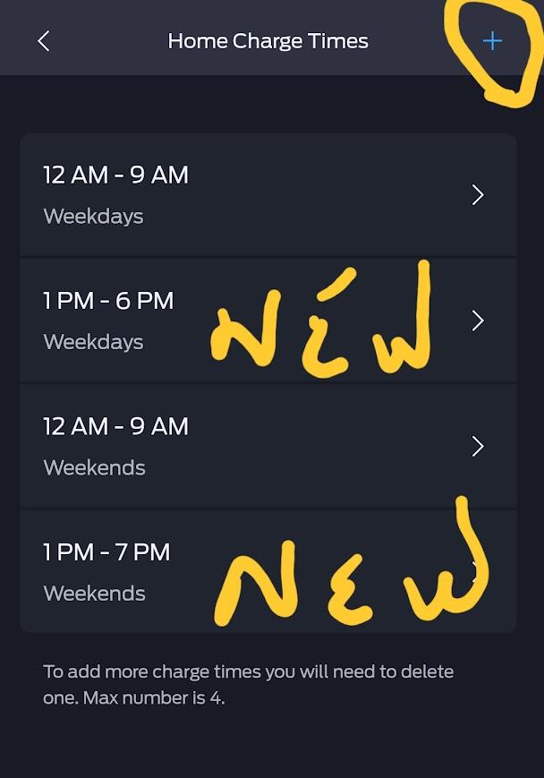

Then I added two more schemes for 1pm to 6pm weekdays and 1pm to 7pm weekends.
Ford F-150 Lightning Pre Departure Conditioning on App does not happen 1728523078194-tx
This is all for the times frames only, if you need a higher SOC for special occasions, then you'll need to adjust it in the Target Charge section.

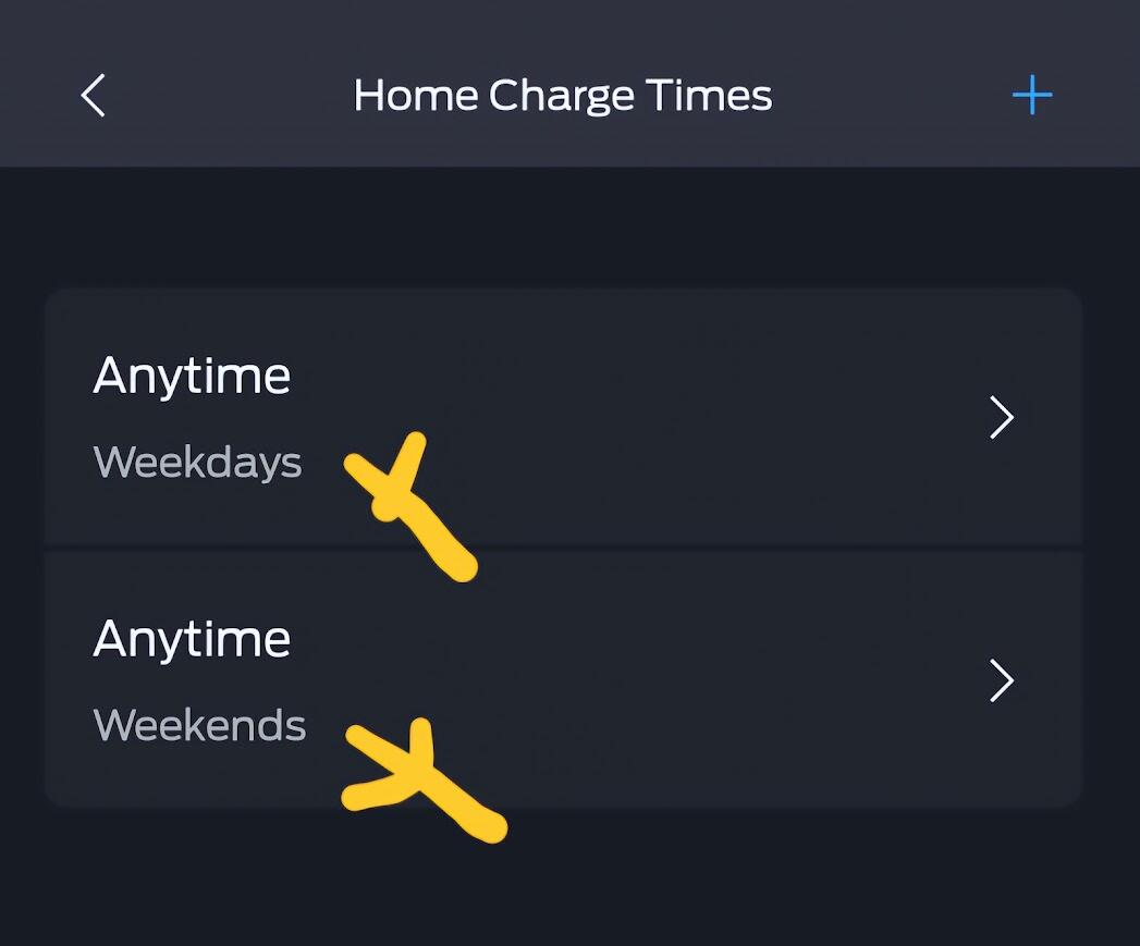

How did you select "Anytime?" I can't find that option
When picking your time frames pick 1200am to 1200am that's interpreted to be "anytime"
use the DELETE button to erase constrained times and restore to ANYTIME

I had to delete the 12AM-9AM charge times to get "Anytime" charging so it is one or the other

When I select 12 AM -12 AM this is what I get. I accomplished this before I changed it to 12AM-9AM but now it gives me this attachment.
Just discovered another fluke, but it's fixable, by using the DELETE button while editing the scheme. It will take extra time to SAVE to the cloud, and you will need to back up two menu levels to see the changes posted when you go back to the details screen.
In the truck SYNC screen we have a DELETE [time frames} button this is effectively the same and restores the ANYTIME condition
