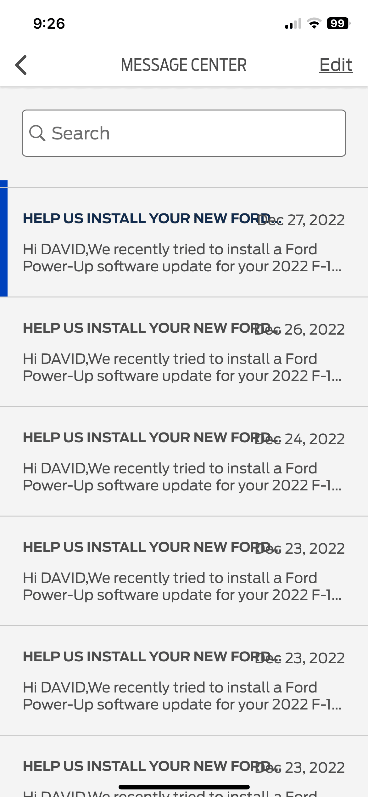

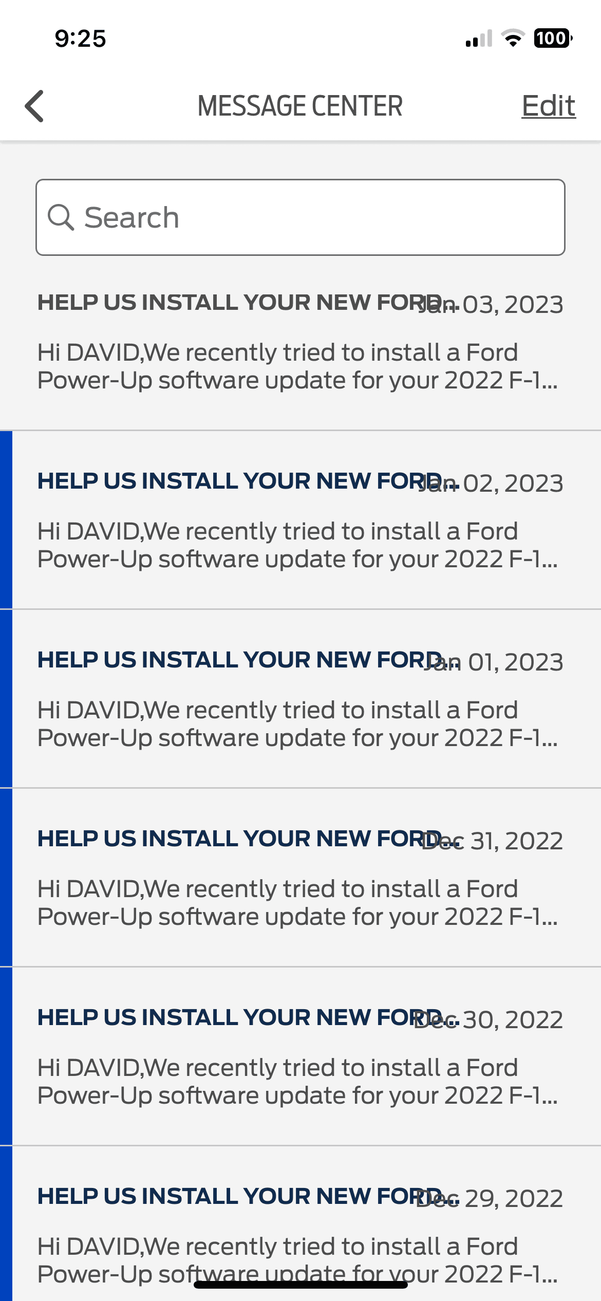

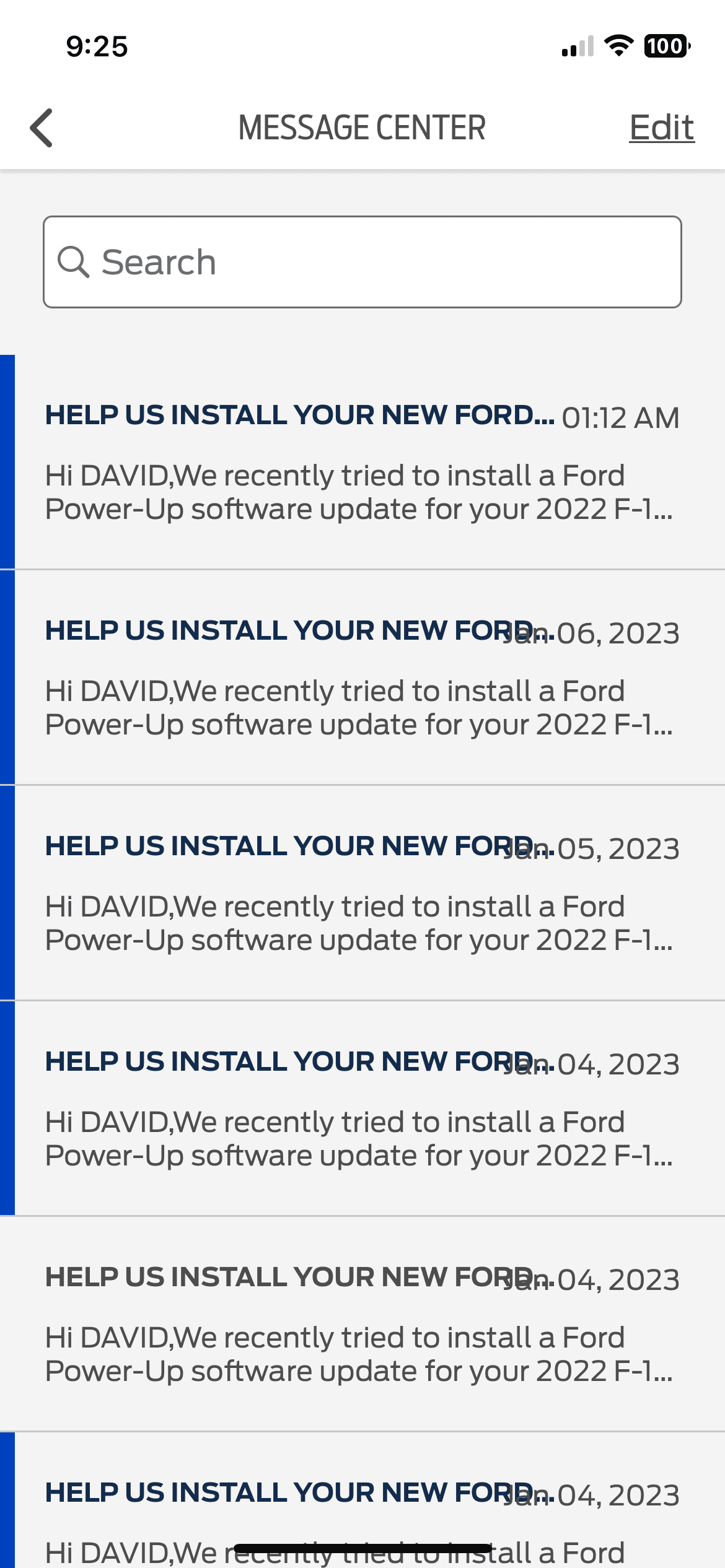

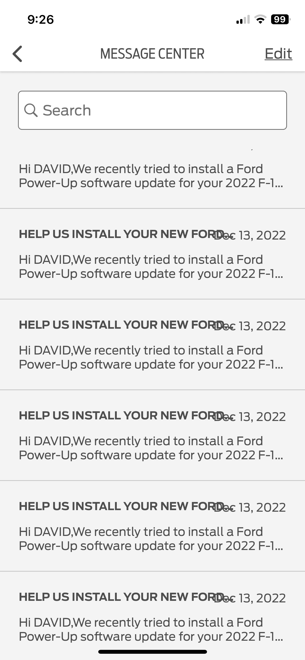

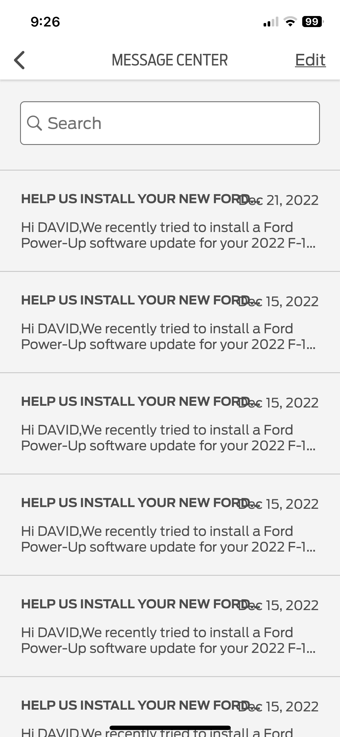

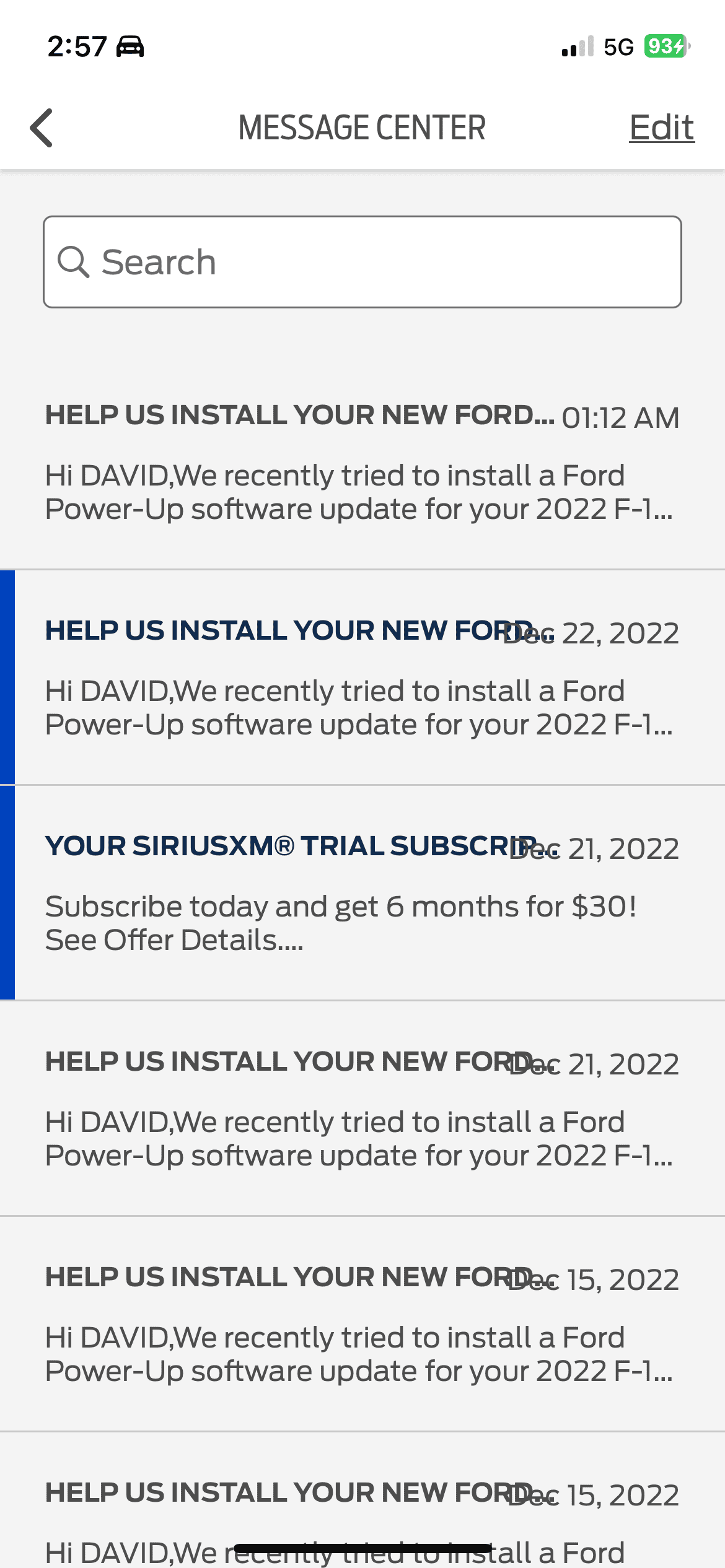

I am unable to get the update to install. Each time it starts the countdown, Preparing the Update which runs for a few minutes then the screen will go dark, I hear the modules clicking, and receive an error in the App a few minutes later.
First update that I have had issues installing. Any Suggestions?

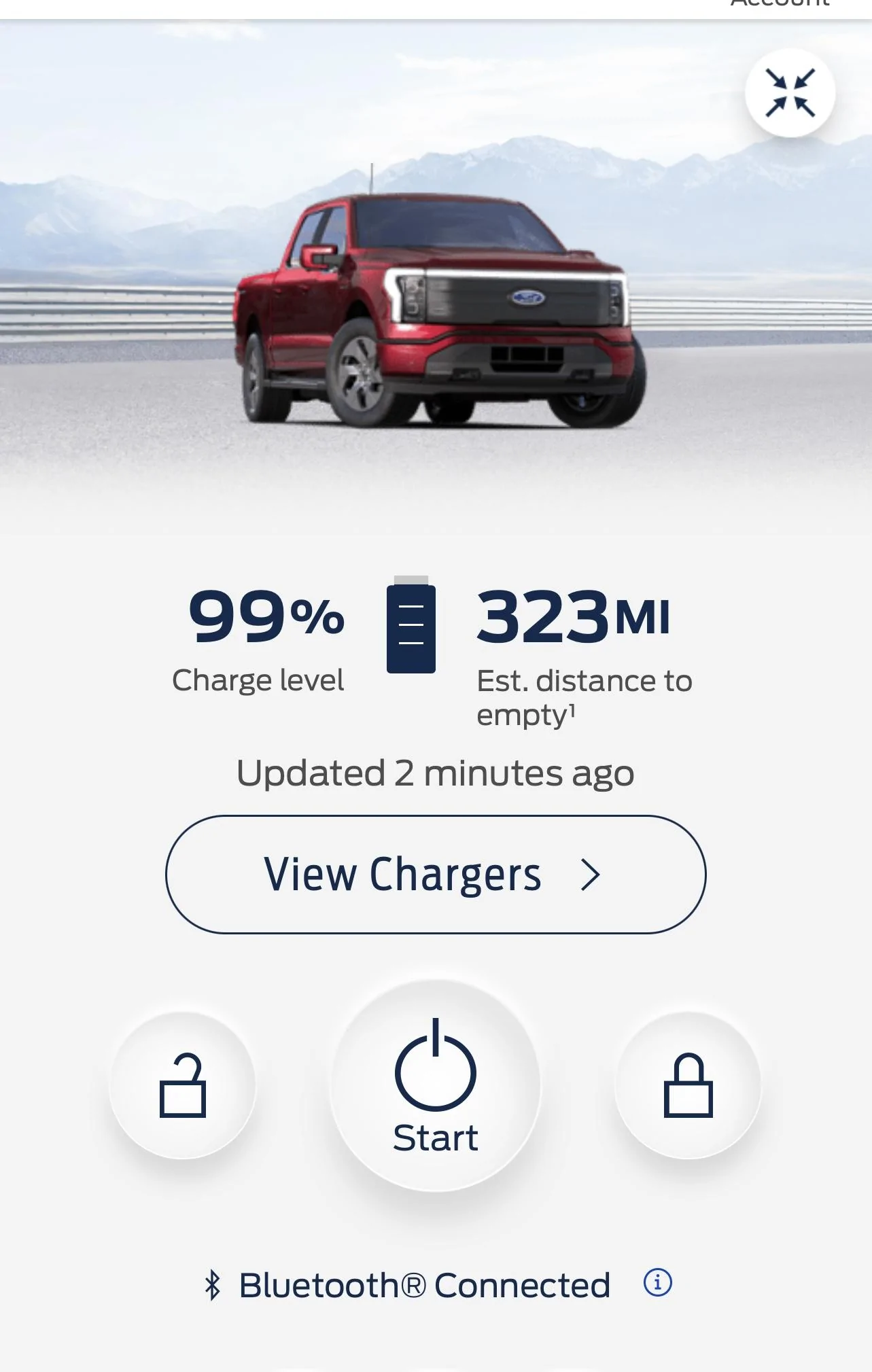

Believe or not I just got it to connect to Wi-Fi. It failed adding to my Ford Pass but at least it’s progress.
It's a miracle! After trying for a week it all came together in a matter of 30 minutes. I just connected it to Ford Pass.

Mine also will not update. Continually tried 5 or 6 times and every night and fails every time.
