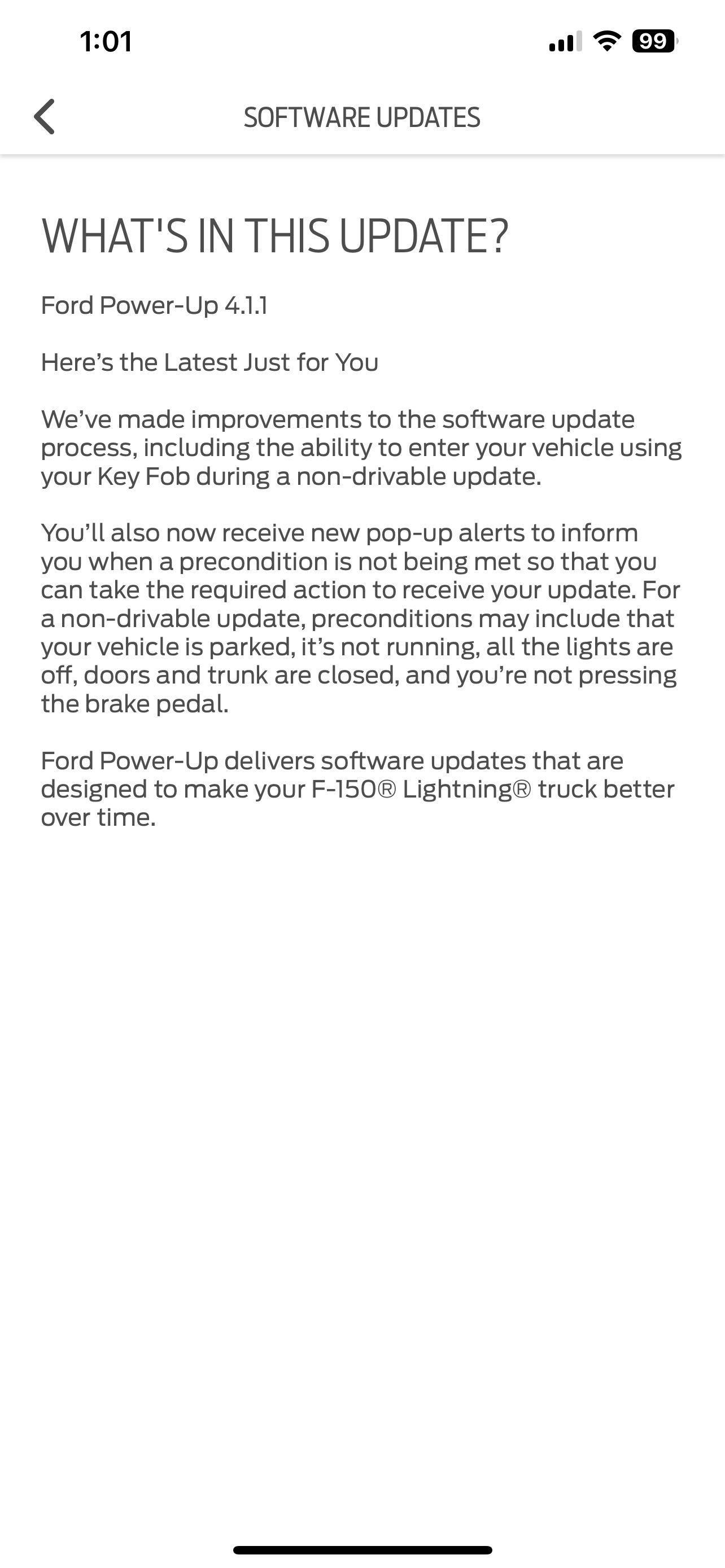

The day after I got the distance to empty update (finally, 26 fails), I got this update. Maybe it will help with future update fails?

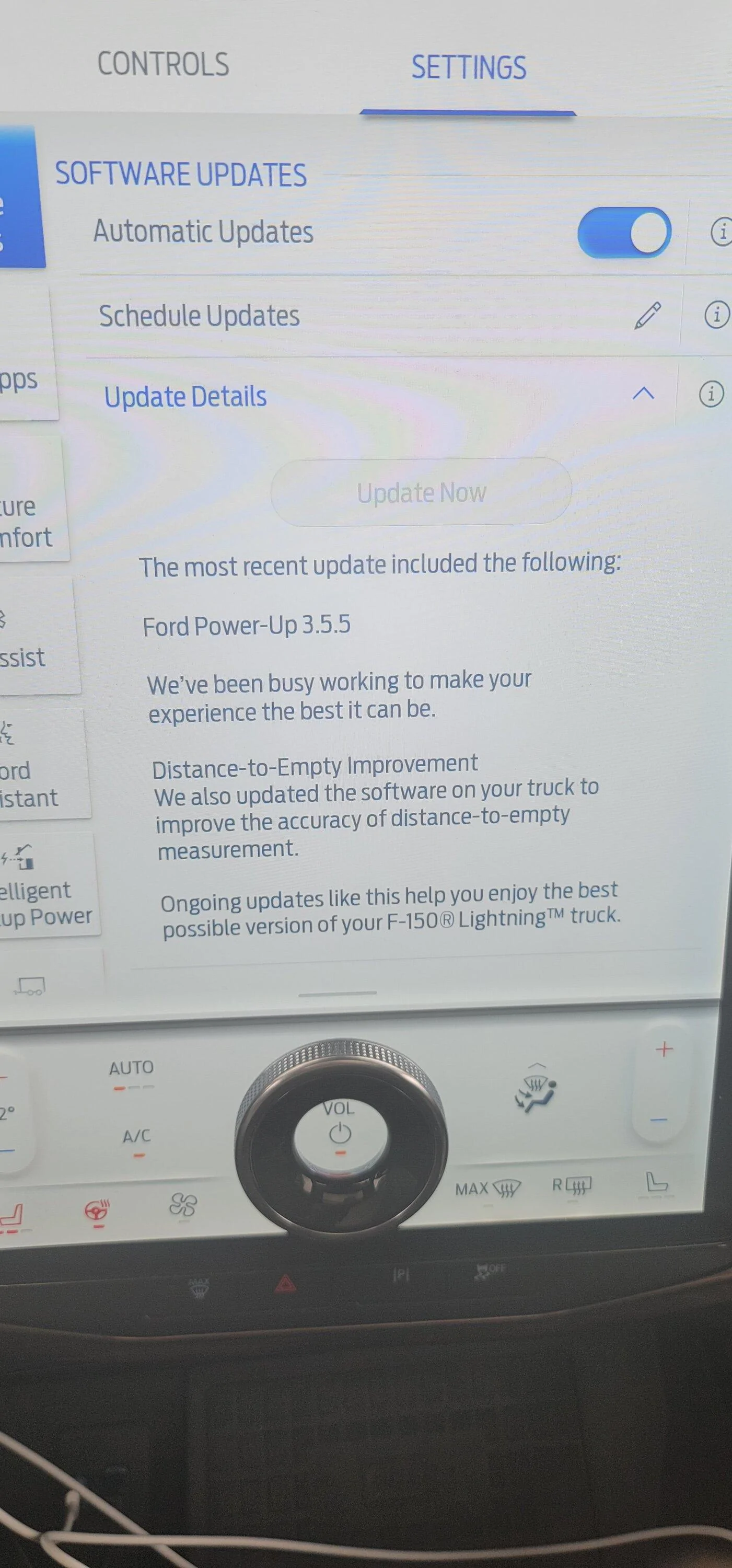

Look what I got today!
Ford F-150 Lightning Priority Update: 22-PU-1009-MIL-DTE Calculation 20230207_105526
Noticed a download after a short drive and it installed on the first try :)
Welcome to December !! LOL. Maybe you'll fly through Jan and Feb pretty quick. Once the dam breaks it seems they'll come every other day or two. I guess enough time to get one installed and report back to the mothership.
