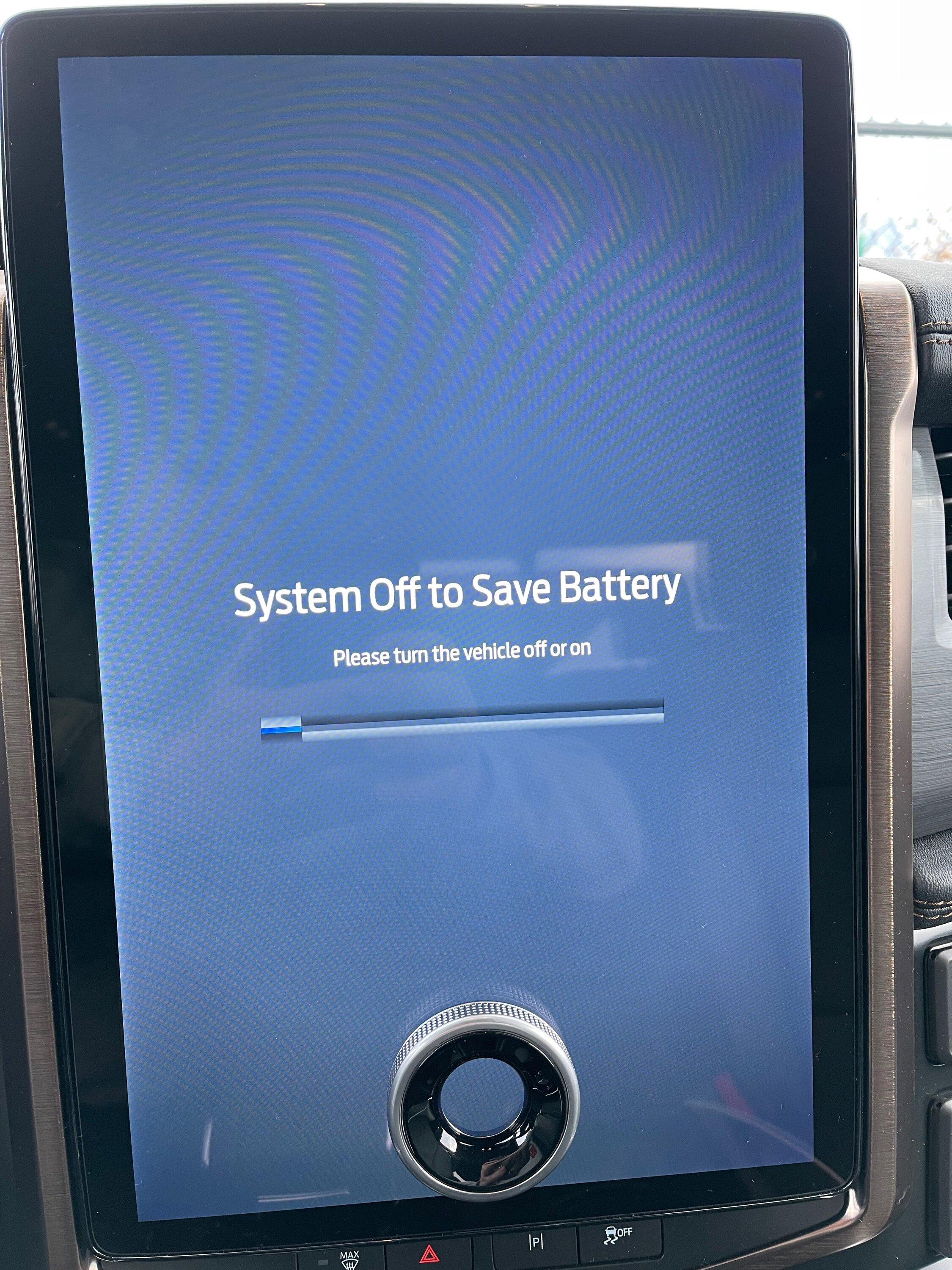

I did the BMS as stated above, unfortunately that has caused some unwanted side affects.
1. The big center screen and the dash screen now don't come on when opening the door.
2. A different splash screen now displays with just the Ford oval.
3. When you turn off the truck it doesn't go into accessory mode. It just shuts down everything and the center screen displays this:
I tried doing a sync reset and it didn't change anything. And as a final note, the update still did not work. If anyone has any ideas to get things back to normal I would appreciate it.
Your 12V battery is very low in SOC, the BMS reset likely just aligned the system better with the reality state of the system. Disconnect the negative battery cable to reboot the system and then once it's reconnected, start the truck and turn off the shutdown timer. Let the truck run ("idle") for at least an hour. This will guarantee that it charges the 12V battery and better calibrates the BMS.

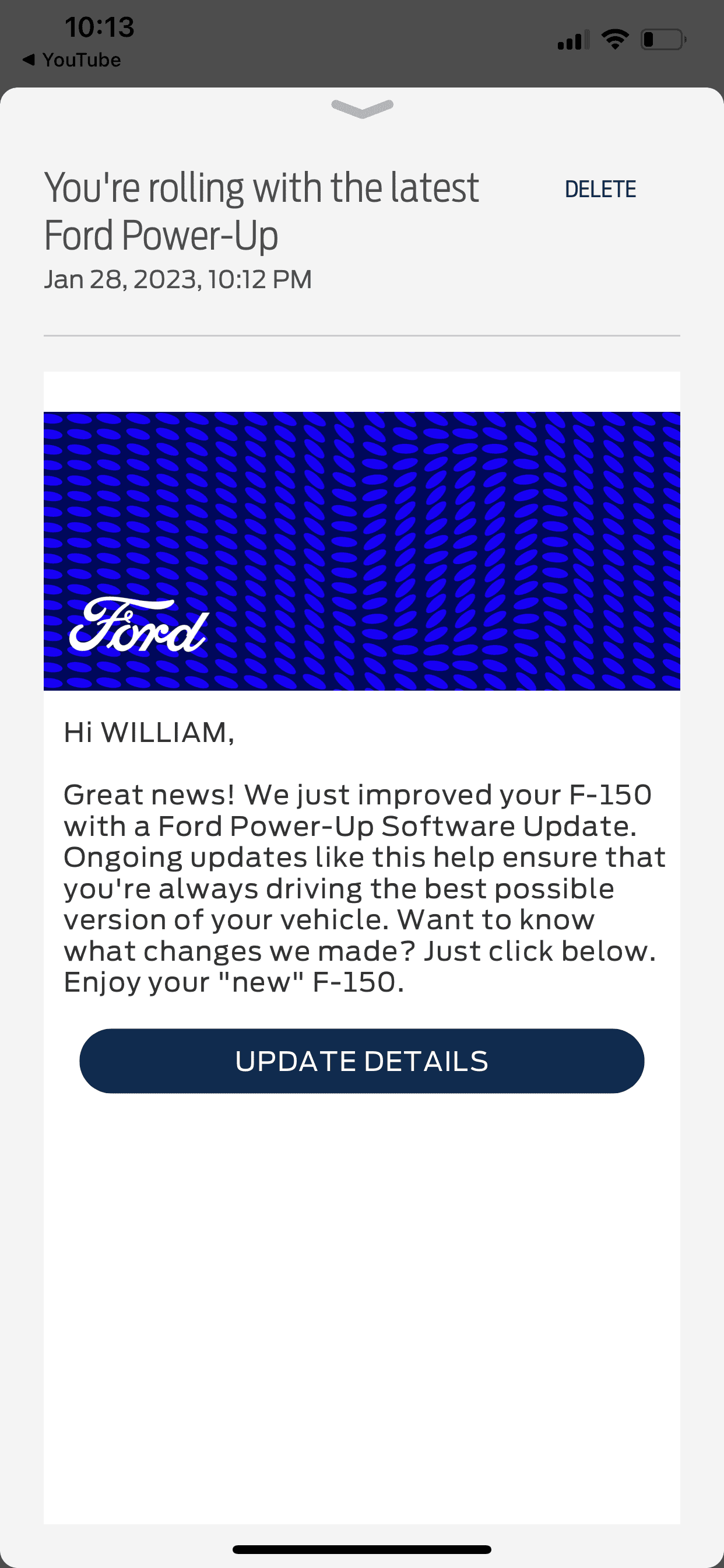

I just did the combo of resetting the battery management system described in 262 and then let the truck run for an hour with the lights off. Told it to update (manually) when I got back to the truck that had idled for an hour - worked!
