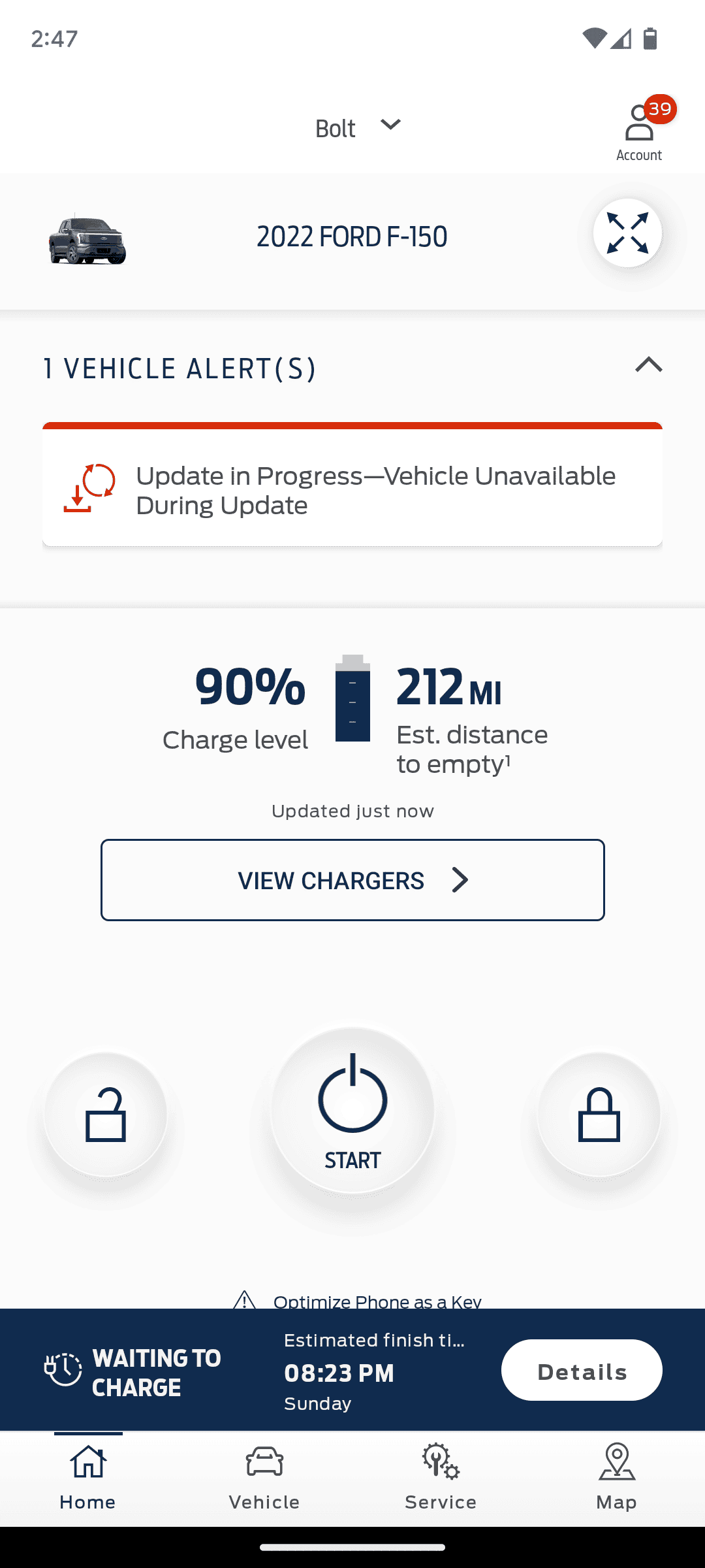

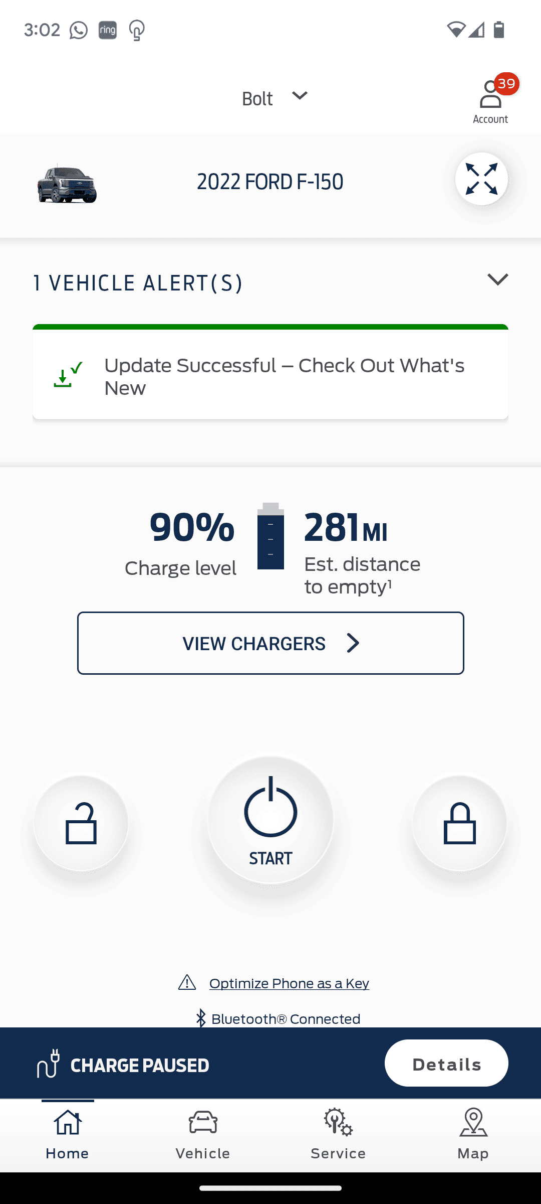

Tried one more time without the LVB battery reset, while hooked up to the charger. Not sure what happened but now the app shows it's updating... fingers crossed!!

Thank you!! The battery reset worked! After the reset, the SOC via OBD was at 92. Update pushed through. Now, looking forward to the other updates.
Thanks again!!
