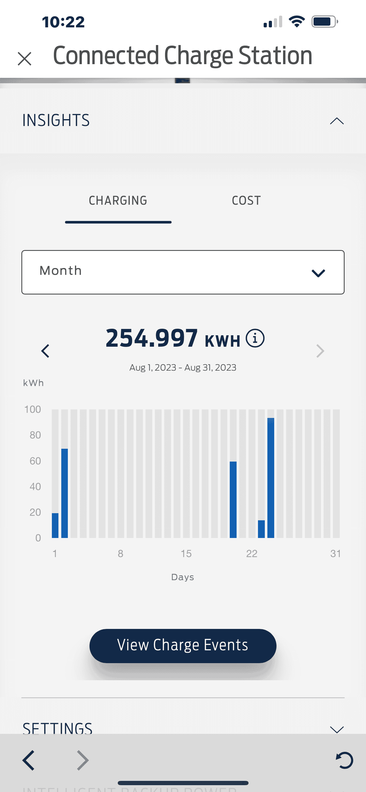

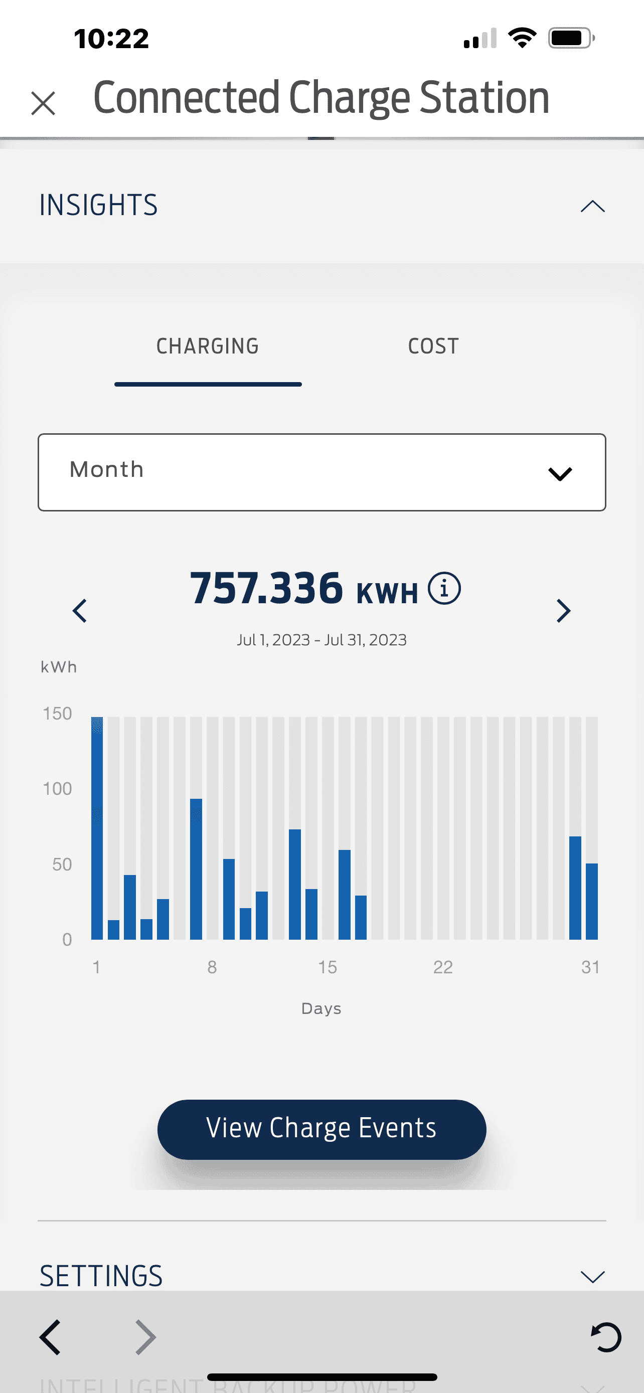

Had my charger installed in may but have had internet connection issues since the beginning.
it randomly disconnects and doesn’t update my insights when it reconnects.
this is a company truck and this is how I get paid for my home electric usage.
internet isn’t an issue as the router is less than 11’ away and signal is strong.
see the gaps in the attached pics. There’s a lot of gaps not tracked and it’s impossible to get an accurate picture of usage.
I would think the charger would store and update when connected but this is not the case.
thinking about just installing an external meter at the j box below the charger that I can manually record usage.

When you look at these screens do you see what I have?
On occasion it will fail to connect to cloud database, when that happens I power cycle the FCSP, wait 5 to 30 minutes and communications usually are restored and some times missed record will post, though over the last 11 months of operation I've had several lost sessions.

Yes sir. Except when it’s not. It seems to not be able to reconnect on its own. I read another post that suggested shutting off the breaker and resetting it which seems to help it reconnect. But that’s only when I notice it has disconnected.
hopefully this gets resolved soon but if not I’m going to have to add a meter in line so I can do a better job of tracking useage.

In my experience, the Ford Charge Station Pro and FordPass power reporting is currently broken (meaning that it is of little or no possible value to anyone). The two issues that I see are:
  • The FCSP reports the entire charge session as power used in the hour that the truck was unplugged. So (for example), if you charged at 19.2kW from 11pm yesterday to about 12:30am today for 30kWh total, instead of reporting 19.2kW in the 11pm-midnight hour and 10.8kWh in the midnight-1am hour, it reports 30kWh in the 7am-8am hour when you unplugged the truck. How is this useful to anyone for anything?.
  • FordPass can use the charging data from the FCSP to compute cost to charge the truck. However, FordPass only supports a single rate -- so the cost calculation is only correct for users who have a flat-rate plan. People who have time-of-use or EV-specific plans have no ability to put in different rates at different times -- and even if they did, the charge session reporting data from the FCSP means that it would be calculated in the wrong time period regardless.
