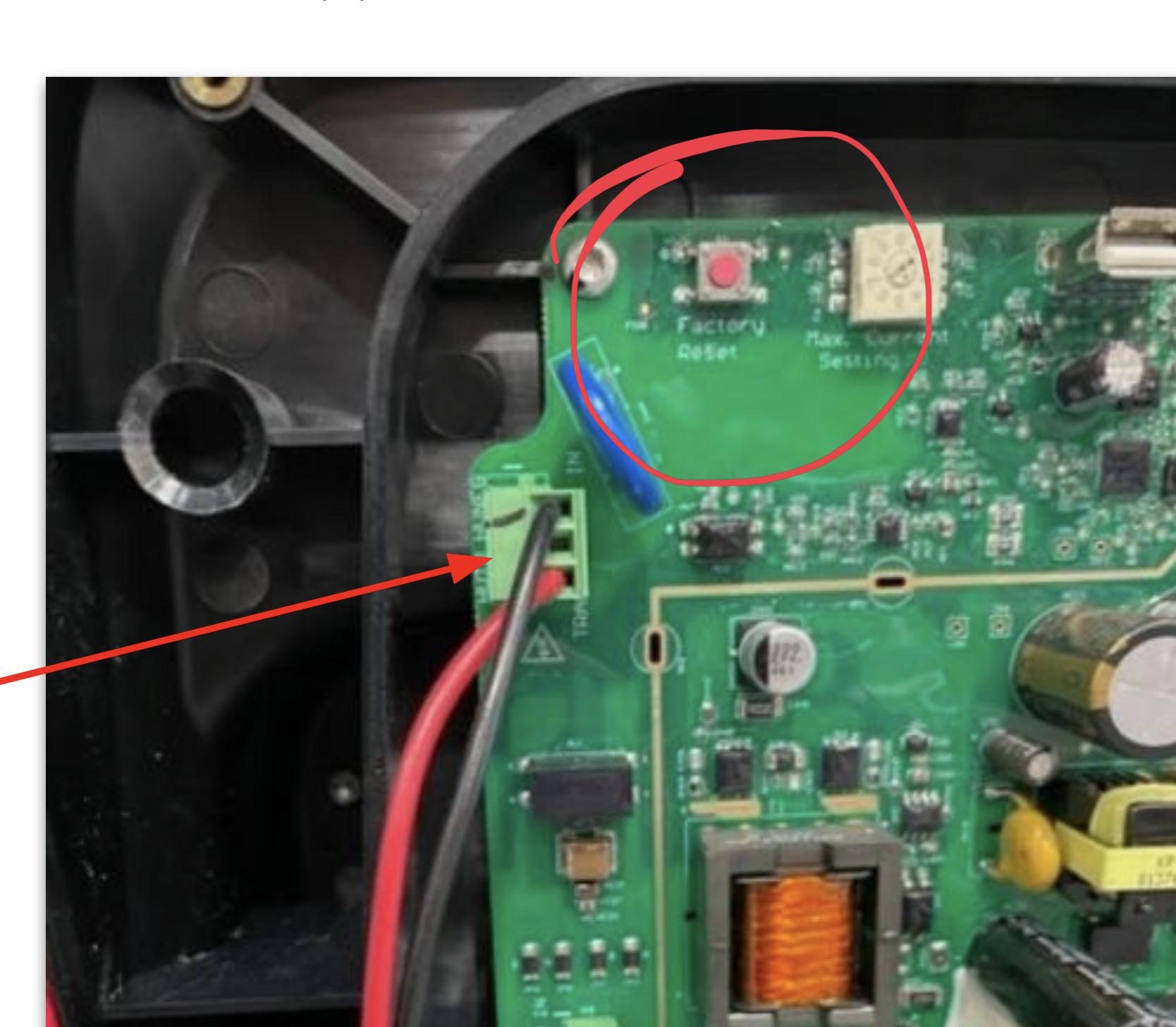

I’m currently at an impasse with Ford on my CSP. I spent four weeks trying to get someone to help me and finally got a “level one ticket number” with a technical department that I assume is at Siemens. Very frustrating! The SSID not broadcasting. I’ve read something above about a factory reset button. I’ve looked everywhere and can’t seem to find this red button. Can someone send me a picture of where this is? No one has mentioned this yet at Ford nor have they given me the list that someone has provided above that I will follow once I get the location of the magic button.

Remove the cover and it’s on the upper left hand corner. Ignore the red arrow that is something else.

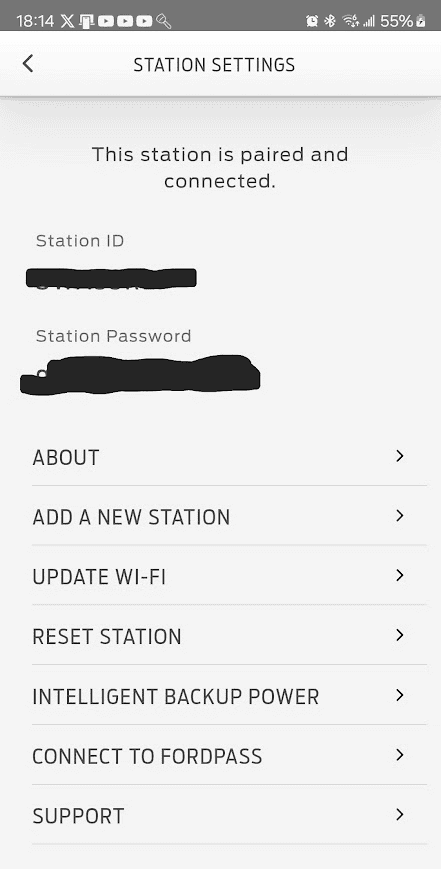

Yes, you have to go into the FCSP Setup App (not Fordpass) and use the Manage Settings option then "Reconnect" when the app can't find the FCSP, you should be able to reconnect to the FCSP Wifi and reconfigure the wifi settings based on your new router/network. I found that you have to be standing right next to the FCSP to find its broadcast network.

On your next try, just join your cell phone to your local wifi network, then using the set up app simply MANAGE SETTINGS [log on] SELECT & CONNECT to your FCSP, find the menu option [CONNECT TO FORDPASS] to finish registering the device to your FP account.
