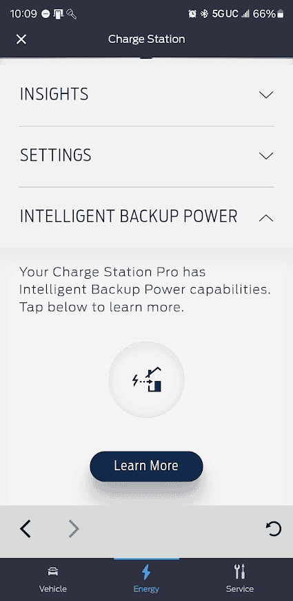

Right, but that's what I also see as a functioning FP user w/o the HIS equipment, so curious if you will be successful or not.
Oh so those screens are from within FordPass?

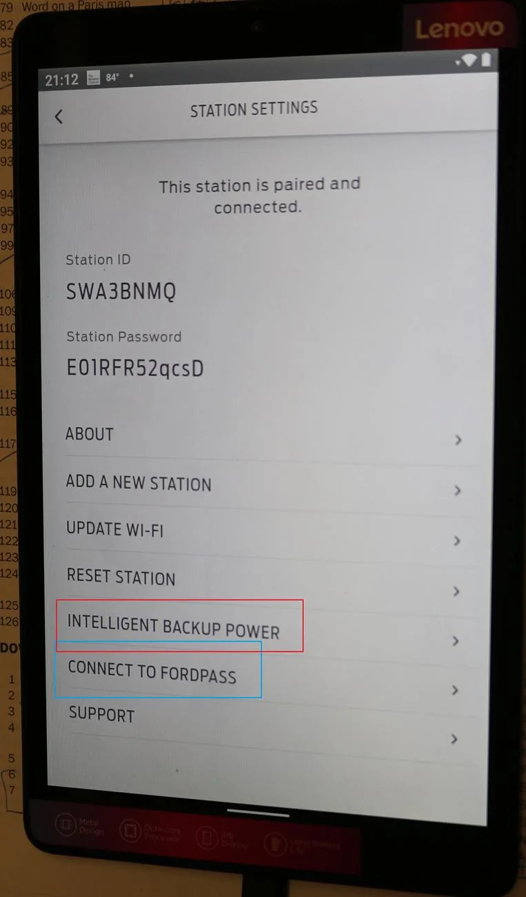

I have this one from the FCSP setup app "STATION SETTINGS" screen:
Ford F-150 Lightning Charge station pro Ford Pass connection issue IMG_5639-connect to FordPass 1
Which leads to the missing equipment screen.

FCSP has WiFi connectivity only.
I know, wish is had a wired/plug-in RJ45 connection to my network, much of the initial problems seemed to be not broadcasting and/or not detecting the wifi from the FCSP.

If you haven’t yet, download Ford Pass and Ford Charge Station Pro set up apps. Start and set up Ford Pass. Run FCS set up. Tie into the same wifi networks for your phone and FCS. With phone beside FCS identify strongest signal. Consider a wifi extender if signal is very weak.
Good luck and keep trying.
This is what I had to do. The app is worthless after to connect it to FordPass
4,449
5,987
Mine never once broadcasted the SSID. I had to key it in manually in order to set it up.
Mine eventually did after I opened it and pressed the red RESET button on the top left side of the circuit board.
It must just broadcast it intermittently, after the rest it took a while (a long while, multiple minutes) before it showed up on my tablet's detected networks.
It has been a real pain in the butt to get to the last step, I would make progress and then have to start over.
