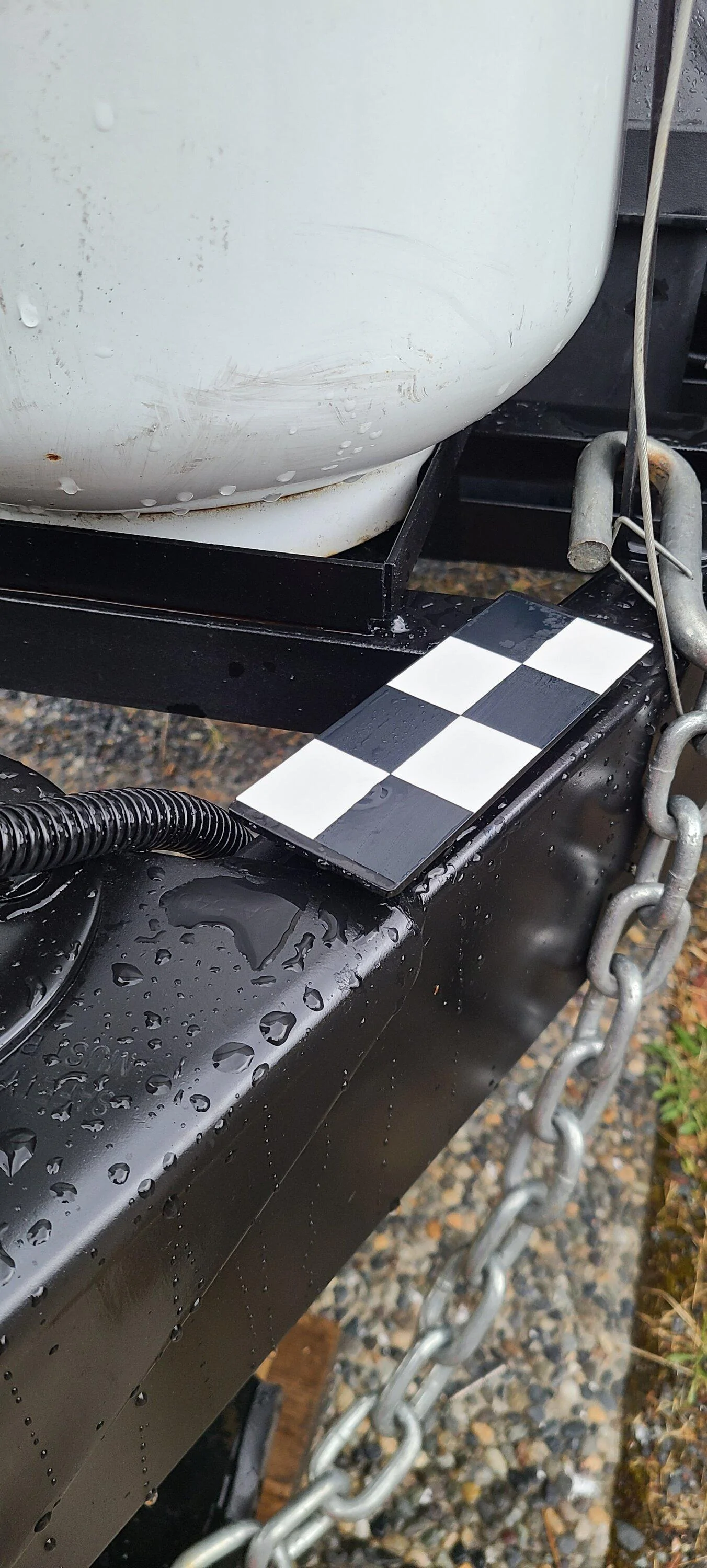

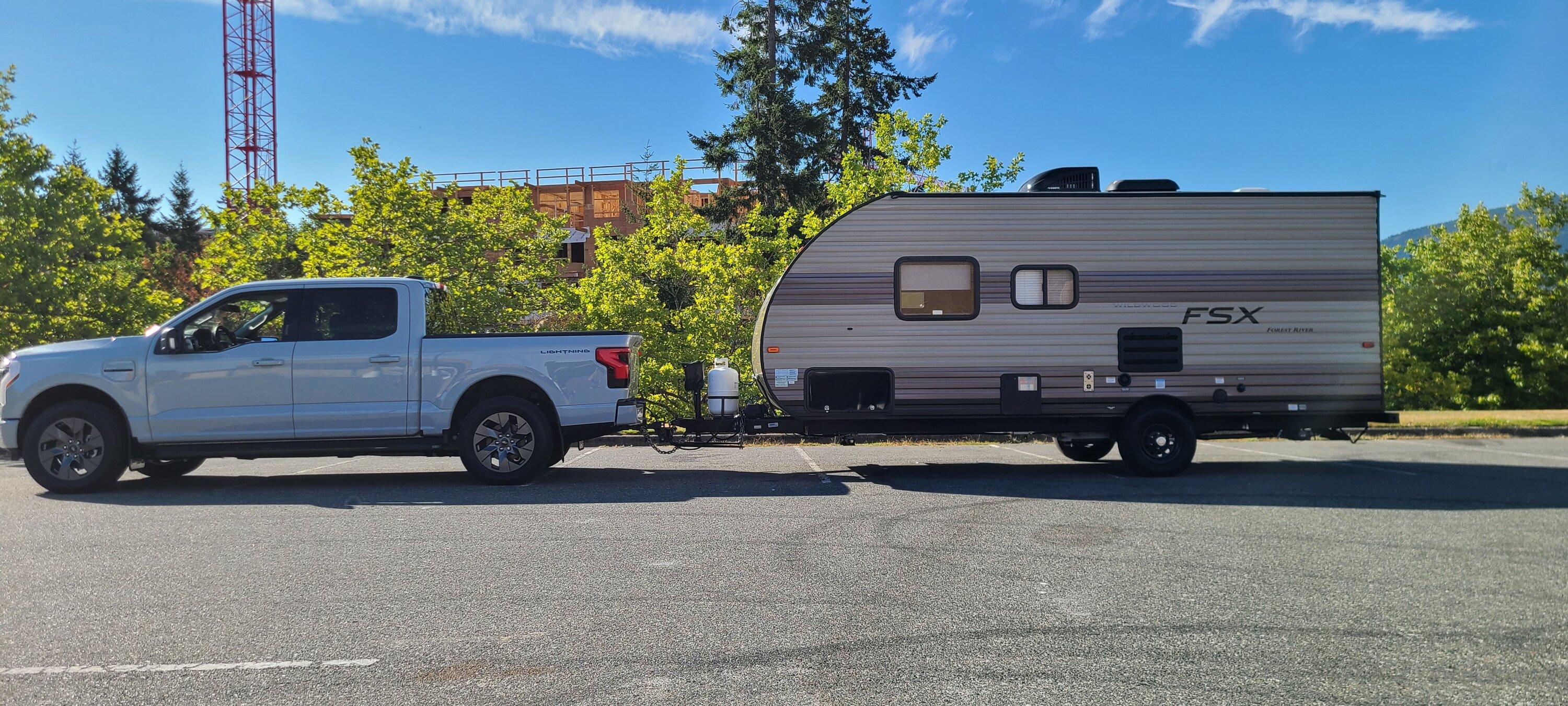

I got three stickers. My trailer tongue is short and didnt have a good flat spot to stick it so i cut a peice of 2" wide aluminum to length, drilled and countersunk for stainless screws and attached it at about the 14" mark from ball center (after confirming the camera could see it there).
Took it for a drive as per instructions in the manual at an empty lot, and it calibrated on the third try after I learned how to keep my turns tighter!
I spent an hour learning how to use the dial, and must say I found it pretty nifty, but slow, and will likely use only backup assist camera and the good old over the shoulder method. I was able to put the trailer in a car spot with the dial though by the end.
