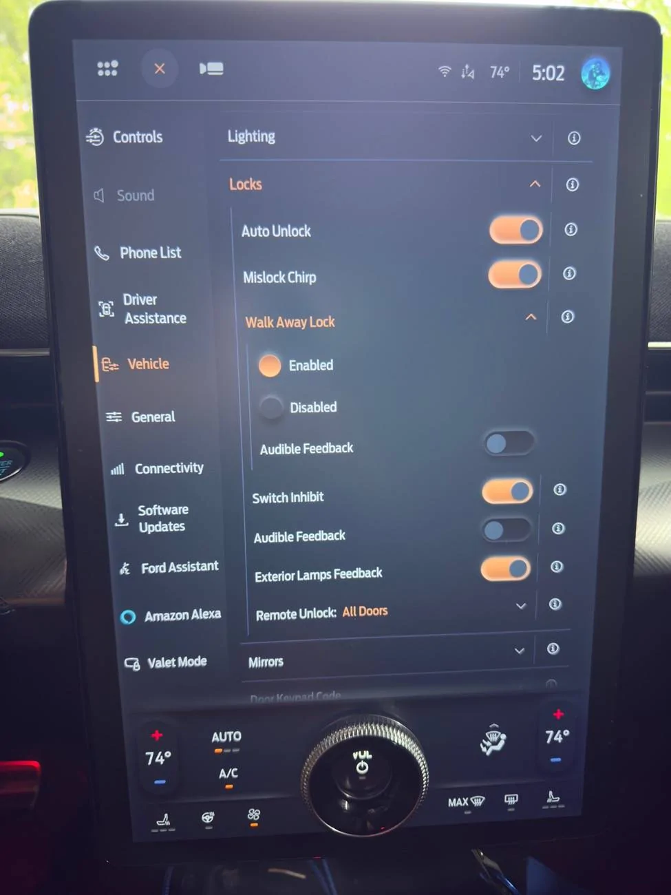

The missing control looks like this (from my Mach E):

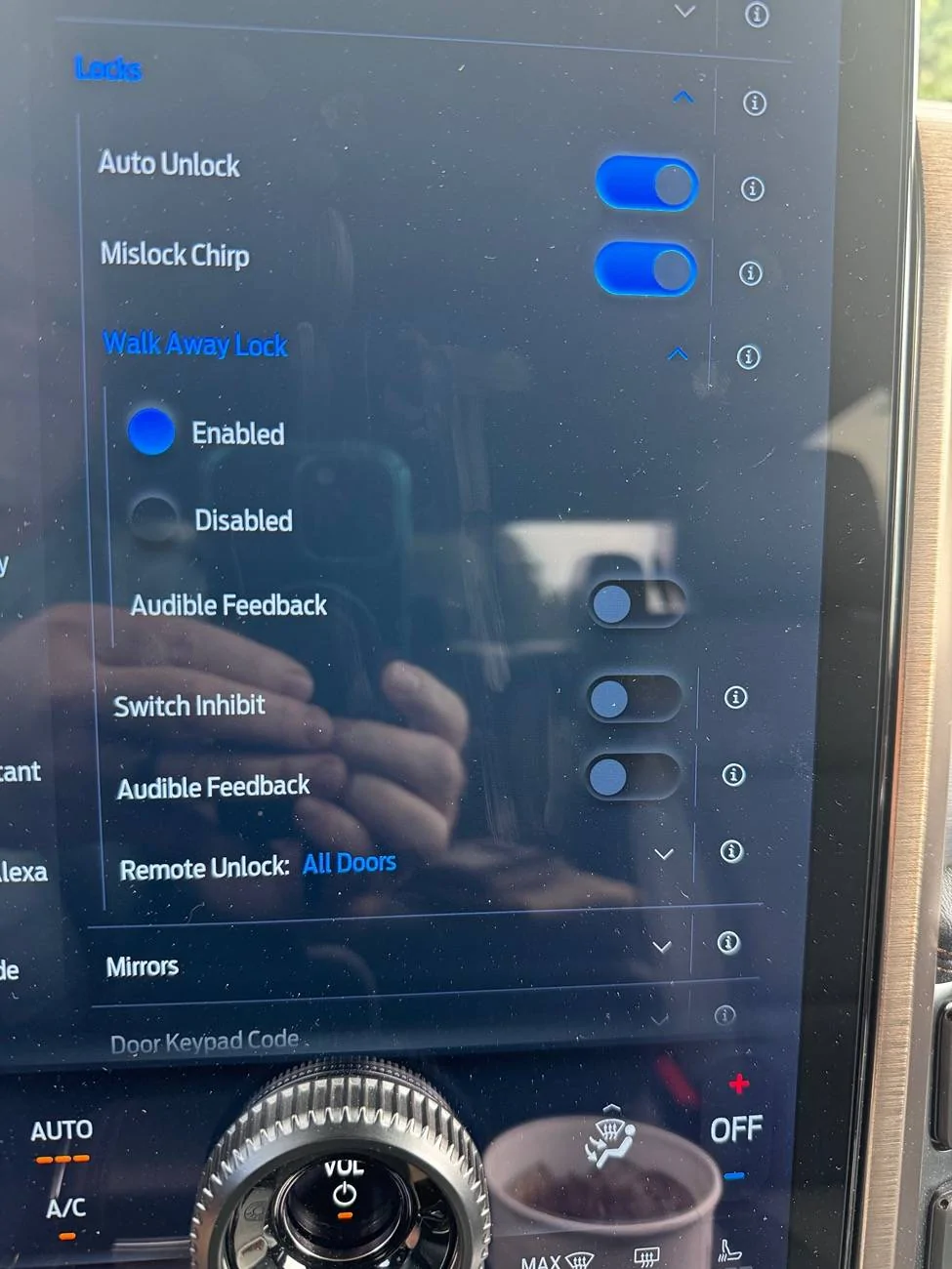

Don't know how, but it all survived. New Sync version 25094 (which I'd been really worried about with the news a month or so back), WAL settings still present and set correctly and WAL works like a champ still.
Maybe time to buy a lottery ticket. Oh wait - I did on the way home.
