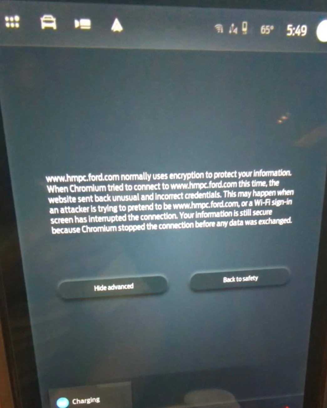

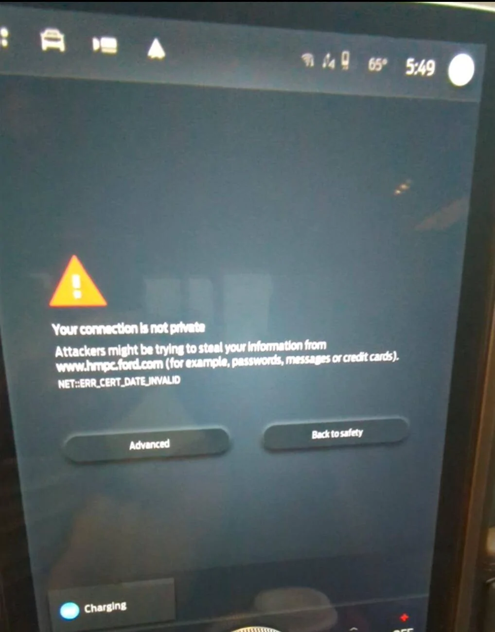

About to undertake a road trip and I hit the Public Charging app on the Sync screen in my buddies truck and this is what I get.
Ford F-150 Lightning Public Charging App Broken??!! 1000031704
It's cool, I'll click advanced and be on my way since they fired the interns that pay the SSL Certificate bill...
Ford F-150 Lightning Public Charging App Broken??!! 1000031703
Nope. F***! Is there a fix? A work around? This is gonna make this trip so much harder.

Oh, and I figured out the app. I had to disable auto time updates, restart sync, then re enabled auto time updates. The truck thought it was Monday so there was a certificate mismatch.
The app now works, but I can't use it while driving and without signing in with a QR code.
