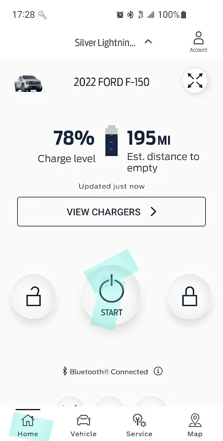

Lightning XLT owner for 4 days. Loving the truck, but questions, so thank you in advance for helping.
This question is about preheating the truck. I came from a Tesla and just had to open the app and turn on the climate.
In the Lighting, I go into the Ford Pass App, select Vehicle, the Departure Times. Correct so far?
I then choose the day/time I want. I also have Pre-condition cabin while unplugged checked. (so far only attempted this when not charging)
As an example, I set the Departure Time as 3pm.
So far, nothing is happening. Truck is cold when I get to it.
If this is the process, it is too difficult -- but I can live with it because I love having a truck again.
Am I missing something?
Thank you

Remote Start if you want it "now"
Departure time if you want it sometime in the future or on a schedule, departure time is - departure time - so the truck will start before that to make sure everything is warm and cozy by the time you've set.(assuming you also added "condition cabin")

I don't think the XLT has remote start capability. I wish it did.

I believe all trims of Lightning have remote start, make sure you have opted in all communications functions on the trucks Sync screen

Well, don't a feel stupid. Yes, I have that. I thought it was something on the key fob. Thanks for pointing that out to me.
