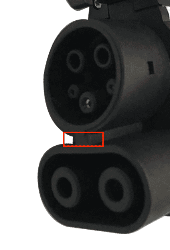

Can the Ford pro charger also charge non Ford EVs- specifically Teslas? If I were to get a Tesla later after installing the charger pro, can I just use a regular adapter or will the DC plugs that are used for the backup system somehow cause issues?
Possibly. There is an issue that the pro charger has the same form factor as a CCS1 charger. So, you have those two extra lower lugs that are used to power the house - and not for DCFC, whereas CCS1 is normally used for DCFC.
As long as you had a Tesla to J1772 adapter that had an additional notch to work around the small extra bit of plastic that goes to the CCS1 component, yes it would work.
Out of the box, it is physically incompatible because of that extra bit of plastic. Though, nothing is stopping you from filing that bit of plastic off - or maybe Ford will remove it in production.
I highlighted the bit of the CCS1 component that does not match up with the J1772 adapter:
Ford F-150 Lightning Ready For The Ford 80A Charge Station Pro Screen Shot 2022-03-10 at 8.27.43 PM
You might be able to get by with a CCS1 to Tesla adapter but.... Remember those two lower ports are not powered. So I am not sure it would actually work.

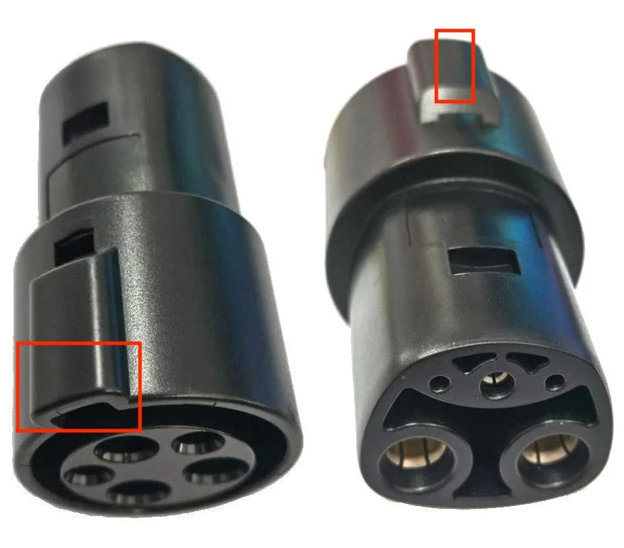

Isn't there a tesla adapter that just fits the top, or is that what you are saying will conflict with the plastic piece?
If you look closely at the collar of the J1772 side of the adapter in this screenshot, you will see it can't plug into the Ford CCS1 style plug because of the little lip. You could dremel this off, then it would probably work fine. But without doing that, it will prevent mating.
