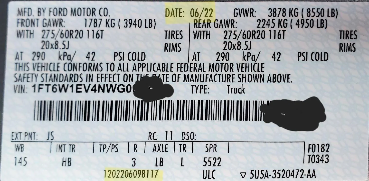

The most accurate way to determine the build date is on your door jamb sticker, there are two dates, at the top is a mm/yy date then at the bottom is a date yyyymmdd embedded in the string of digits, this was the planned build/blend day, but actual build day can vary by days if there were interruptions in production that week.
Example of my sticker, truck's intended build day was June 9th 2022, ie. 06/22 (June/2022)
My truck actually entered production on 06/17/2022 an the "BUILT" status date showed up on 06/30/2022

So with this information possibly you can confirm your truck might have qualified for the PTC replacement.
Build Status for my Red Brick Truck is August/2023, the number at the bottom of the sticker is 1202308227106. I think that puts it within the build timing mentioned in SRR 23-V688, but I haven't received any notification.
