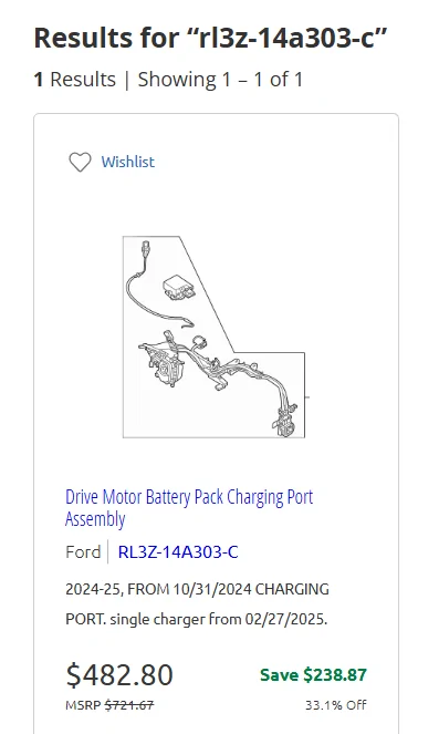

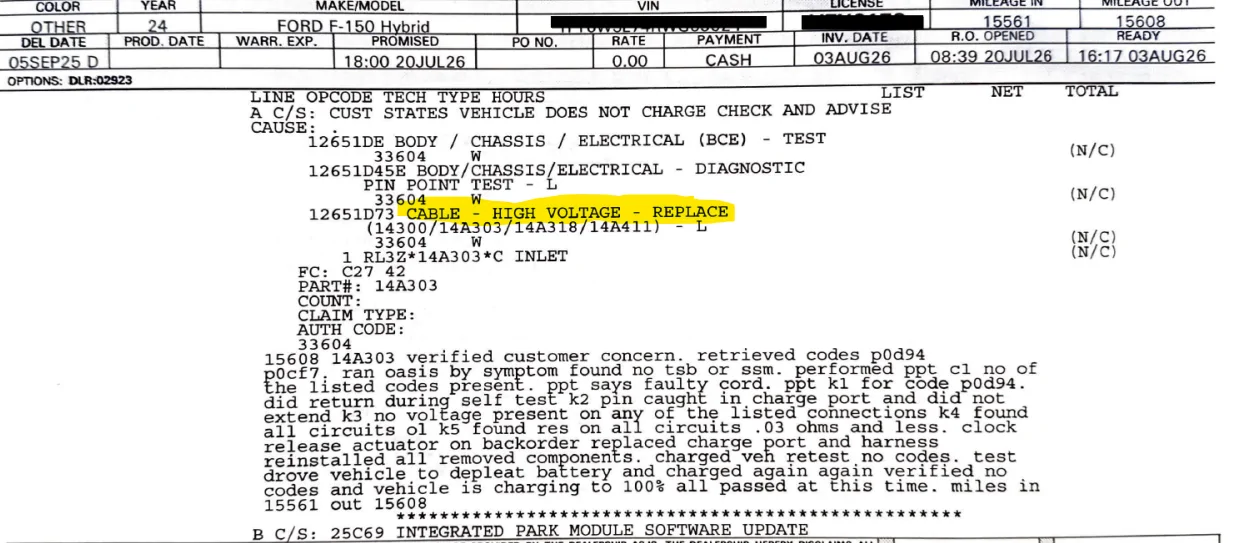

Update here. So I eventually took the truck in to a local dealer because I couldn't ever get it to DC fast charge again. They told me that they replaced the "charging harness". It was covered under warranty which is good. Attached is the invoice/service notes. Got the truck back and was able to successfully fast charge. Once at a Tesla Supercharger and once at an EVGo location.
Fast forward to today. Wanted to test it again and both (Tesla and EVGo) failed. The truck told me it was a Vehicle Charging Fault and that I should service the vehicle soon. It was over a 100 degrees and the battery temp gauge was showing slightly over the midpoint. Planning on taking the truck back in tomorrow morning to see if they can figure it out. If any of this makes sense to anyone and has advise, I would appreciate it. Love the truck and its worked great for me for about a year and half. But I need a vehicle that I can reliably take on road trips from time to time. Even if it is hot outside.

What's the part in those notes about the clock release actuator on backorder, what does that do?
I'm not sure. Whish they could explain it to me! I just dropped the truck off at the same dealership. Their "EV Expert" was there and we spoke for a bit. He did not leave me with the impression that he was an expert. He said that these EV's charge sometimes and sometimes they dont. And essentially said that these cars arent made for road trips. He also started looking at the notes and said that they replaced the high voltage battery. Which they did not. That would have been a much bigger ordeal of course. I live in Austin, TX which is one of the bigger cities in the country, and I see at least one other Lightning on the road every day. I just wish there was a local dealer that knew what they were talking about with these things.
