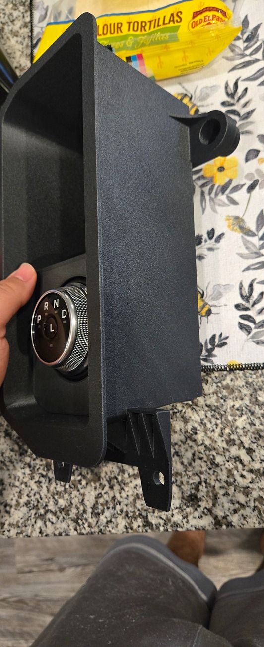

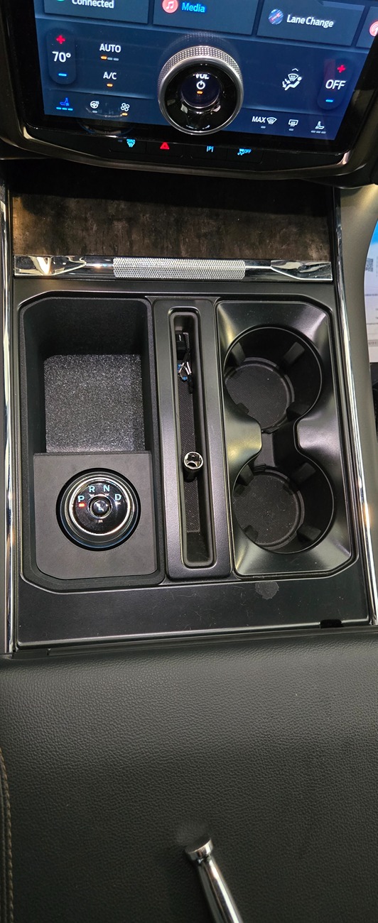

https://www.thingiverse.com/thing:6978586
I printed this one for my truck. I like the design since it gives you more space than the etsy version. I modified the print to not have the USB holes at the front. I wasn't a huge fan of cutting a brand new GSM up. But functionality and looks are amazing in my opinion. Plus it sounds like it lets you use more modules.

Yeah, the early (or maybe all/most) 3D print version cubbys, you need to cut off the three winged bolt holders from the rotary shifter assembly...then it just plops in the cutout area fot it, then just place the lid on top.
I think you may have to shave a bit into the asembly as I got as close as I could and its pretty tight to place into the cubby...but its definitely not going anywhere.
I think you may have to shave a bit into the asembly as I got as close as I could and its pretty tight to place into the bubby...but its definitely not going anywhere.
I cut mine off with a hacksaw and then flushed it with a file. It was still a tight fit, but I think that was intended with the design.
