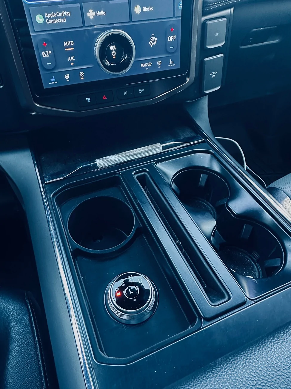

I just installed a LX6Z-7P155-U and it is not motorized

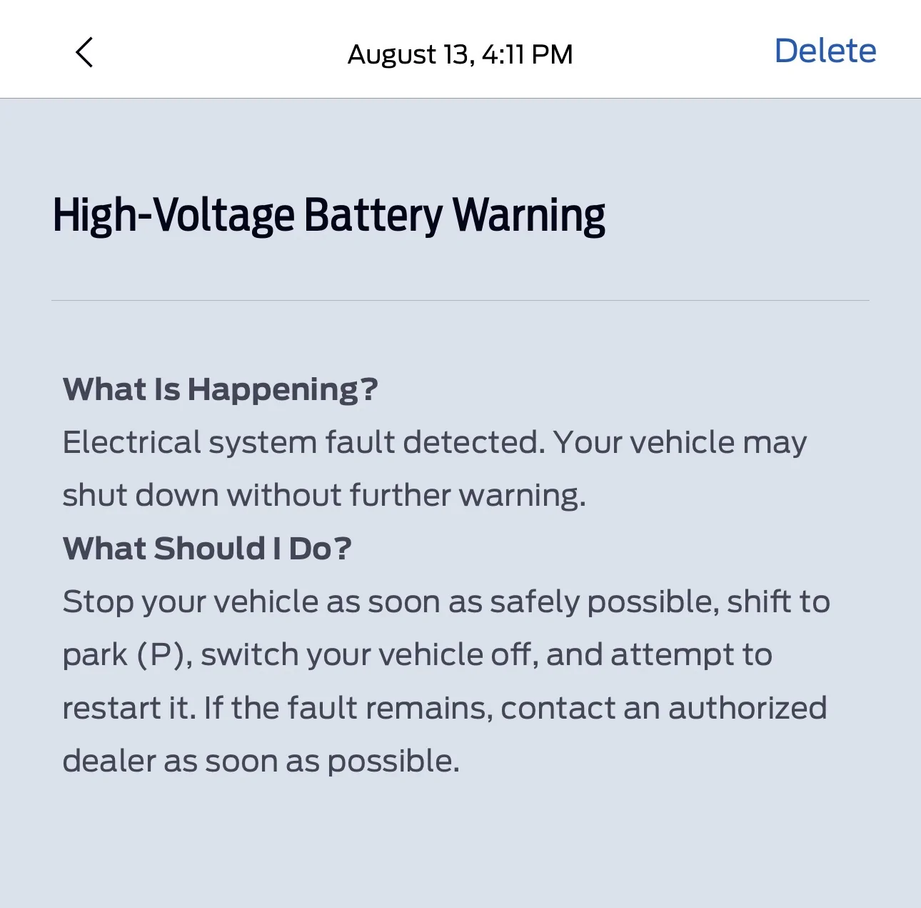

that’s a bummer! I just installed the same one this afternoon and confirming mine is motorized. Maybe the wrong model was shipped?
I did however get an electrical fault upon install. Luckily a battery reset was able to clear the fault.

This is the error that popped up. Gave me a quick scare but everything seems to be operating normal. I was swapping the shifter while the truck was on so my fault there.
