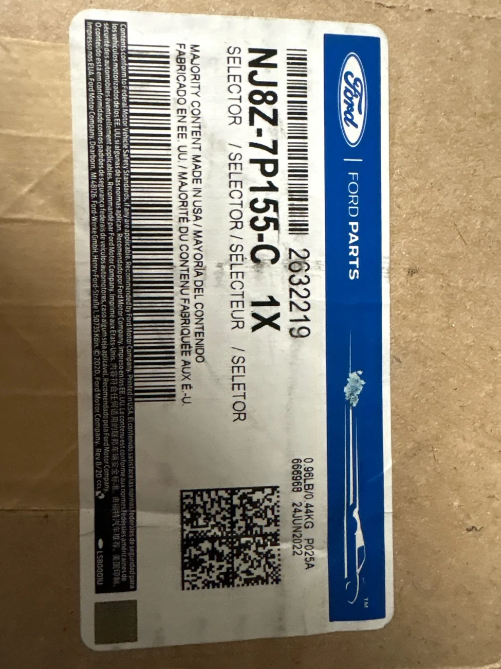

Curious I don’t see this one on the list this is for the 22-24 Mach e ? I have this one new and am holding into it as I don’t wanna swap mine till outside the 3yr/36
I haven't seen that part number yet. My guess is that it is a non motorized version based on the trend.
It is new from ford the dial does not freely spin I didn’t try to move it much but my wife’s 24 Mach e select the dial spins freely.

It will be locked in park until it is installed regardless if it is motorized or not. Also, this came up when I did a google search on that part. https://www.macheforum.com/site/thr...pressed-transmission-remains-in-park-p.21849/
Bummed to see the gsm I used is part of a tsb issued three years ago. I bought mine from a Ford dealer and not online in March of 25. I would think Ford could be a little more proactive in getting suspect parts out of their inventories.
Mine is the LJ9Z-7P155-D.
If I may make a suggestion, copy the part numbers referenced in tsb-22-2343 and mark them on your list as having a tsb associated with them.
