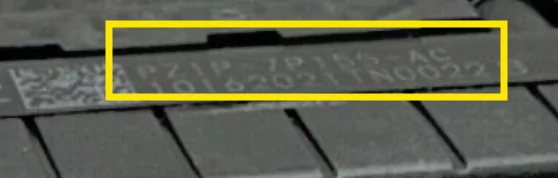

I bought this on eBay. Description says "New OEM Ford Escape 2020-2022 Automatic Transmission Shift Lever LX6Z-7P155-U". But the picture in the listing shows PZIP-7P155-AC.
Ford F-150 Lightning Rotary Shifter Part Numbers 1755286424322-k

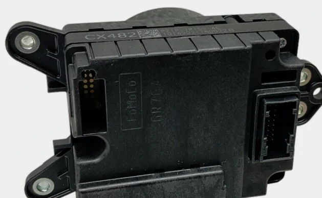

Actual part on arrival was indeed PZIP-7P155-AC. And it is stamped with FoMoCo. I would be wary of the clones. You can see the difference in the photos:
Real:
Ford F-150 Lightning Rotary Shifter Part Numbers 1755285487279-

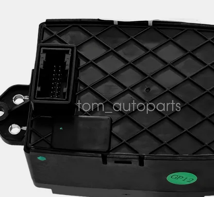

China clone: Note lack of part number and FoMoCo. Also diamond pattern on the bottom instead of smooth.
Ford F-150 Lightning Rotary Shifter Part Numbers 1755285376350-id

Same seller and listing i bought from. Its not motorized. They have the PZ1P listed as both part numbers.

Be careful that the part #s stamped on body are sub-parts of the full assembly. The top level part # might not be shown or stamped. The manufacturer I work for does this all the time.

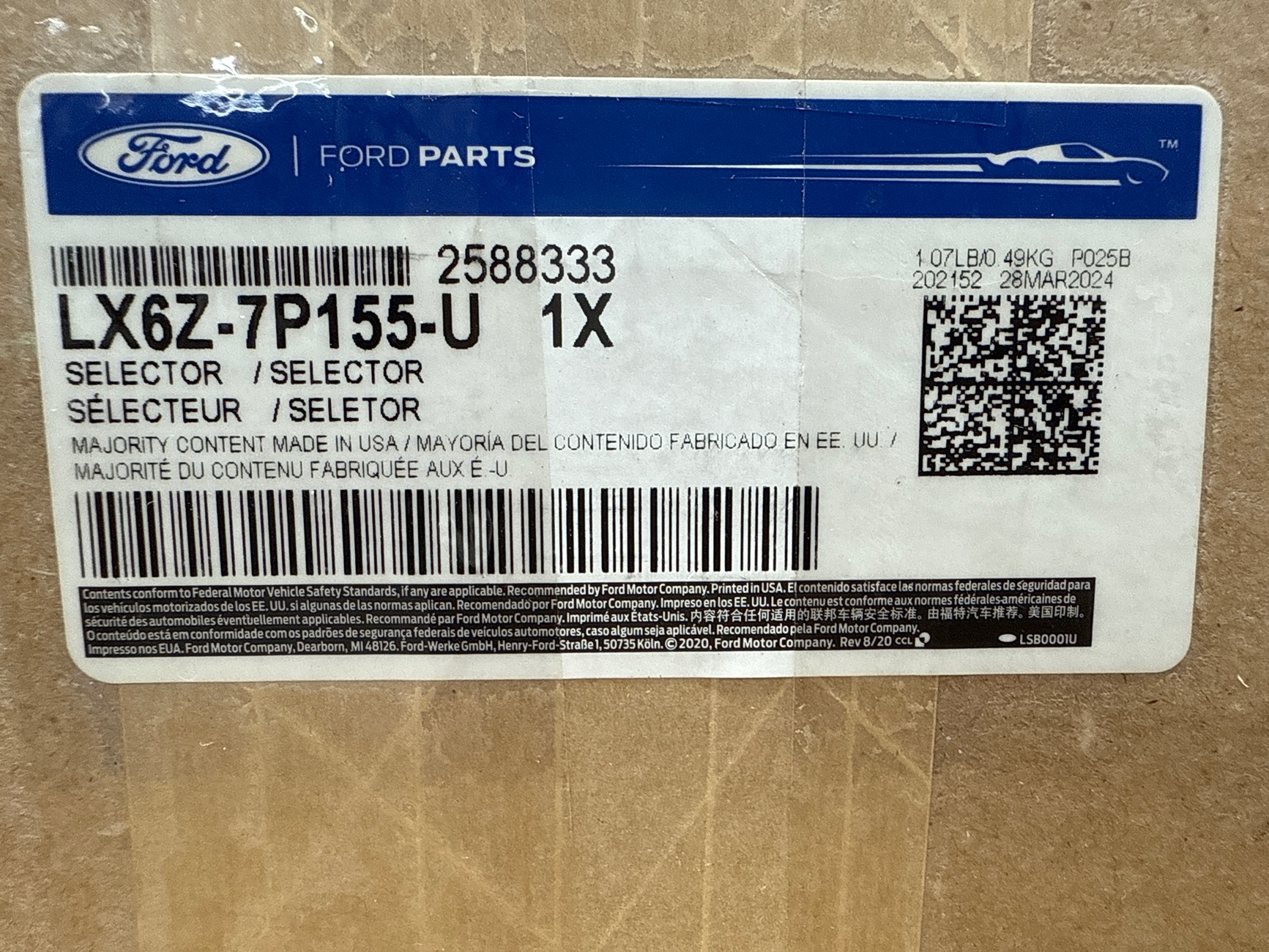

Interesting, that is the first one that breaks the pattern that was building. Also disappointing since I was looking forward to it. Did you buy it new?
Interestingly, my -U is motorized. I finally got around to installing it this morning. Power off the vehicle and it goes (quietly) with a motorized action into P.

What's the part number? Are you sure its OEM? As mentioned earlier, the non OEM seems to be motorized.

Interesting. So far the other 2 OEM models matching that part number are non motorized.
Note that it will shift into park regardless if its motorized or not. The difference is that the outer ring will physically move. You also won't be able to rotate it passed "D".
I will double check whether the ring itself moves...

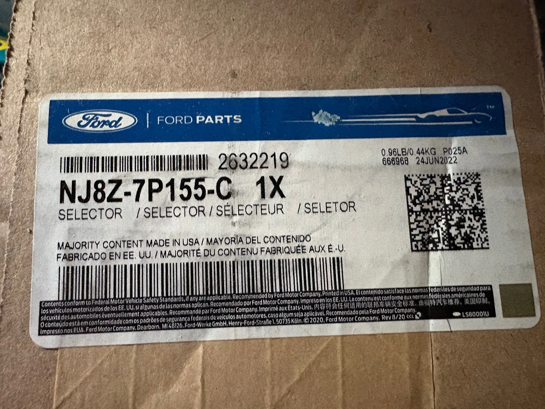

Ford F-150 Lightning Rotary Shifter Part Numbers IMG_9137
Haven’t installed yet but this is a number I haven’t seen listed here this is a new Ford OEM part for 21-24 Mach E I ordered directly from the dealer.

And the ring does move...
I ordered another LX6Z variant, it happened to be listed on ebay when I went looking. This one is brand new in Box: LX6Z-7P155-A. Hopefully it will confirm the LX6Z variants are actually motorized.
