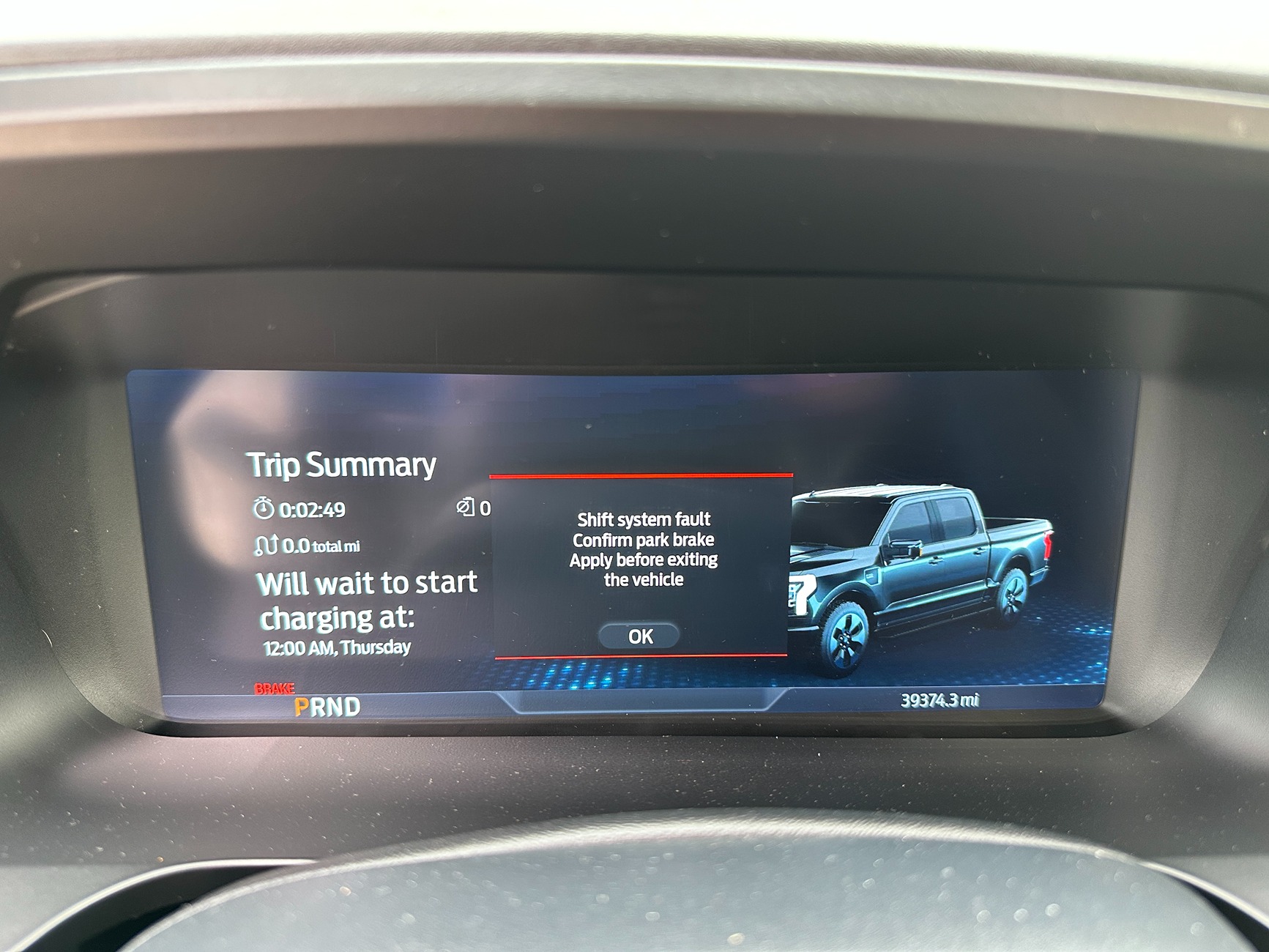

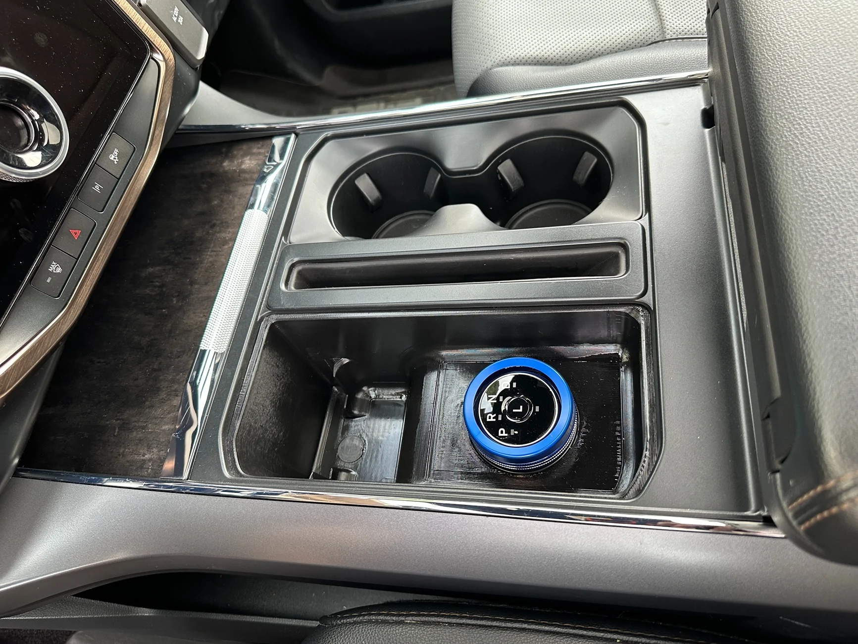

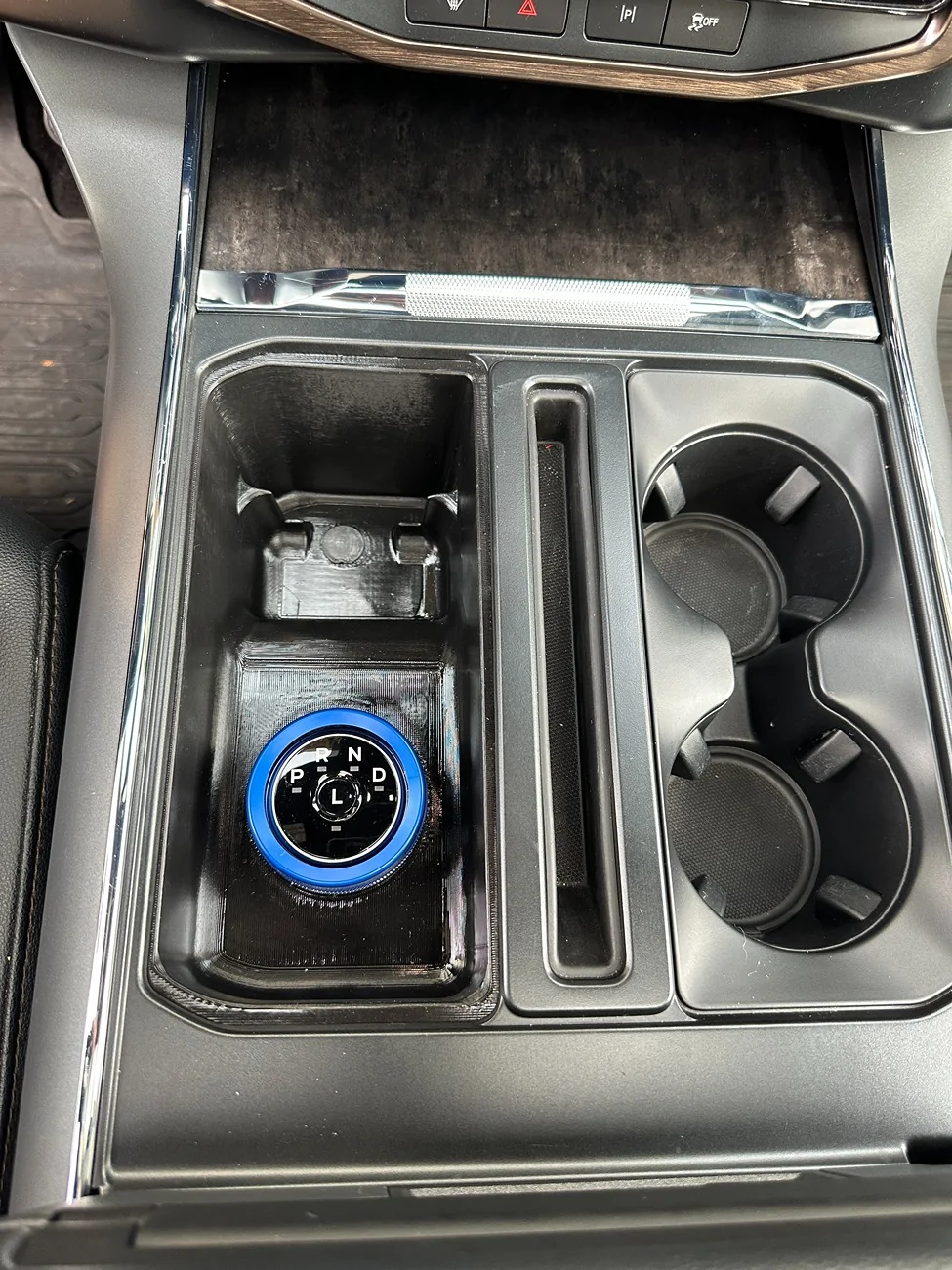

Hey all. The original stick shifter has been throwing error codes for months, even once stranded me by sticking in D and not returning to P for hours (then spontaneously moved itself back for no reason).
I just installed the ManionMakes shifter box with an eBay rotary shifter (part OEM JX6P-7P155), quick and easy job. Everything seems to function perfectly (it even rotates itself back to P when I open the driver's door while in D, not electronically, actually moves the dial with a motor). However, when I shut the truck down, it now throws an error on the dash:
Shift system fault
Confirm park brake
Apply park brake before exiting the vehicle
Any ideas about how to fix this?

You would need to pull codes with forscan or FDRS to see what is throwing the fault.

I ran Forscan. No DTCs related to GSM (like there were with the stick). I ran all the tests related to the GSM section- nothing out of spec. No errors related to parking brake that I could find. Where in Forscan would I hunt down the source of that dash warning?

Did you have any other DTCs stored? I'd almost think the IPC would have something based on the message. Depending on where the GSM is at on the CAN network, it may not even be a DTC related to the GSM specifically.
If not, I can't think of a better way to test other than swap the shifter with one of the part numbers that are known to not have any issues. I dont think I've seen that part number yet, so my immediate guess would be an incompatible shifter. Maybe someone else can chime in if they've used it before.

I suspect it is the dial. We have reports of similar issues with the dials for the Mach-e as well.

I just figured that any OEM Ford rotary shifter with the same dimensions and 7P155 in the part number would work. And for the most part, this particular version (JX6P7P155) does function perfectly. According to the interwebs, this part fits "Focus MK4 (2018–2023), Escape (2019+), and Fusion/Mondeo with an electric shifter.
In fact, the wrench light on the dash, which was on pretty much all the time with the Stick in there, is now off, so that's a win. And the Warning that flashes only after I shut the truck off does not throw a DTC or the wrench light. I will try to dig deeper in Forscan to see what exactly the code might be, but for the time being I'm happy with the result. If I can't figure it out, then a new rotary shifter must be the answer.
Thanks to everyone who has weighed in. If you have more ideas, I'm all ears.

It sounds like some of them have different internals or configurations if there have been other reports.
I will likely have one of mine for sale next week since the second one I am trying is non returnable, if you do decide to swap it out.

OK, ran Forscan GSM diagnostic tests on this rotary shifter (JX6P7P155), which returned the following error codes:
Code: P166B - Drivers Door Status Correlation
Code: P07EC - Transmission Range Multi-Function Select Circuit
I am not getting any errors related to door status, though I don't know if that might be contributing. The P07EC must be the problem, and I suspect it is hardwired into this particular shifter, probably no way to prevent the Dash Warning with this shifter. Any other ideas? Has anyone run these tests on other rotary shifters, curious to see if well-behaved rotary shifter are throwing diagnostic errors.

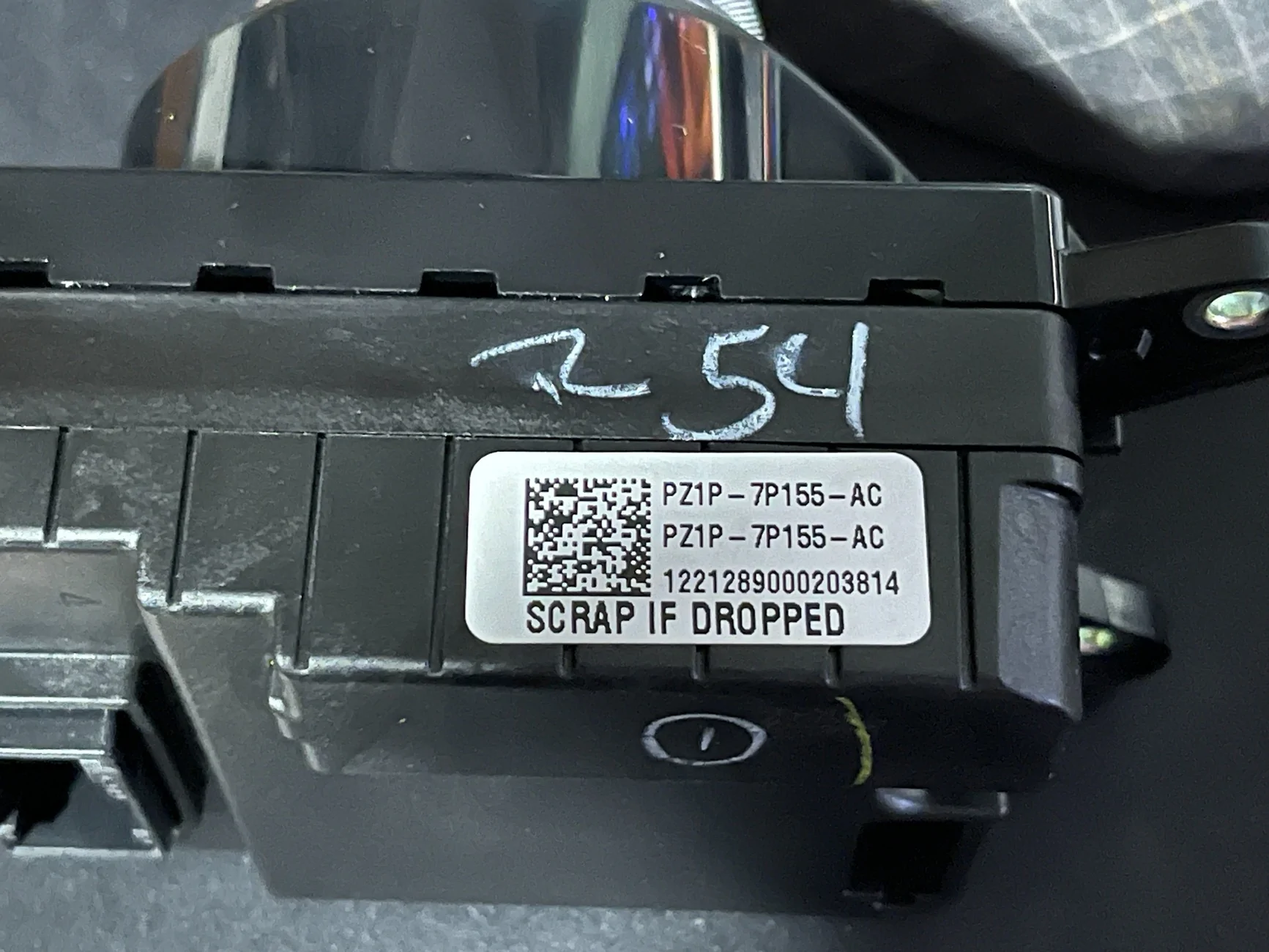

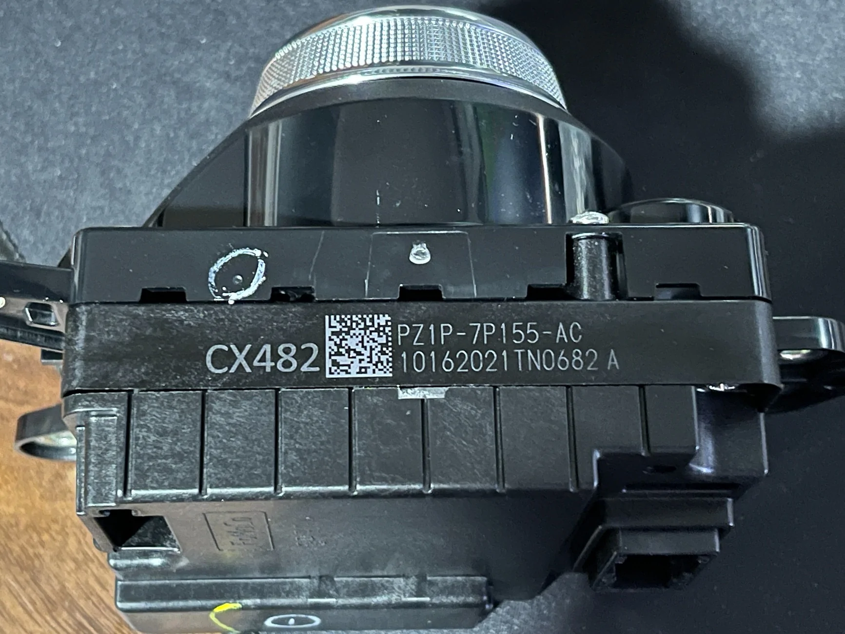

I've tested with fdrs with no errors. I did so recently due to unrelated CAN errors.
PZ1P-7P155-AC is the one currently in the truck that was tested with FDRS.
