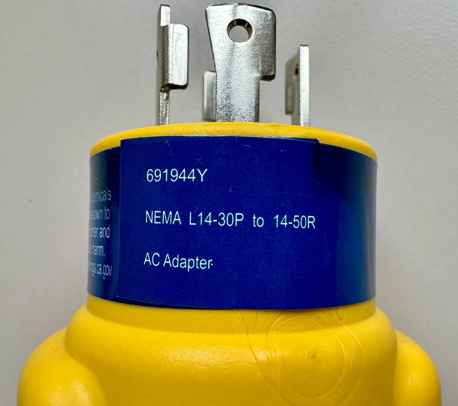

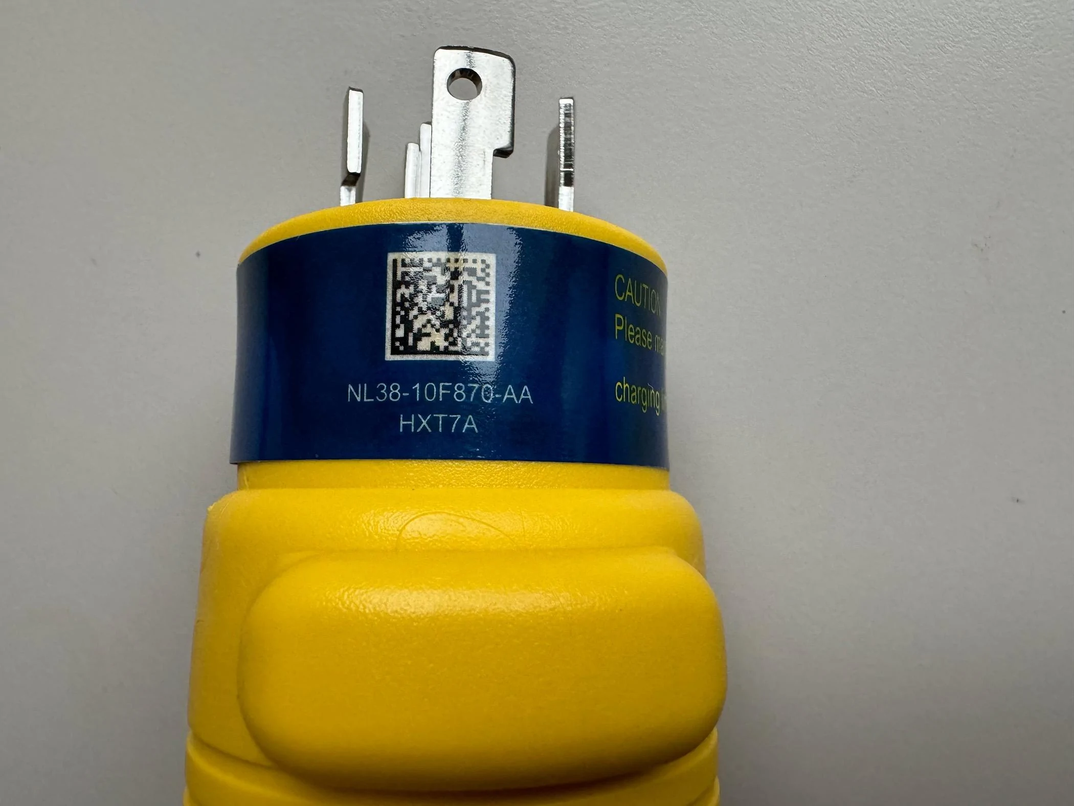

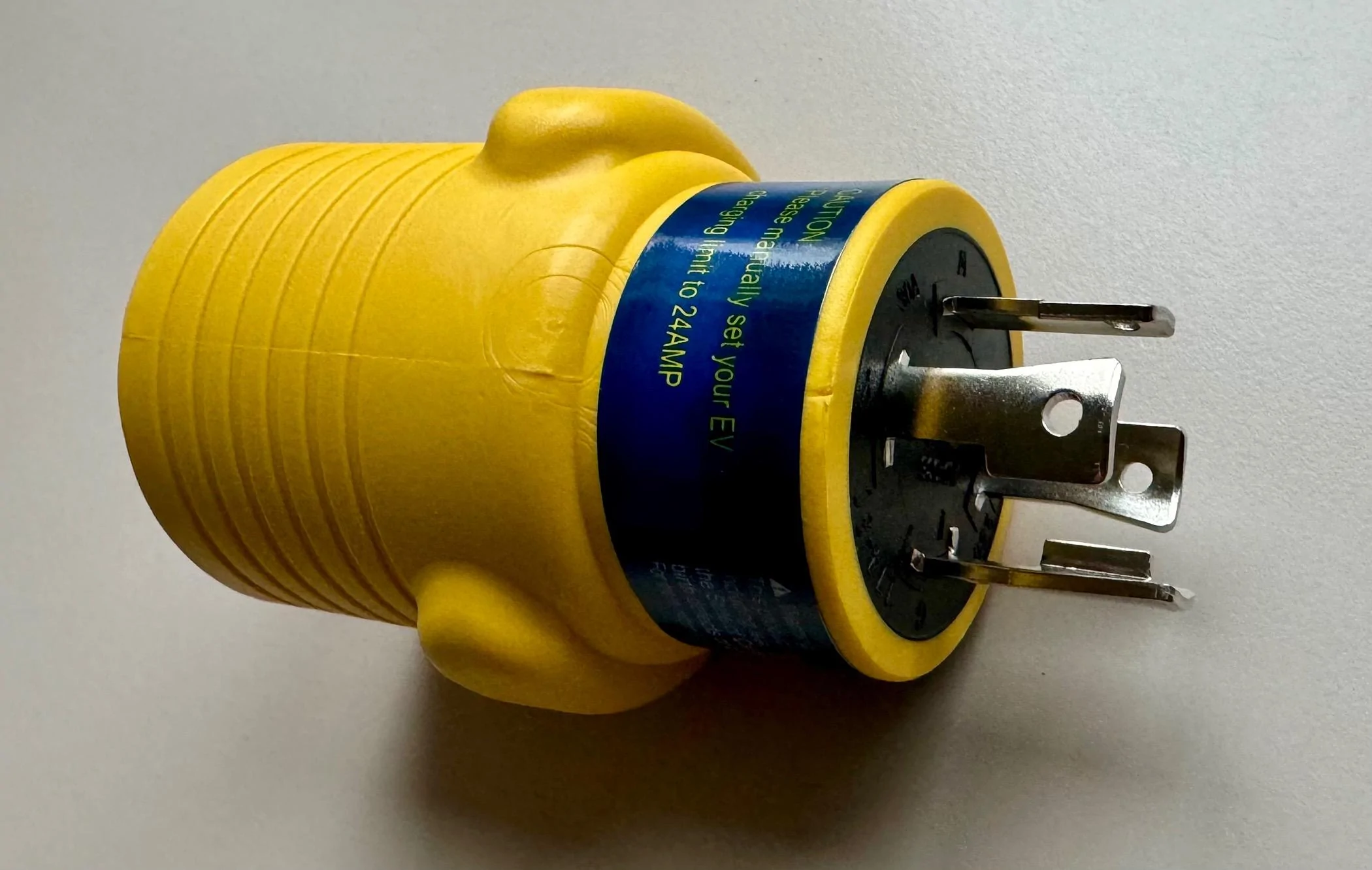

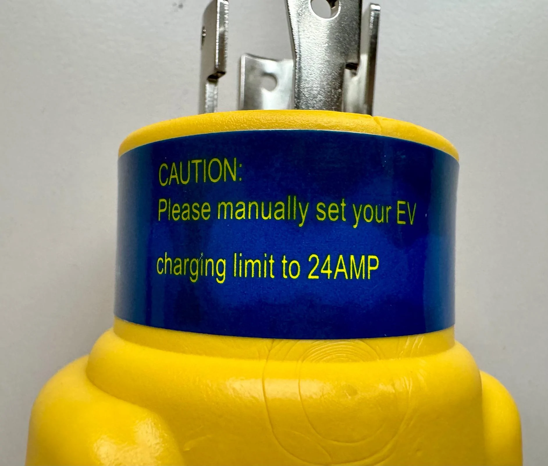

My 2023 Lariat also came with an adapter. It has a Ford part number on it. But as others have stated there are other styles of adapters that will work.
On the label it states to set EV charging limit to 24 amps (output) when using adapter.
